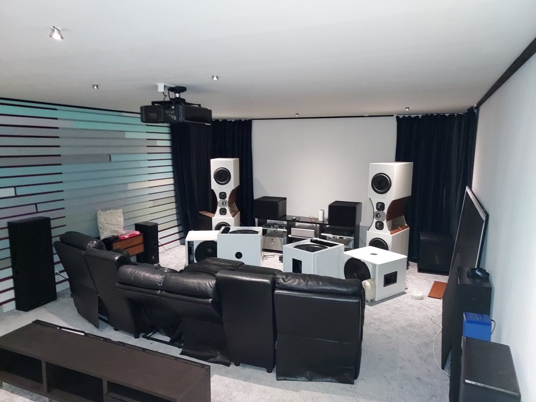

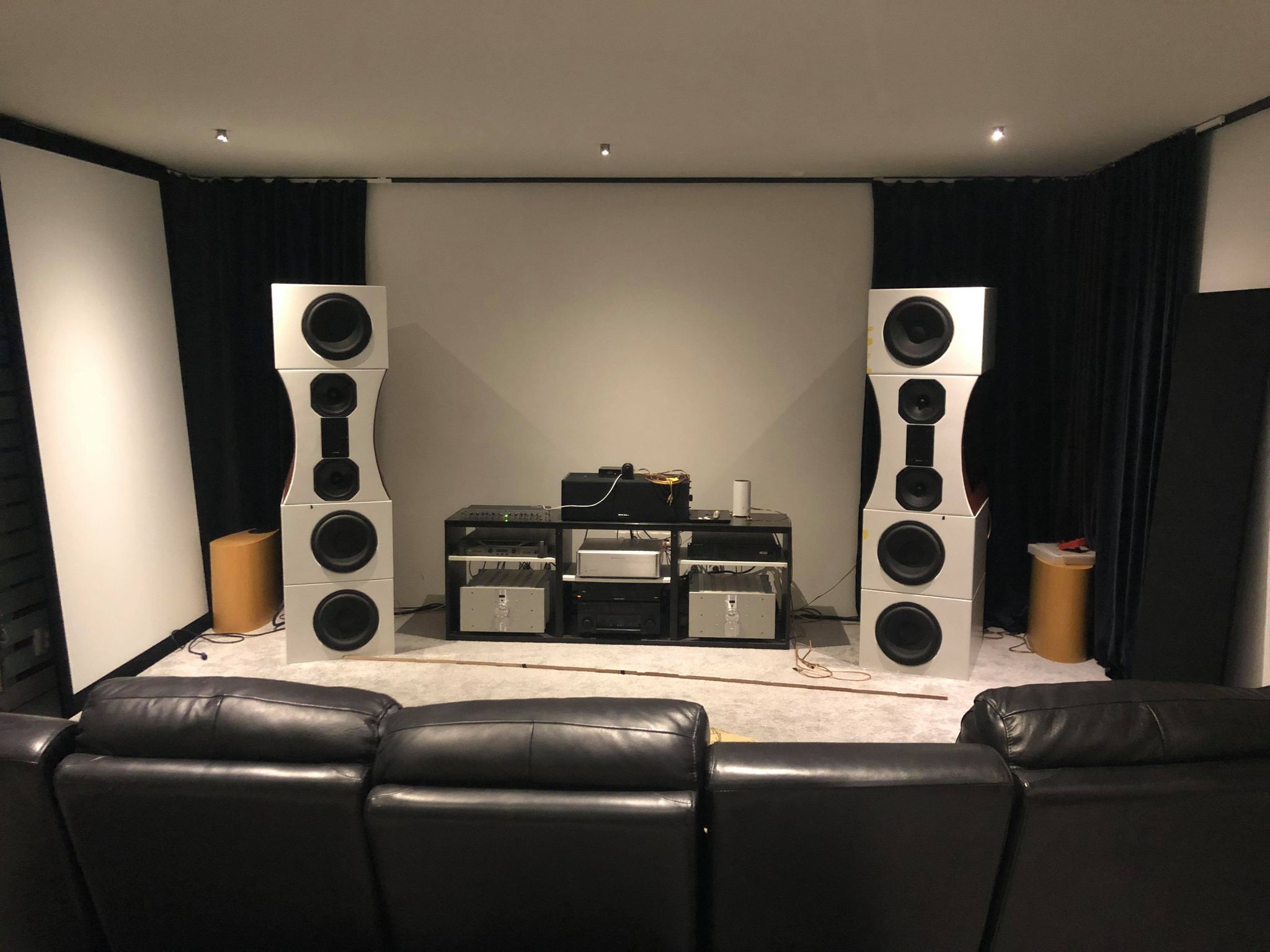

I bet that set up sounds great.I tried my subs in several positions of the room and behind the chair gave, by far, the best bass quality. It is incorrect to block the back of your head with subs, furniture or even the back of your chair, in doing so, you compromise soundstage, even more when the room is treated and has diffusers installed in the back wall (as I did).
You do not needed for the near field bass to stay within a foot, one driver diameter will give good results. And IMO you still need to treat your room with bass traps. I have installed a total of 30m3 of those plus several Mondo Traps plus 7m2 of diaphragmatic bass traps.
Since you will listen to the monopole radiation of the subs you do not need to enclose the back wave of your drivers, leaving them dipole. I very much prefer the sound of open back subs and by a big margin, this is only a personal preference.
As I already shown in other thread, these are 4 x 24" SH24 subs, H-Frame, flat to 20Hz. Delayed 5.3mS to the mains w/DSP. This is a room for music only, zero interest in HT.
Actually it depends on room, and driver+baffle. I also wonder if we are talking about the direct field.... there is a point where I lean towards the speaker it appears that direct energy all of a sudden takes the lead and bass becomes much more full, in terms of FR quality and spl jumps up, so thus efficiency. Now that my baffle space is less, that transition point moved a little closer to the speaker but not by much and it happens at about 30"-25".... after you are within this part of the sound field, getting closer does not change things much... I am thinking this is the direct fieldBut you really would need to be CLOSE to the woofer. 1m is for sure to much, 30cm/1ft should work. I definitely don't want something around my head which reflects sound - so they would need to be in the backrest of the couch.
But hey - why not?! Will need to try that.
I feel like I designed my system the best I could to extend this direct field out as far as possible, from the loudspeaker by using the largest driver/horn/baffle I found feasible.
path loss in everything that I know about, sound, RF, light.
Mark a point 12" from your loudspeaker and one that is 100" away. Then measure the reflective path from a wall and back to 12" point, and same for the 100"
The further the listening distance, the less difference of reflective path length. Up close, the path length of wall reflections have a higher difference to the direct path....
Theres is nothing else here to ponder, unless my math is off 🤞 lol it is the reason why I've built a very large 2way that is omnidirectional at Xo point, so I can it as close as I want to the tweeter without loosing the woofer.

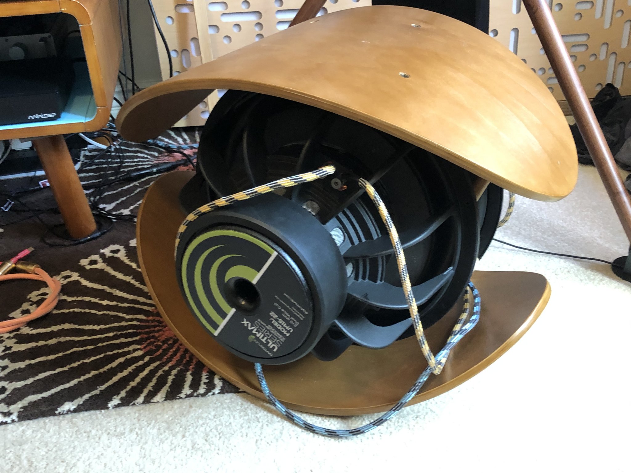

So on my last setup, very similar to current one, I had 4 woofers in nude clamshell/pushpull, laying on the floor.
They were bolt together so very easy to move around, and it would get better and better closer to me.
Also their orientation had an impact, with room and furniture interactions.
The good thing is that it brought back some of the chest thump that dipole are lacking.
And I enjoyed the look of it, so exotic.
![IMG_0602.JPG IMG_0602.JPG](https://www.diyaudio.com/community/data/attachments/1048/1048432-e818e82d692db7f30977b28e31aa1ea8.jpg)
But it was of course harder and harder to integrate with mains since playing up to maybe 150/200Hz, and just not practical with people around.
So I ended up with closed subs.
