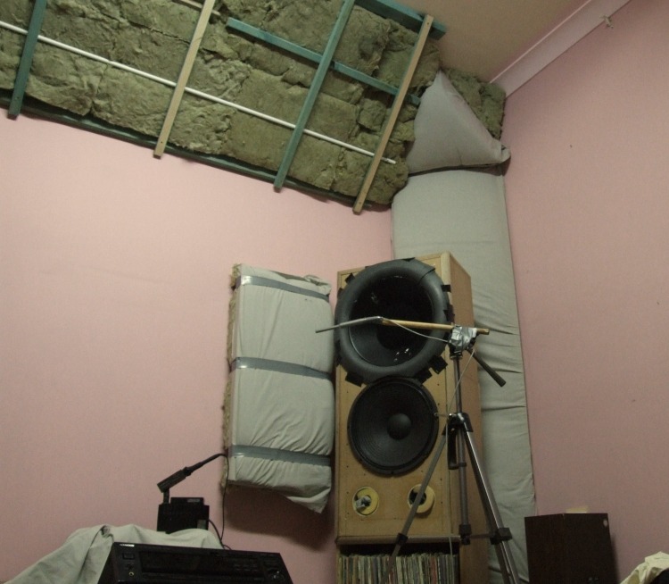

well, thats some interesting looking trapsI went down that road some time ago. It made a positive difference but I'm inclined to say multi-subs has the potential to overcome the modal variations more completely... Now, maybe that's the point of the excercise or maybe it's something else, but I like the result.
i bet the wife loves it !
maybe im seeing not clearly, but the ceiling bass traps looks about 8" thick. your corner traps are also not thick enough.
I feel real bass traps need at least a good 15 inch thickness min to begin really helping down to about 50hz.
and you need to cover as many corners as you can, not just the corners floor to ceiling, but also the ceiling to ceiling corners, and floor to floor corners
I bought around 10 bags of rockwool batts. The ceiling absorbers were out 24" - 34" from the edge, depending on the angle of the mode. But this isn't the point.
I'm not disagreeing with you that with enough of them, you can make the walls disappear. I'm thinking I'd have needed to double them and double them again, to begin to achieve what I know is possible.
I think todays question is whether there is a problem with multi-subs. It does take some time to learn to get results from them.. and the upshot is I no longer use absorption specifically for basstrapping.

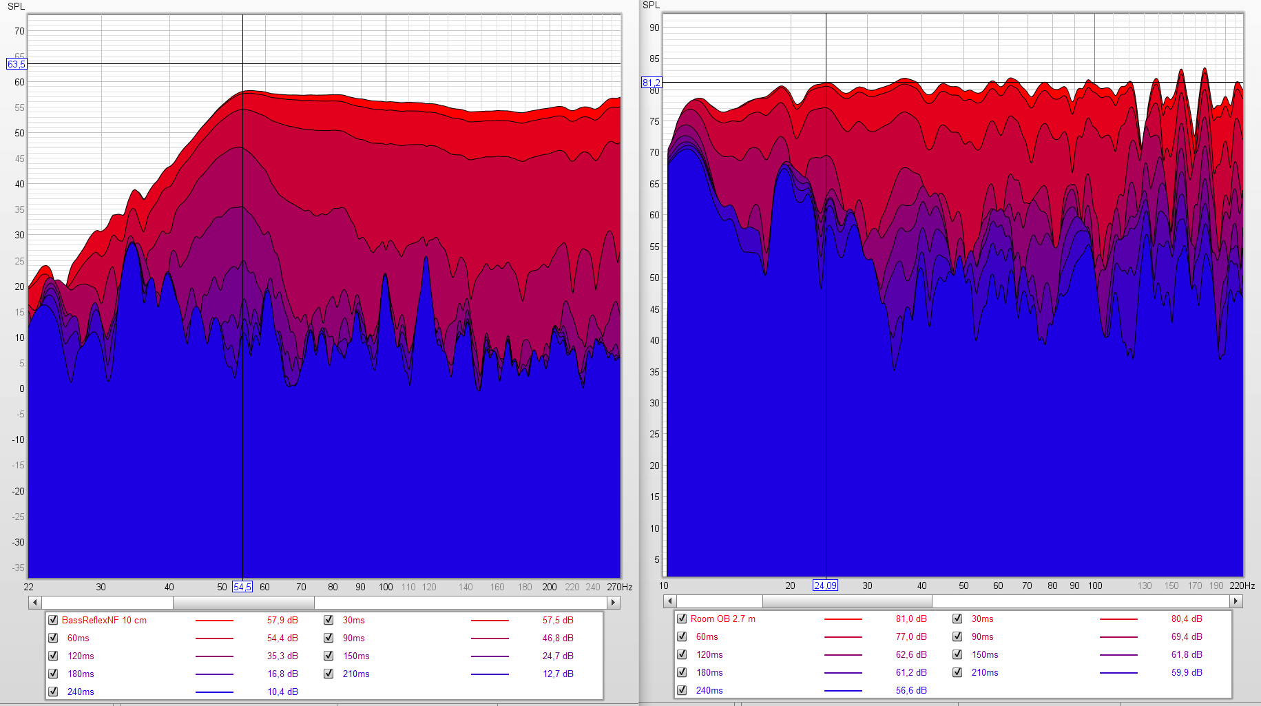

Lets compare real measurements.Pretty sure.
Left is bassreflex speaker measured from 10 cm fom middle point between speaker and tube opening, box is tuned to 55 Hz.
Right is in room measurements, speaker is multi bass (2 pc.) OB, DSP corrected, room is not acoustically treated, mic is 2.7 m from speakers.
Absolute SPL levels are not same but decay time can be compared.
I not see magnitude less stored energy in bass reflex.
![BassRvsRoomOB3.PNG BassRvsRoomOB3.PNG](https://www.diyaudio.com/community/data/attachments/1022/1022525-fe3885b9e5b208a97f61636d3e60b627.jpg)

Do you listen to your speakers 10cm away from the port openings?

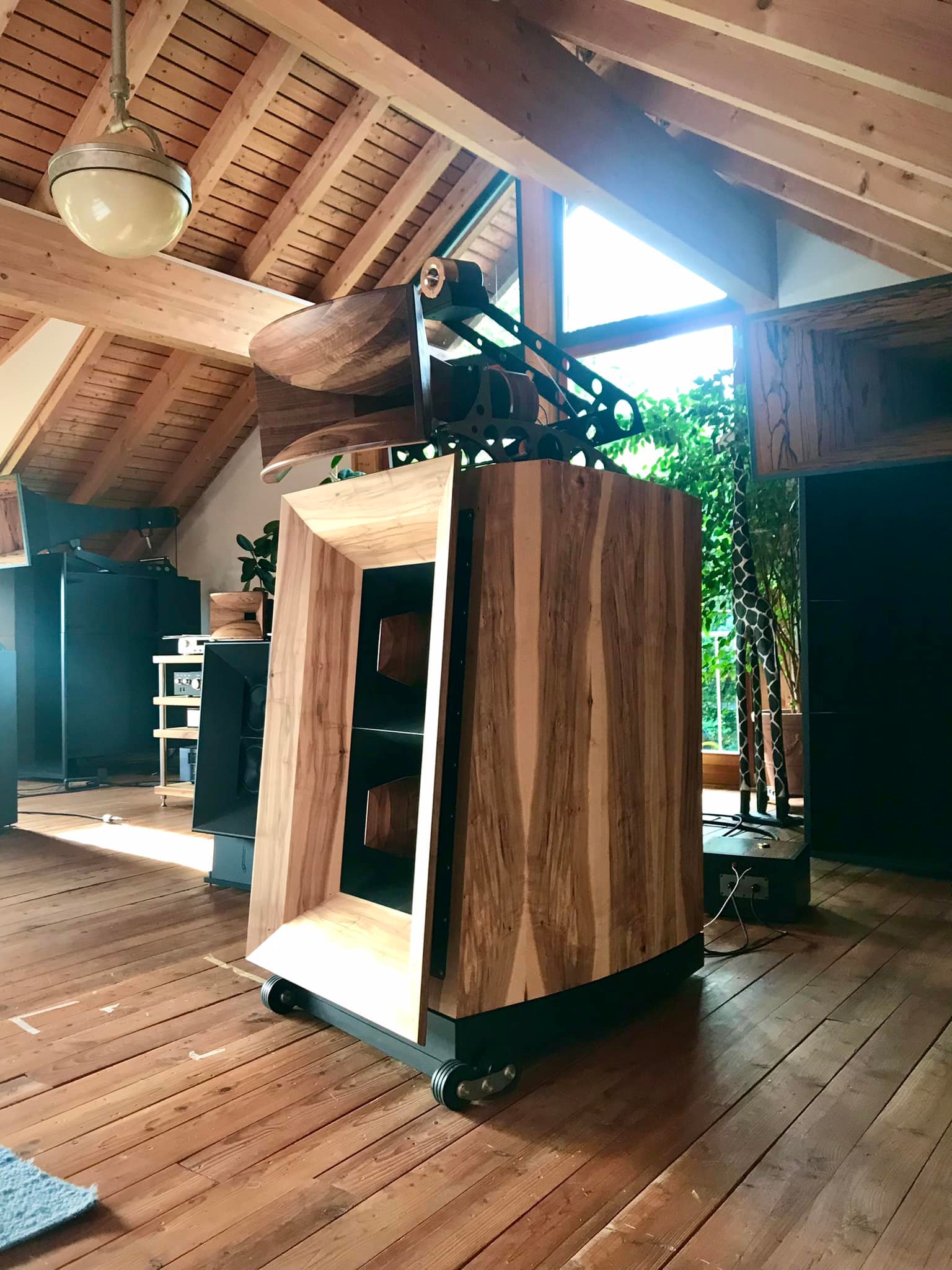

I attended an audio show last Sunday and once again the mantra "go big or go home" was confirmed (for me at least).
The first room I entered had the Blumenhofer Gran Gioia 2×16 Turbo playing. Everything I heard after that sounded like a toy. Bass was amazing. Tight, clear, clean, unstrained, whatever you want to call it.
Big doesn't automatically mean good though. I also heard the Focal Grande Utopia EM EVO, and that sounded like a giant booooom box
Focal grande, innefficient joke.I attended an audio show last Sunday and once again the mantra "go big or go home" was confirmed (for me at least).
BIG 2 way with horns. probably 100db efficient. sign me up!

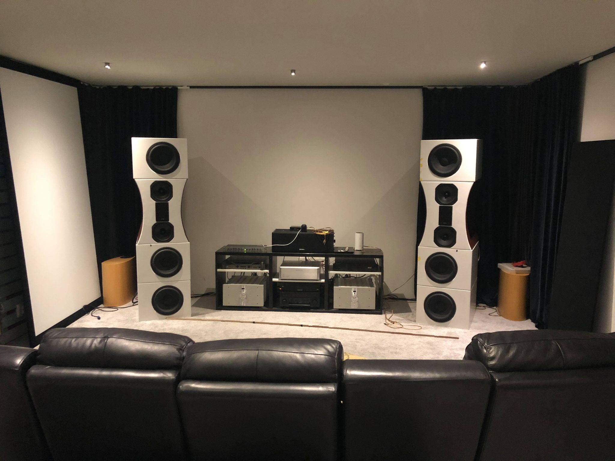

The best bass ever listening to, come from my own diy 6 X 12 inch Peerlees 830847 tuned to 22 hz in ported netto 102 liters working up to 340 hz active filter.
My room is 5 x 10 meters but fills every inch of it, and also plays 120 db 20 hz with headroom.

My room is in the basement is concrete floor/roof with thick stonewalls and acoustically regulated, and if i close my door the room is also airtight.
And always hard to tell about how something sounds, but i never heard a more correct dry brutal bass (noting exept the cones move in the room)
And its almost "invisseble" on many recordings, but hit you with great dynamics when it supouse to and all is feeling "so alive".
Was many hours work until my final result, and its hard to get 20 hz and also high SPL (120dB+)
When you don't want too big boxes and at the same time want a very musical integrated bass.
My belive with my good integrated bass in my system is that i use it up to 340 hz, and i think its much harder to integrate a "normal" 60/80/100 hz sub
More on that system here: http://cowanaudio.com/finale.html

Your measurement makes my point. Change the level scale to linear if you don’t believe me.Lets compare real measurements.
