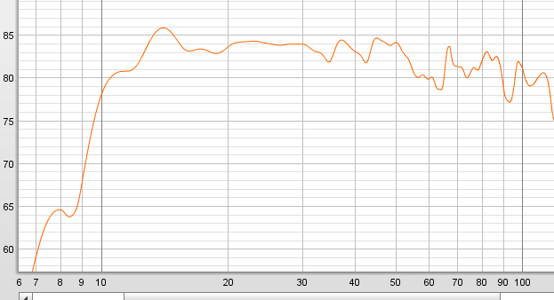

This is such minimal room modes created by monopoles in room, about 13' from speakers:

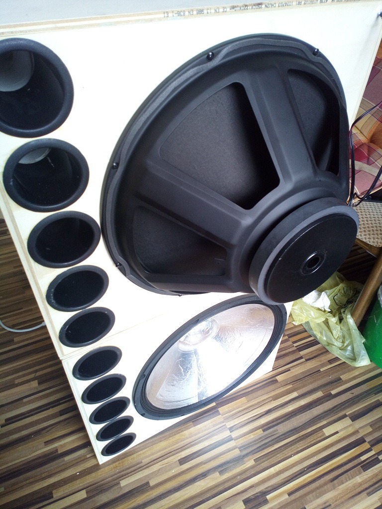

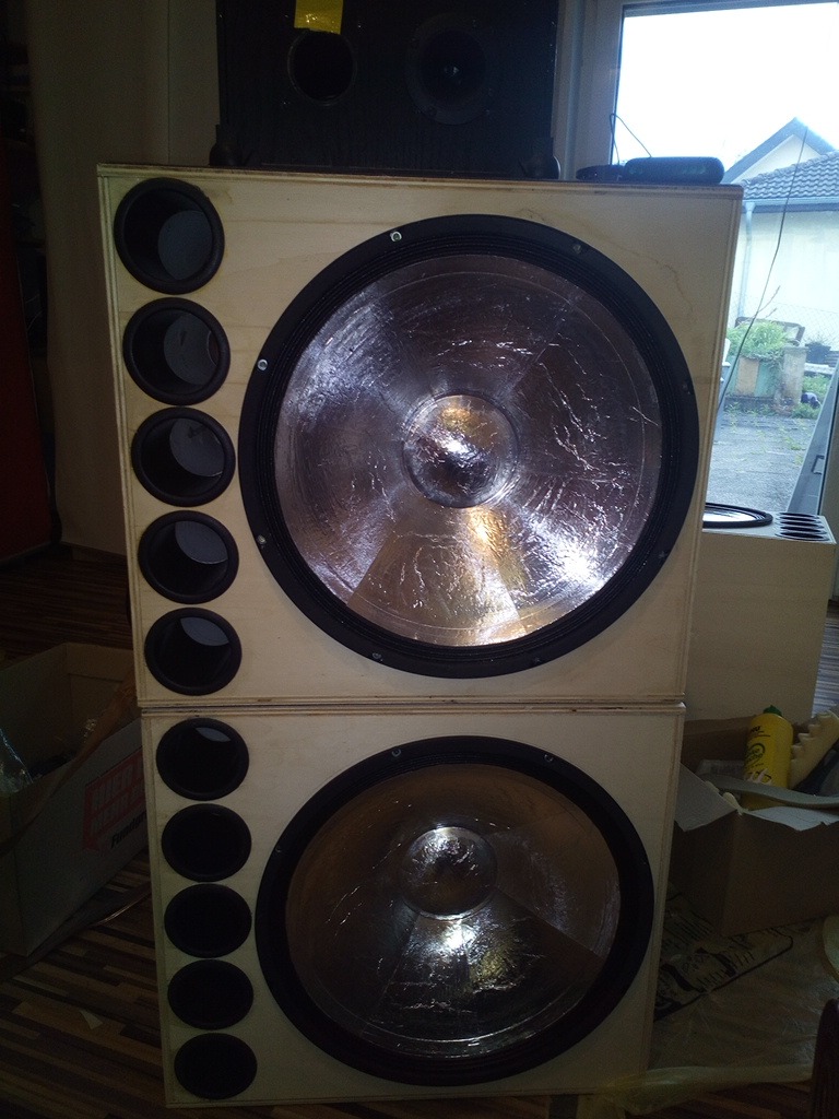

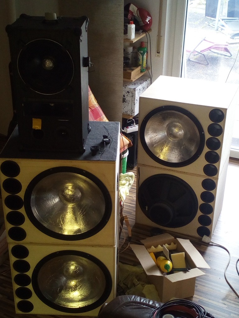

In my eyes you get the best bass (independently of room acoustics) with big bass drivers.
You can use even cheap 18 inch bass drivers - they just have to be implemented correctly.
I got each of these 18inch drivers for only 40 Euro each as from a remainder selling. However new the were in the 100 Euro price range.
Appropriate installation and building and you get true high end loudspeakers capable of reproducing ANY loudness:
https://www.diyaudio.com/community/...ow-off-my-new-18in-build.365764/#post-6711139
