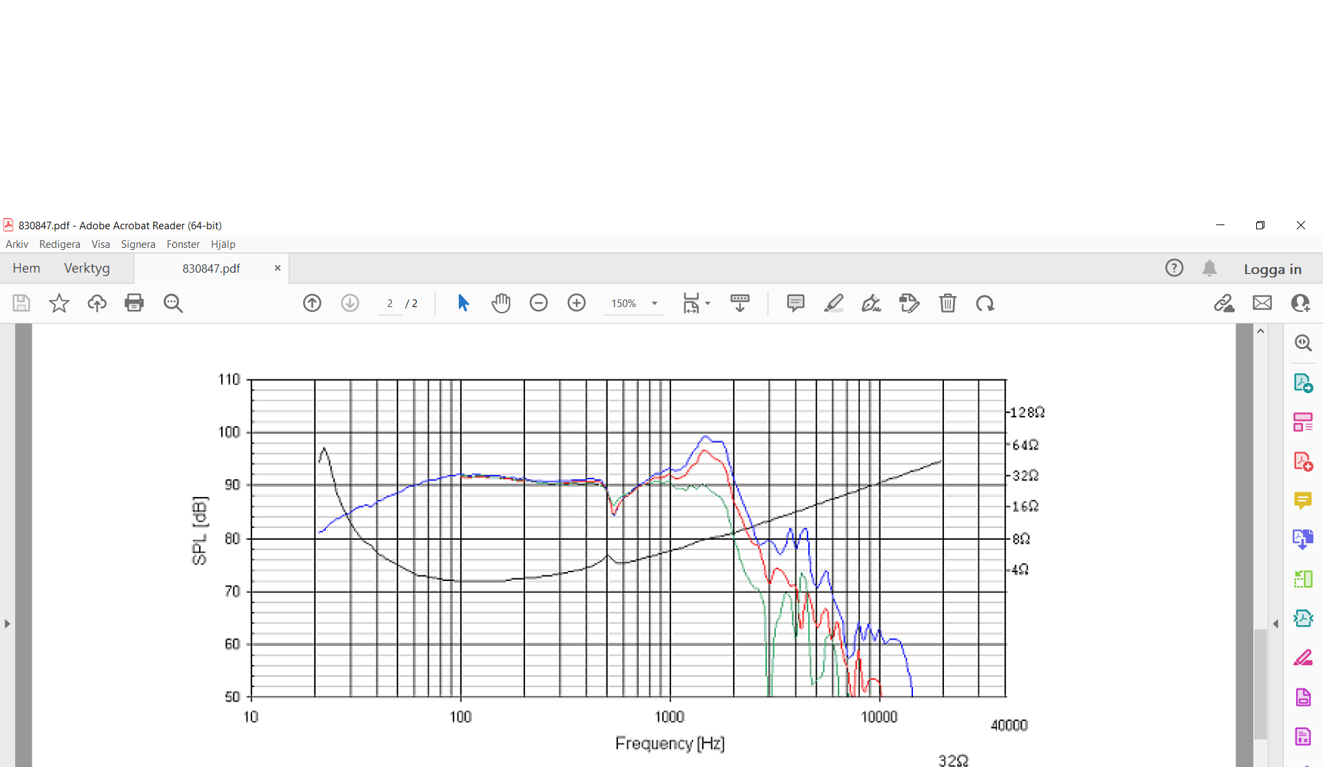

As Audiofrenzy says, i have to adding enough woofers to meet my high listening SPL levels.
And that´s why i end up with 6 of the Peerlees xxls 830847, 12 inch 12,5 xmax woofers ported, 4 of them was not enough in my room.
