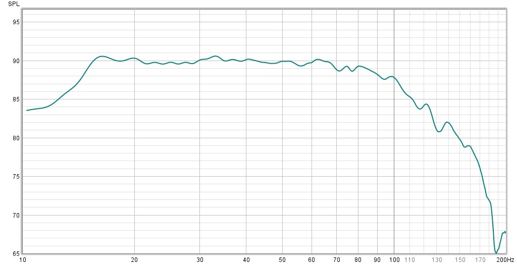

The best bass I've ever heard measures like this in the main listening position (with low-pass filter @ 150 Hz).

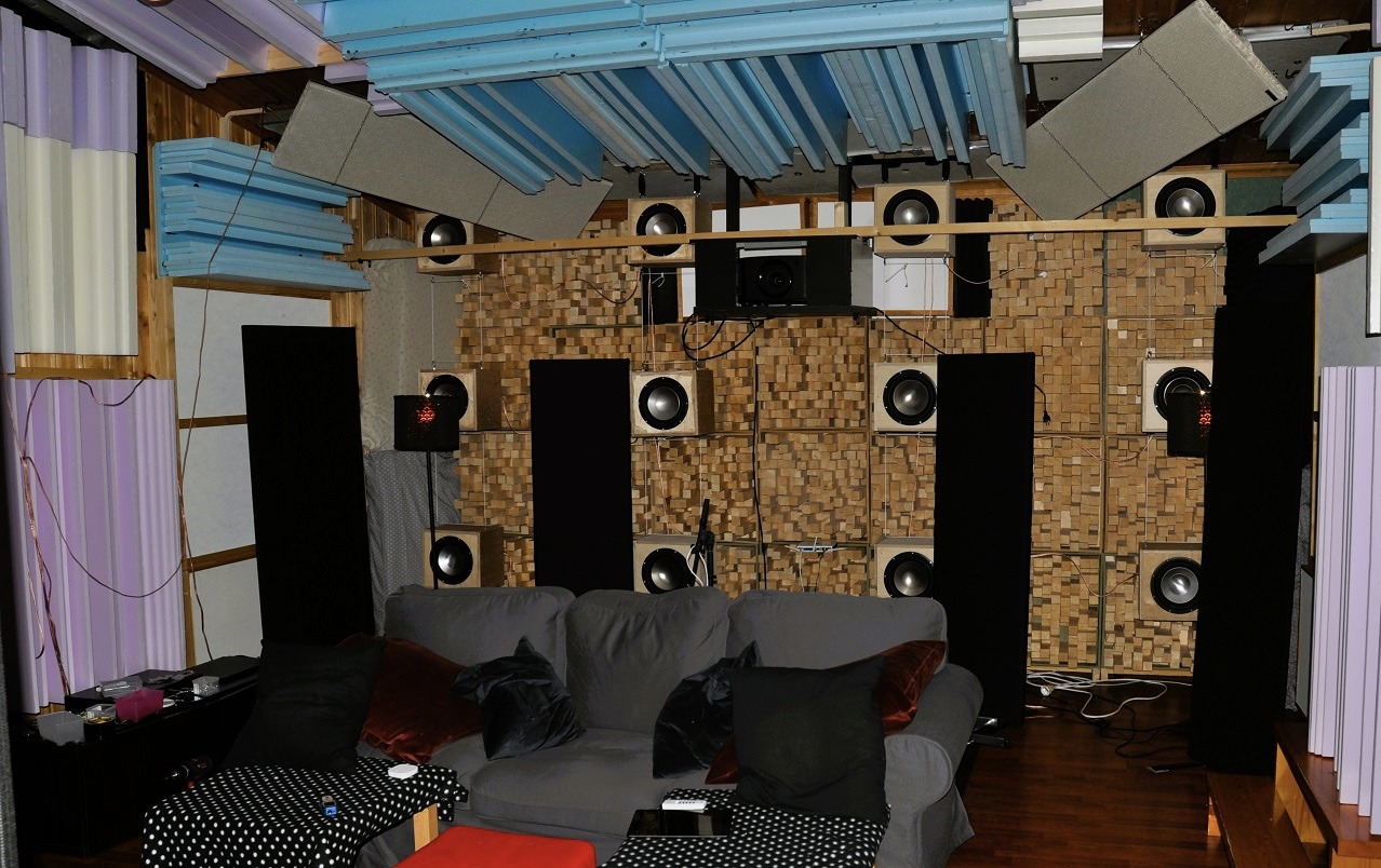

Its my own DBA with a whole lot of EQ on the rear array.

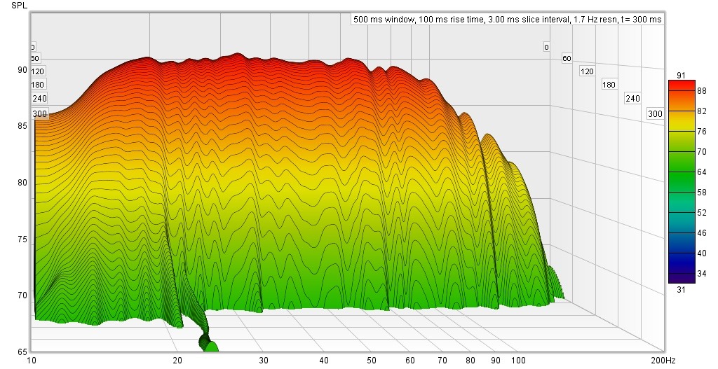

And its waterfall response... showing an almost total freedom from room resonances.
There is no low-frequency absorption in this room...

Wow, Nice to see you here again.The best bass I've ever heard measures like this in the main listening position (with low-pass filter @ 150 Hz).

its been ages!The best bass I've ever heard measures like this in the main listening position (with low-pass filter @ 150 Hz).

awesome looking measurements!
any quick pics of your DBA?
Thanks! It’s good to be back. I’ve been playing with DBA and Magnepan since the last time I was active here.

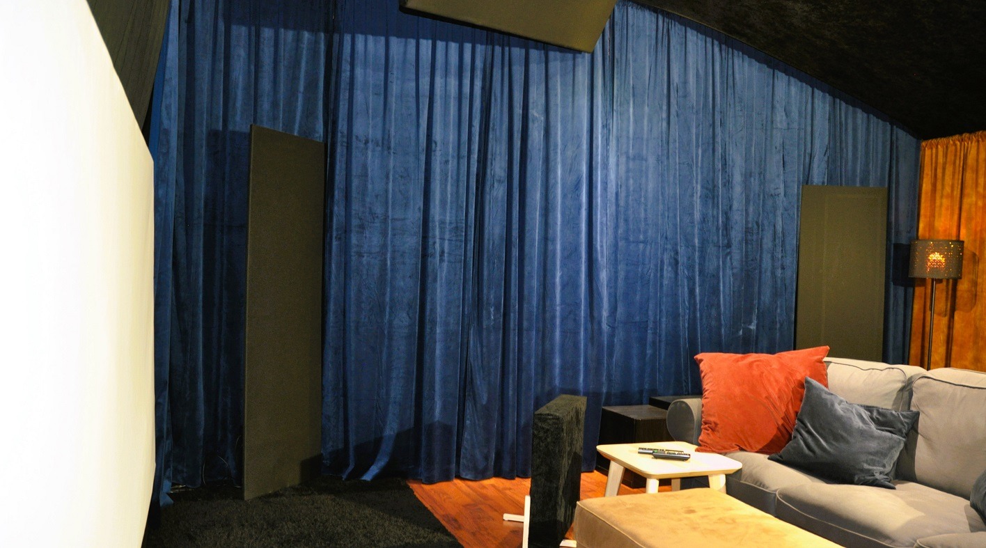

My current setup is a 5.1.4 system with five active Magnepan 3.7/3.6, four 1.6 as Atmos speakers, and the DBA. I’m using 24 Seas L26ROY woofers in small closed boxes. The room looks kinda crazy, but it’s usually covered up with curtains.

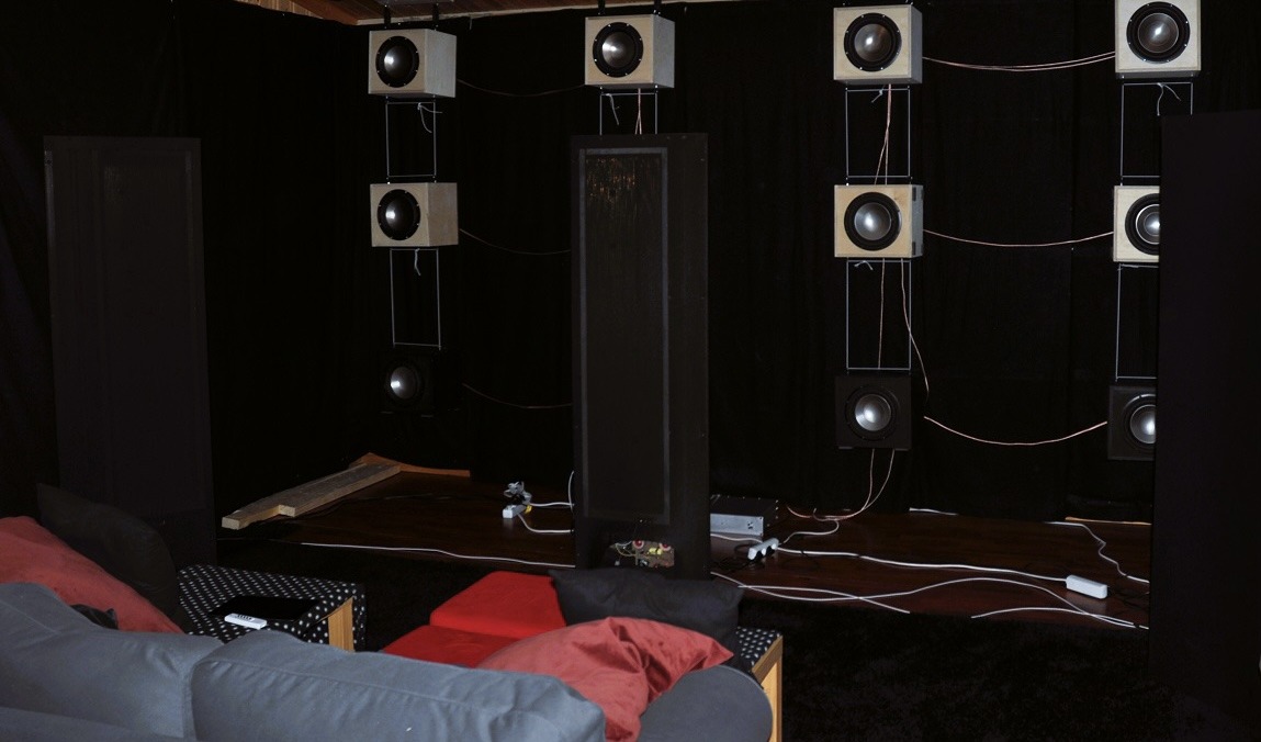

Front end including three Magnepans.
Rear.
Two of the Magnepans on the picture are no longer there. This is taken when I had a 7.1.4 setup.
With the clothes on …
