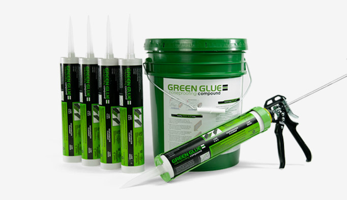

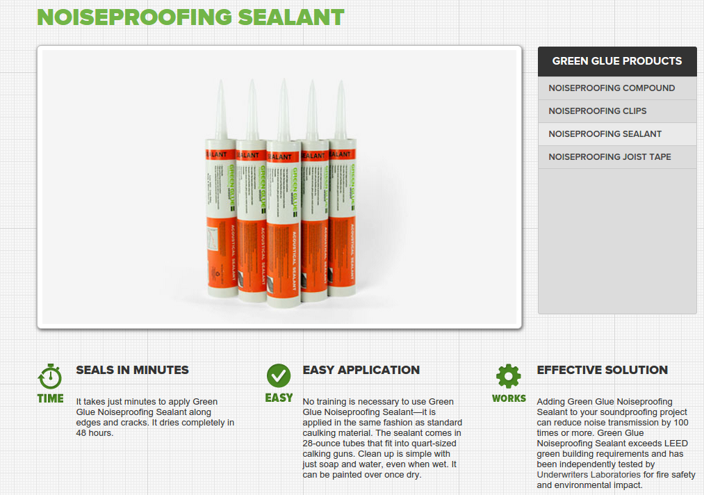

Best Material ? anyone use this before ?
I am actually researching various ideas and ran across this and found it to be interesting. They make some pretty bold claims, I checked and it is NOT made by "Ronco" ...lol
Anyone tried this glue ?
Steve -
greenglue . com
Steve -
greenglue . com
That's been my experience. The very best cabinets I have (not) heard where made with extremely dense plywood, with a layer of sand between. No box talk at all, which is amazing when you don't hear it.The latter constructions tend to lose or convert movement energy into heat, by friction losses in the material. That energy will not be radiated as sound into the air around the speaker.
Not all of us can do 3 inch thick sand filled cabinets walls, tho. Thus the search for a more practical method.
In my opinion - having used almost everything mention here - HOW the enclosure is damped is more important than the material. Damped cross bracing and damped CLD layers on the largest panels works wonders. Then one can use a lighter material like Polyurethane and not have to deal with loudspeakers that weigh as much as a safe.
