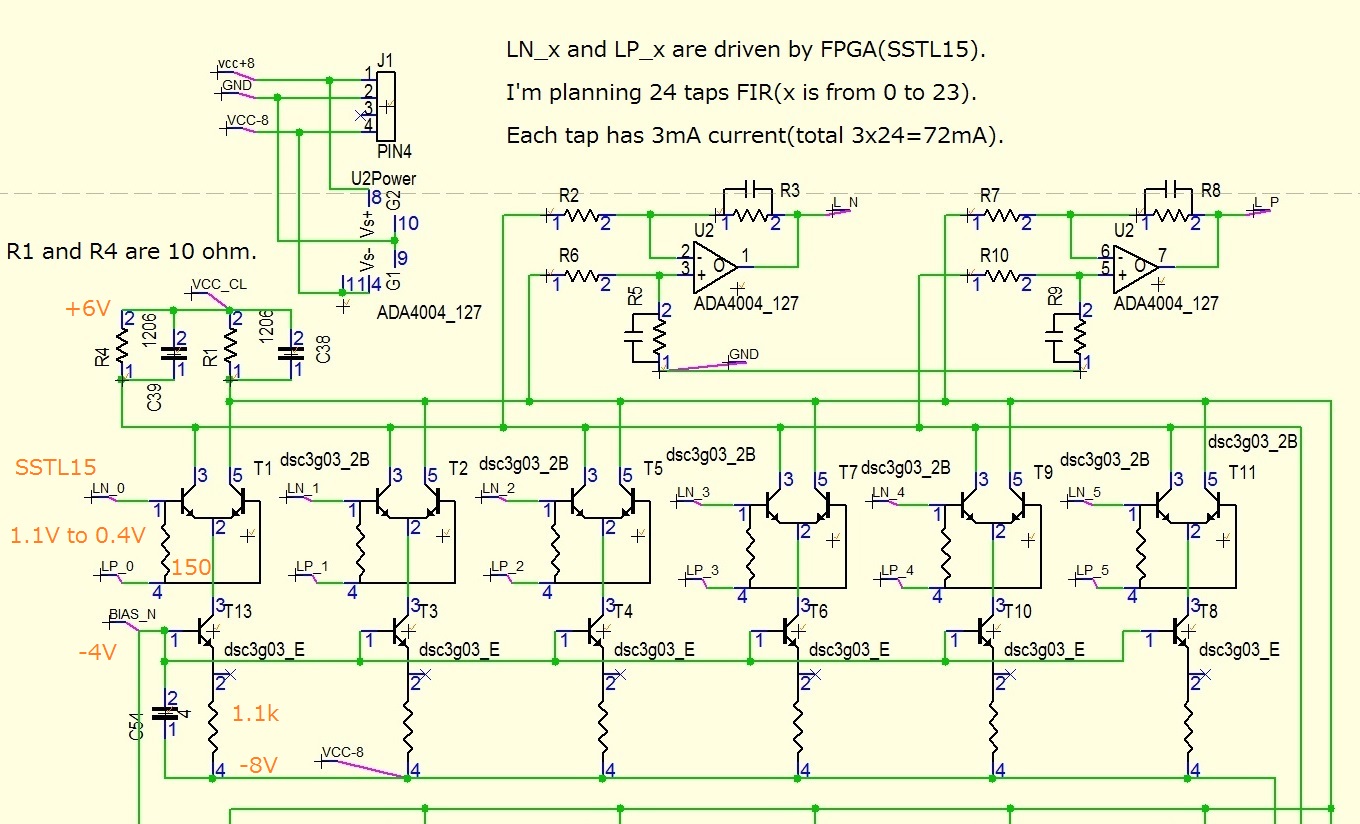

BTW, I'm now designing DA converter(no DAC chip) for 1bit DSM. No DAC topology usually has 0 PSRR, which is the disadvantage of no DAC. I tried ECL logic conversion to have some PSRR before. I wasn't able to have a good result because it had only one tap, and the driver was poor. My current design has 24 taps and a powerful driver, e.g., SSTL15 designed for DDR3(up to 800MHz). My PCM to DSM conversion implemented by FPGA is already finished. The rest to the goal is ideal PA conversion, I would say Pulse to Analog, in 1bit DSM. How about the attached pic?

This is a differential ECL. One tap(T1 and T13) is the current switch(T1) and current source(T13). If you remove T13 and connect the collector and the emitter, you have typical ECL buffer with a differential input. I'm sure active current source is better than passive one constructed by one register, though I need to do some trial and error with the real PCB.
T1 is non-saturated current switch driven by SSTL15. In 1 state, LP_0 is 0.75+0.35=1.1V, LN_0 is 0.75-0.35=0.4V. In 0 state, LP_0 is 0.75-0.35=0.4V, LN_0 is 0.75+0.35=1.1V. The difference(0.7V) is enough to turn on or off the two transistors of T1. The transition time is minimal (0.2nS) because SSTL15 is up to 800MHz capacity. The disadvantage of ECL is the difference between turn on and off. Turn on is active while turn off is passive. I don't know how much it dominates the performance. But you are almost free from disturbance caused by digital switching, though terminated transfer(75 ohms), small voltage swing(0.7V) and non-saturation(constant current) are in favor for you.
FPGA(xc6slx9 in QFT144) has 25 differential SSTL15 drivers with the internal 75-ohm resistor. That's why you need two FPGAs for stereo DAC(I need 24 drivers for one channel). But two chips have the advantages, where PCB layout is easier than one large FPGA, and DIY friendly package(QFP) is available. One FPGA for one channel isn't a bad design.:)
As to JFET, I know high-speed analog switches supplied by AD and have some experience with them before. They are not discrete part but monolithic one for me, which means fine adjustment isn't available. I have no experience with a single JFET for high-speed switching. It's easy for me to use a transistor for "pulse" to analog conversion with FPGA which have the job in the digital domain, i.e., PCM to DSD conversion, pulse width adjustment for compensating the difference between turn on and off and optimum usage of 24 taps.
