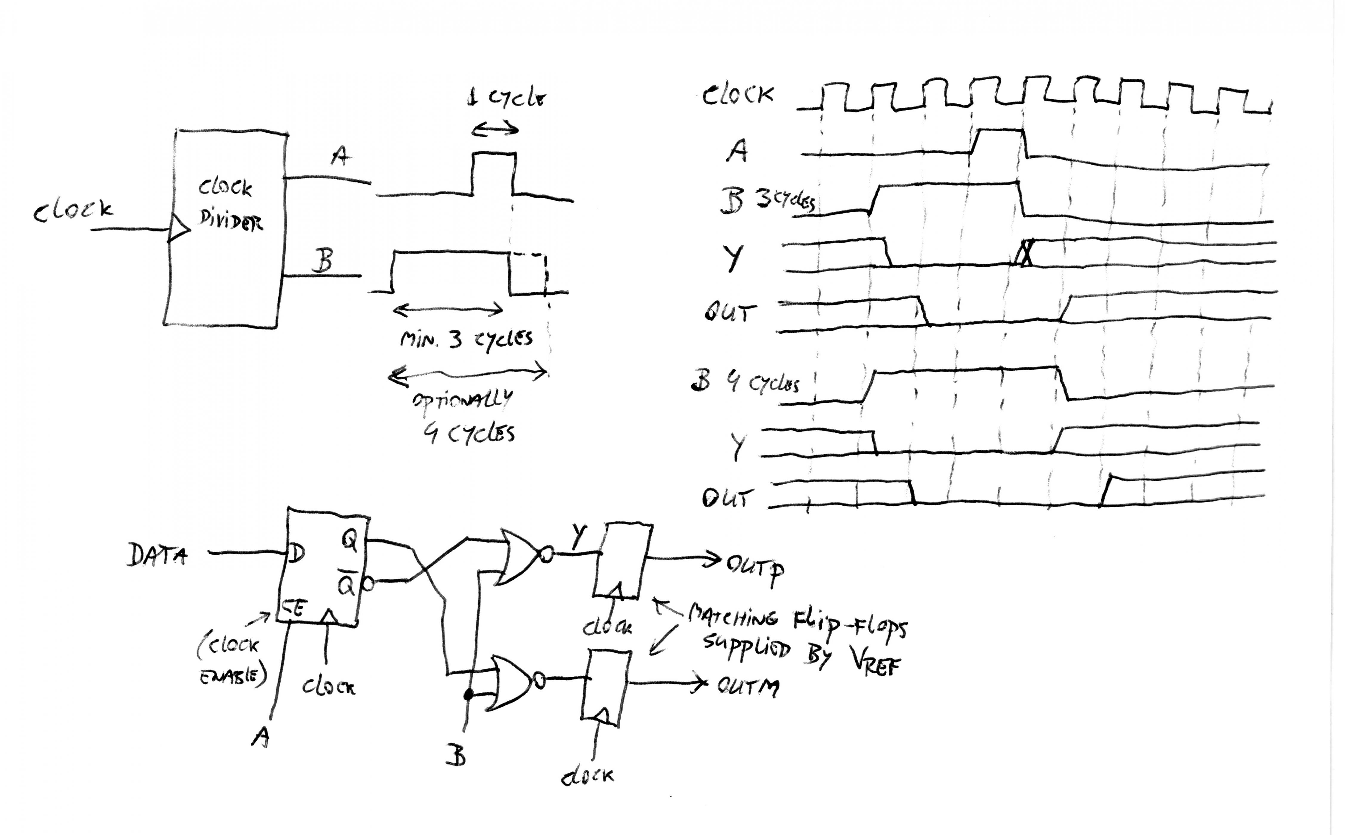

I've thought a bit more about JohnW's remark about crosstalk from the flip-flops to the RTZ logic gates. One of the reasons why I have LC-filters between the regulator that supplies the flip-flops and the RTZ logic gates is to reduce this crosstalk. Separate regulators would probably be better. In either case, it would indeed be nice to time the flip-flop activity such that the impact of this crosstalk is minimized.
The flip-flops that clock in the raw input data will draw data-dependent current pulses that depend on both the new and the old bits. The filtering effect of the supply (inductive voltage regulator with capacitive decoupling and some damping term) will smear out these pulses in time. Hence, when the same regulator supplies the RTZ logic (or the resynchronization flip-flops, if those are used as the DAC), it is not possible to time the flip-flop activity such that it doesn't disturb the RTZ logic at all.
Nonetheless, the crosstalk path will often behave more or less as a differentiator to time or as a high-pass filter with a very small time constant. Examples are common impedance crosstalk across the parasitic inductance of a decoupling capacitor or crosstalk via a mutual inductance between current loops.
With a differentiating crosstalk path, there will be hardly any low-frequency crosstalk, but high-frequency crosstalk that gets multiplied with the datastream could still produce low-frequency components (at the difference frequencies between crosstalk and datastream). Hence, in these cases, it should help to only allow the data flip-flop to switch during the blanking period (no matter whether the blanking level is the same as the 0 level or somewhere halfway between the 0 and 1 levels - just as long as it's the same for each clock period, so no downmixing of high-frequency interference can occur).
A normal master-slave type D-flip-flop consists of two latches, an input latch and an output latch. After a falling edge, the input latch becomes transparant and starts following the input data. After a rising edge, the input latch is locked and the output latch becomes transparent and takes over the data from the input latch. Hence, ideally both the falling and the rising clock edge of the input flip-flop should occur during the blanking period with some margin on either side to allow for RTZ logic delay. The clock should be high when the actual data are output from the RTZ logic. (For a flip-flop with clock enable, usually implemented as an input multiplexer, the clock may switch, but the clock enable should only be high during the blanking interval, with some margin on either side.)
Making a FIRDAC with cells that work on opposite clock edges becomes impossible, because otherwise there are no time intervals left when the data flip-flops are allowed to be active. Hence, the circuit will become sensitive to duty cycle and using a clock at a multiple of the bitrate and a clock divider to get a very well-defined duty cycle becomes necessary.
With a clock divider, to avoid accumulation of jitter, it starts to make sense to have resynchronizing flip-flops on the outputs. As these process only RTZ data, they are allowed to switch outside of the blanking interval. In fact they have to, to get any signal out at all.
All in all, I then end up with the attached circuit. The blanking interval has to be at least three and preferably four input clock cycles, so if you don't want to lose more than 50 % of the signal, you need at least six to eight clock cycles per bit period.
Note that only the output flip-flops should be supplied by the reference supply, as this ensures a pattern-independent load on the reference, because in each bit period, there is precisely one of these flip-flops producing an output pulse. Depending on the data, it is either the flip-flop connected to OUTM or the flip-flop connected to OUTP. This also means that these flip-flops should match, so a dual flip-flop is more favourable than two separate ones.
For my DAC all of this would not have been very useful, as there is always activity from the FIR filters in the FPGA outside the blanking interval. That is, I need to rely on the isolation between different supplies anyway. I did choose the FPGA clock frequencies such that at least FPGA clock harmonics that somehow leak into the DAC reference produce no whistles.

I still have difficulties wrapping my head around this, but delaying and dividing clocks can be done with this device:
LTC6954 Datasheet and Product Info | Analog Devices
It's easy to program with a Linduino (slightly modified arduino, though it can be used as well with a small adaptation). Its got excellent jitter specs, can delay multiple clockcycles and divide in integer steps to 63 and options of various output types (cmos pecl etc).
In general it could be the heart of a versatile and high quality clocking core, which might come in handy when you don't have the capability to go for fpga's etc;-)

Marcel, Could this rtz style 'no dac' be made into a simple project? Similar to others efforts in this thread? Make a run of boards for it? This can handle PCM and DoP? And Native DSS? If so I'll just wait and see where this goes. 🙂
If you want to keep it simple, it will become a DSD-only DAC with a raw DSD interface. If there is a master clock available at an integer multiple of eight times the DSD rate, it can be the version of post 2223, otherwise the simple NOR-gate/AND-gate version.
