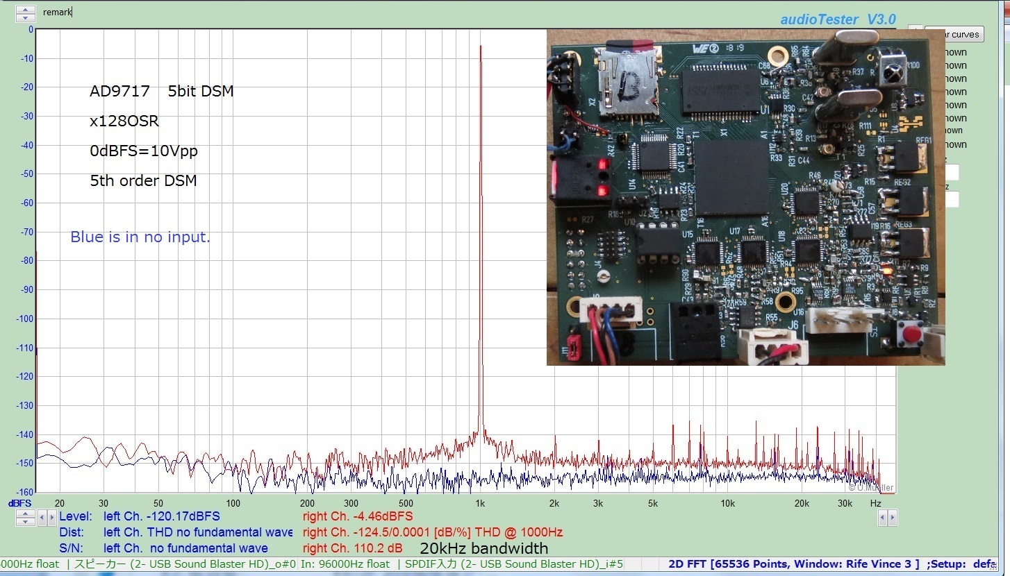

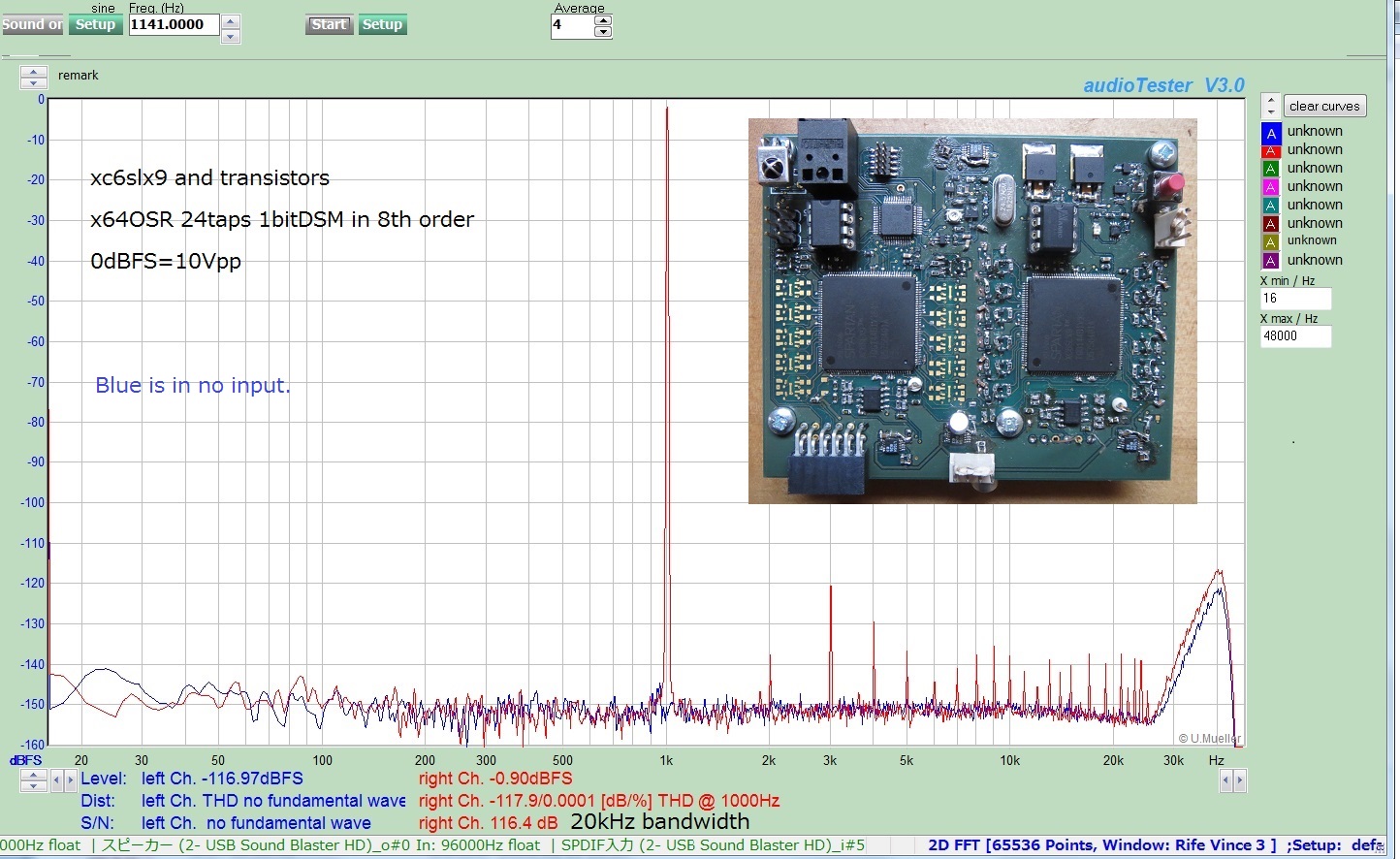

Hi, all. I have managed to achieve a successful result in my noDAC project after a two-month trial.🙂 As the theory suggests, 1bitDSM(DSD) has promising potential indeed.
The detail is here.
My no DAC project. FPGA and transistors.
The 1st pic is 1bitDSM with x64OSR in 8th order. The 2nd is my DIYed 5bitDSM(AD9717). 1bitDSM is superior to 5bitDSM.:wave:
