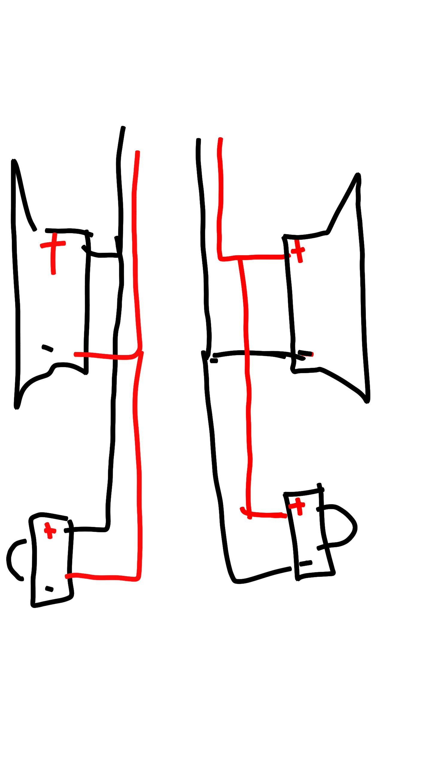

Hey guys I've nearly finished my halfinator but really questioning myself about my wiring. I feel like I may have stuffed something up with the whole 180° phase switch.
Here's how I did it.
Sorry about my diagram did it on my phone
yes, stuff up
