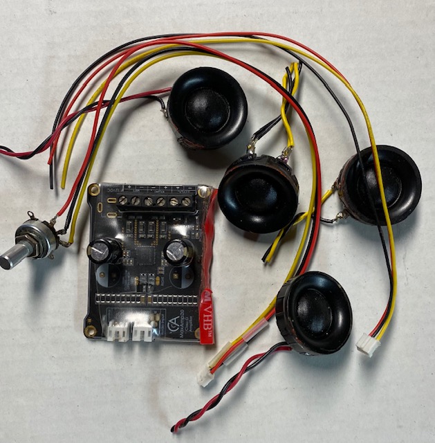

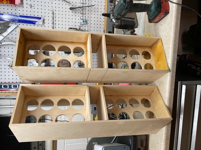

I want to build a Boominiator Micro and during the time from reading and deciding to go ahead the MaxAmp20 is no longer available, unless i missed somthing. I read that no more than a 15w amp per channel should be used.
The mini uses a filter on each channel of the amp going to the four drivers on each side. On the diagram dipicting the micro it has a filter going to just the one set of the drivers.
1-Does the micro require two filters, each filter to its own set of drivers, front and back, on each channel of a stereo/dual amp. I would have thought it would have a mono amp and one filter going to all four drivers.
2-what would be a good amp to use on the micro, or a source of the maxamp
Be great of someone could help clear this up for me
thanks
