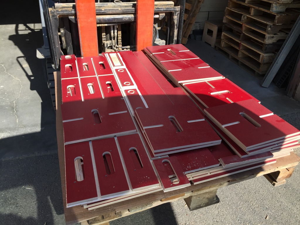

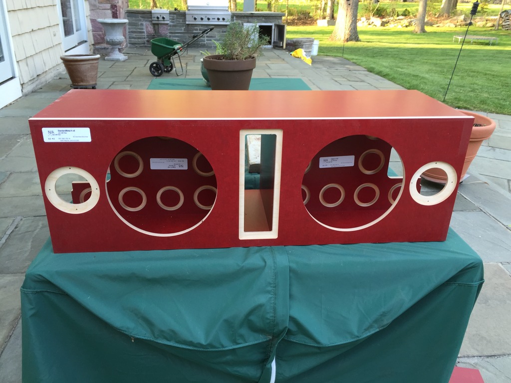

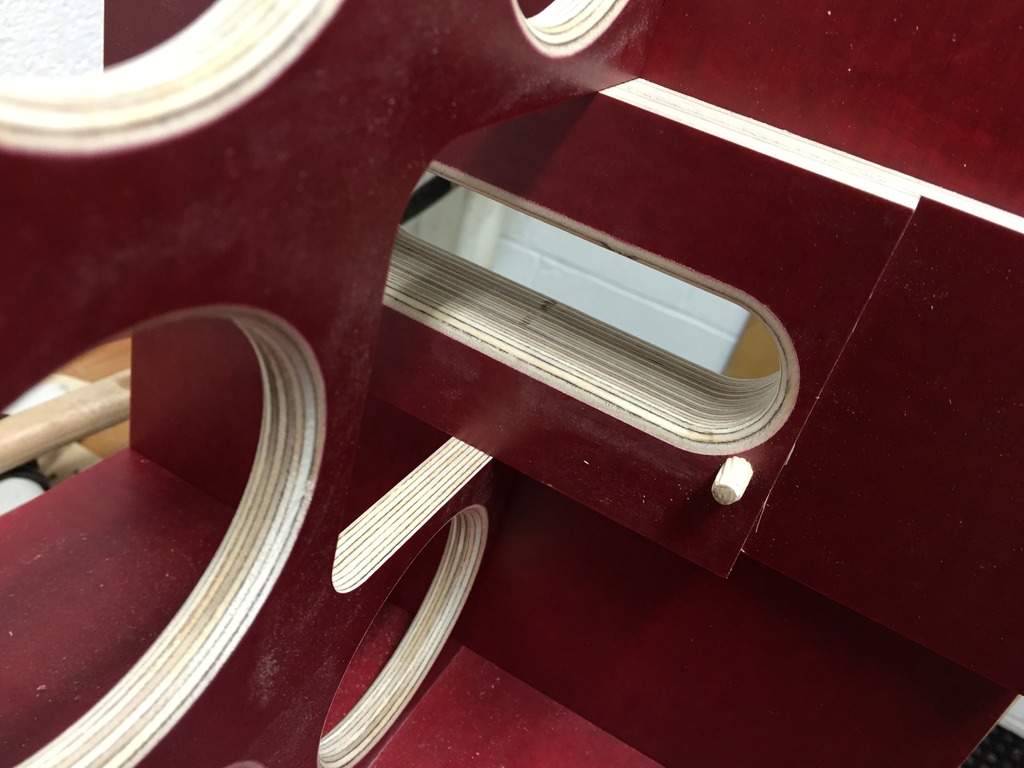

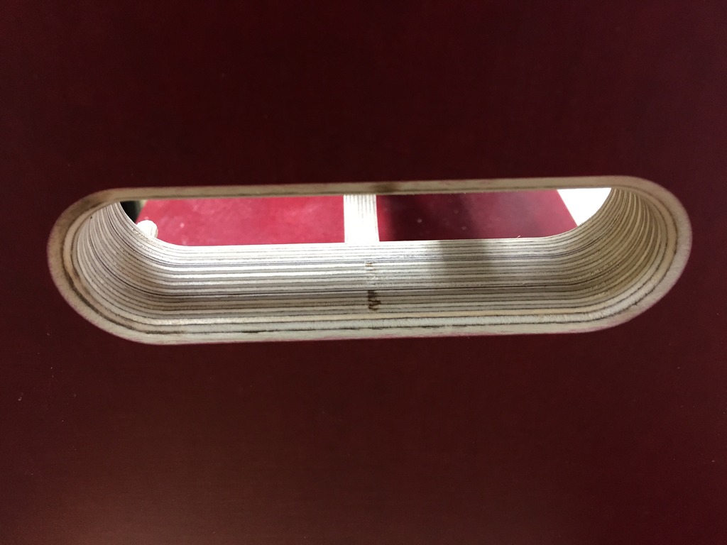

Any Interest in CNC Flatpack and Drivers (USA)?
I plan to have a few CNC flatpacks made and I have a stock of the required drivers.
Ideally I would like to keep a few and sell a few. Is there any interest? I am located in Connecticut and can ship. Attached are a few photos from the last batch I did.
My signature also has links to the 'Boominator digest' and a couple of videos from the Boominator build.

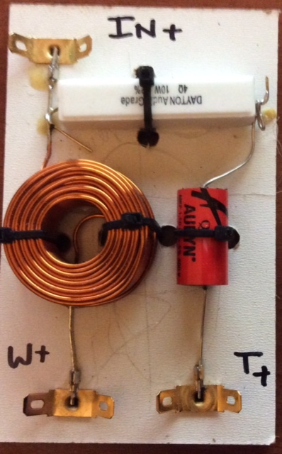

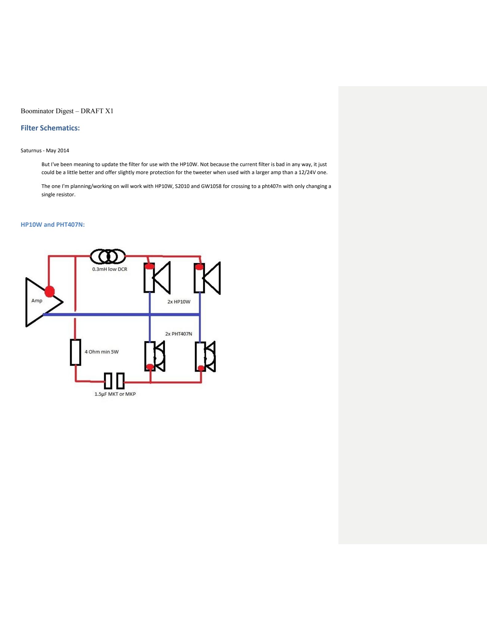

Capacitance = 1.5uF
Resistance is 4 ohm (resistor) + 4 ohm (2x parallel 8 ohm tweeter) = 8 ohm
Cutoff = 1/(2*pi*R*C) = 13 KHz
Note that the total response = electrical response + acoustical response.
This electrical cut off frequency is higher than you would normally expect. The resulting upward slope at most of the tweeters frequency range (3 - 13 kHz) is used to equalize the acoustic response of the PHT-407N tweeters, which by itself will slope downwards (especially off axis).

Separately, do I need to flip polarity on my PHT407N tweeters (i.e. negative tweeter to positive amp) - diagram on digest suggests no, but Saturnus note is confusing:
Please note mistake: The plus on the tweeters should be connected to minus on the amp, not the plus on the amp as I have drawn here
This is the set up I am using in my halfinator. I've order all the bits. I am still confused by the comment in the guide "Please note mistake: The plus on the tweeters should be connected to minus on the amp, not the plus on the amp as I have drawn here" - is the diagram wrong, do I need to reverse polarity to the tweeters? A bit out of my depth but I understand the use of the crossover might require the tweeters to have polarity inverted?

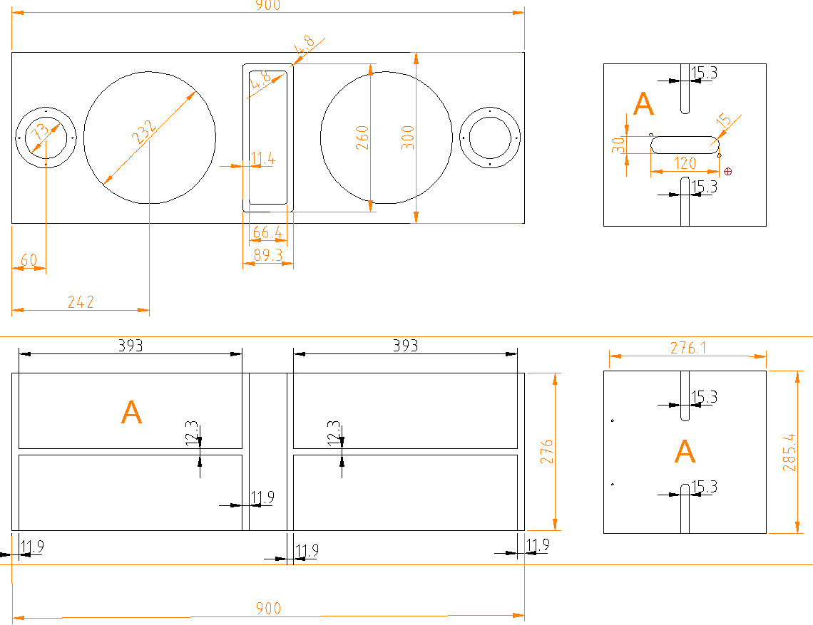

Also, I got used a sketchup template that was wrong and have an 18mm gap behind each driver. As this has been CNC cut and wasn't cheap, I am not keen to get a new one cut. If I pack behind each with 18mm ply (so there is 48mm of ply total between each driver, and backs of drivers glued on) will this affect sound quality? I am guessing the additional mass of the wood will reduce the db slightly as the drivers won't able to work together as efficiently.

First order crossovers are usually wired with same polarity, but there may be a funny bump or dip in response, run a sine sweep to see which seems better, listening to music you will not likely hear any problems, which, yes, implies that it doesnt actually much matter, so dont over think it. Same with the driver spacing, Saturnus said that putting the magnets together like that increases efficiency, i don't think he ever measured this, it could be true, but it could also be true that it makes them worse, in the cold hard reality of everyday listening you will probably be struggling to hear any difference.This is the set up I am using in my halfinator. I've order all the bits. I am still confused by the comment in the guide "Please note mistake: The plus on the tweeters should be connected to minus on the amp, not the plus on the amp as I have drawn here" - is the diagram wrong, do I need to reverse polarity to the tweeters? A bit out of my depth but I understand the use of the crossover might require the tweeters to have polarity inverted?
