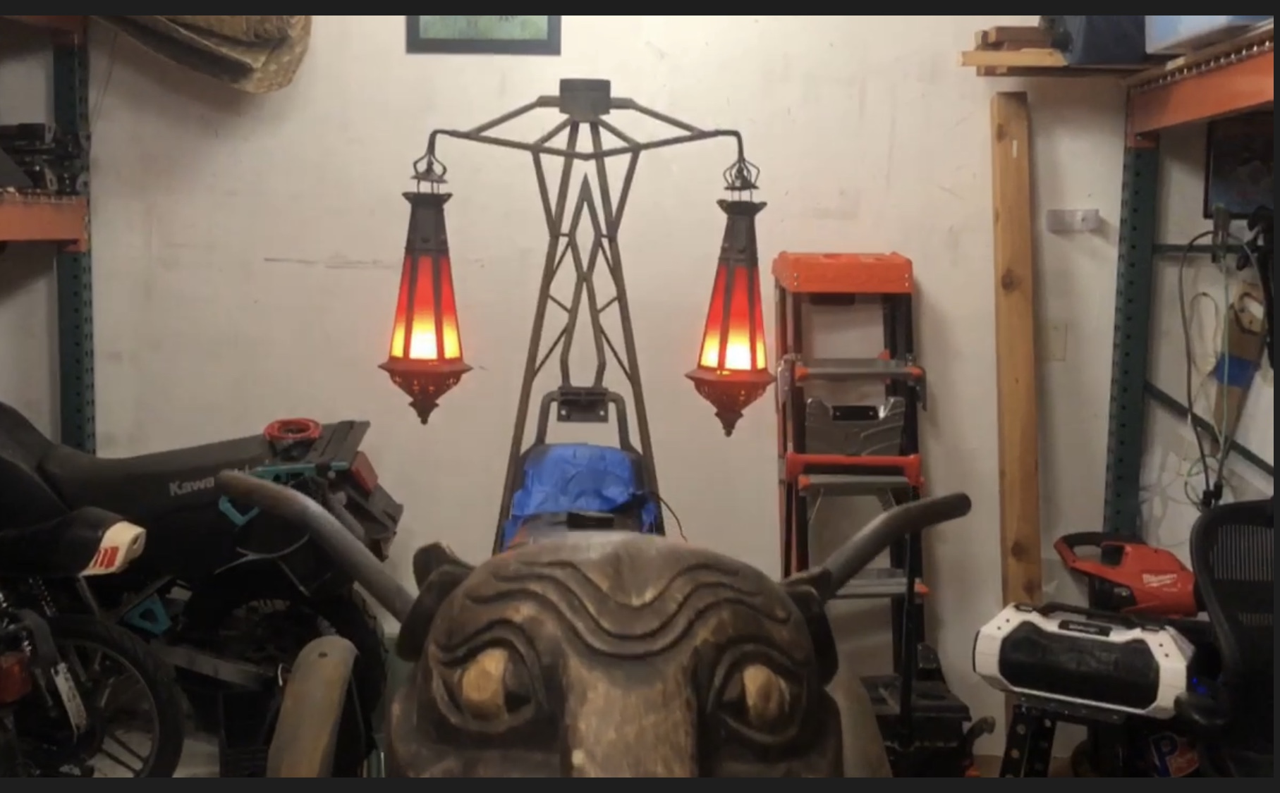

Thank you so much for this resource! I'm finally finishing up my classic Boominator this summer, after starting over 3 years ago. It's surprisingly hard to find some sort of compendium on this thing.
![6529CED2-EB02-4032-BC20-2A4039317277.jpeg 6529CED2-EB02-4032-BC20-2A4039317277.jpeg](https://www.diyaudio.com/community/data/attachments/695/695812-82938f15fe6aa47d59ef46c653071aa6.jpg)
