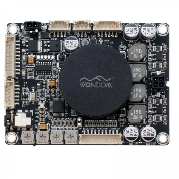

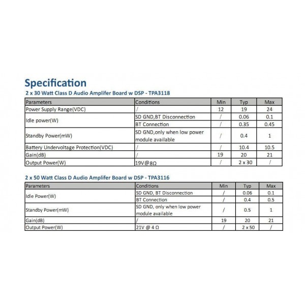

It's been a long while since I last posted. I am getting ready to build the Boominator Lite version as I have all the drivers. Since the original amp from 41Hz is no longer available, I came across this new board from Sure: 2 x 50 Watt Class D Audio Amplifier Board with Audio DSP - JAB3-250
It is available with a battery module (3x18650). I think you can wire two of these in serial to get 22V. Would it be enough to run the Boominator Lite?
Any insight would be greatly appreciated? Thanks

Two battery modules would push the input voltage to the limit. A 5S pack would be optimum for these boards.

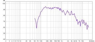

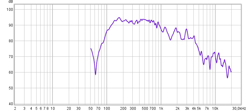

I've taken my old boominator back to the workbench to do some measurements. I've always thought my boominator was missing some low-end repsonse. I did check the phase and wiring and it's correct.
I have attached a near-field measurement of the woofer.
Do you have a similar measurement i can compare to?
Ive done a leak-test by taping the bass-reflex with a hose through. I've found that the drivers are not air-tight, as i can "Suck" a plastic bag to the woofers. Is this normal?
