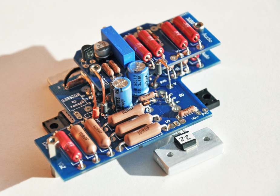

Maybe a few words upfront: the DAO is not your typical all-on-one-pcb-and-be-done kinda amplifier. It employs a multitude of small circuit boards, some of them actually tiny, for maximum flexibility and freedom of choice. This involves quite a bit of drilling and tapping plus custom work, even in the ready-made case (2109H) that was chosen for the beta amplifier.
To be honest this case is what it is: chinese mass-production (no pun intended!), but it will house everything there is (17 boards in my build, and the custom wound toroid), requires no major modification and is quite inexpensive. As some know my case work usually is a bit more elaborate, but it took me almost a year to build the DAO (for several reasons), so it is the commercial case for now.

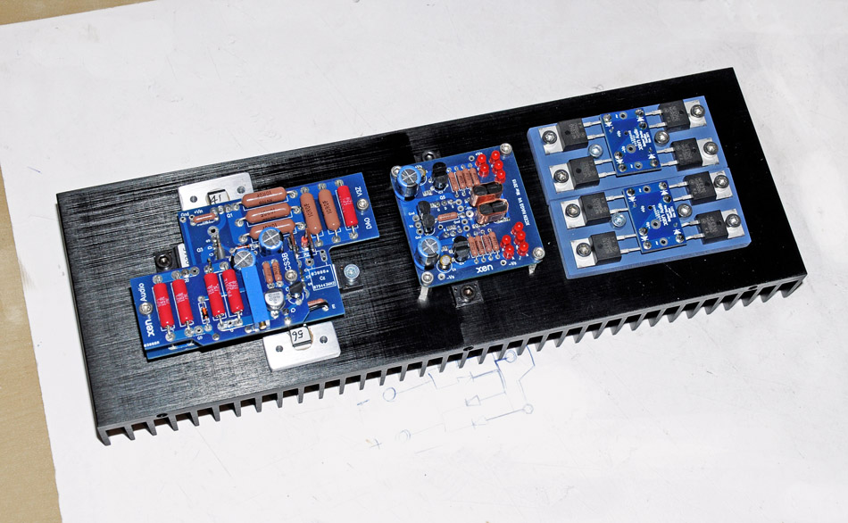

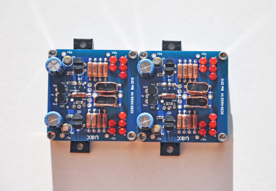

HAGS: Headphone Amplifier Gain Stage
PLEASE disregard the provisonal heatsinks made of copper foil... they where later exchanged with much better ones.
Also note that the boards use a mix of through hole and SMD parts, so make sure you can solder 0603 routinely.
First mock up on the left heatsink. Rectifiers are sitting on the rear of the left sink, and AC wiring from the toroid takes that into account.
I was trying to keep AC as far away from the Crossfeed (on the right side heatsink) as I could.
