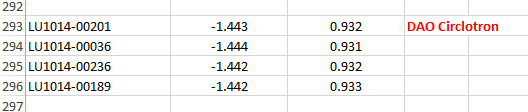

To illustrate the effort that goes into this, here is a quad set of matched LU1014s to be used in the next Alpha proto.
We took 250x prematched LU1014s from Deep Surplus, all from the same Vgs group.
We then curve traced them all in a triode cell under full operating conditions, at 40 degC.
From those 250 devices, about 10 quads were hand picked for this application.
(2nd column from left is Vgs at bias, 3rd is Yfs at bias)
In addition, everything else in the triode cell (Cascode FETs, source resistors, Zener diodes) are hand matched to tight tolerances.
Patrick

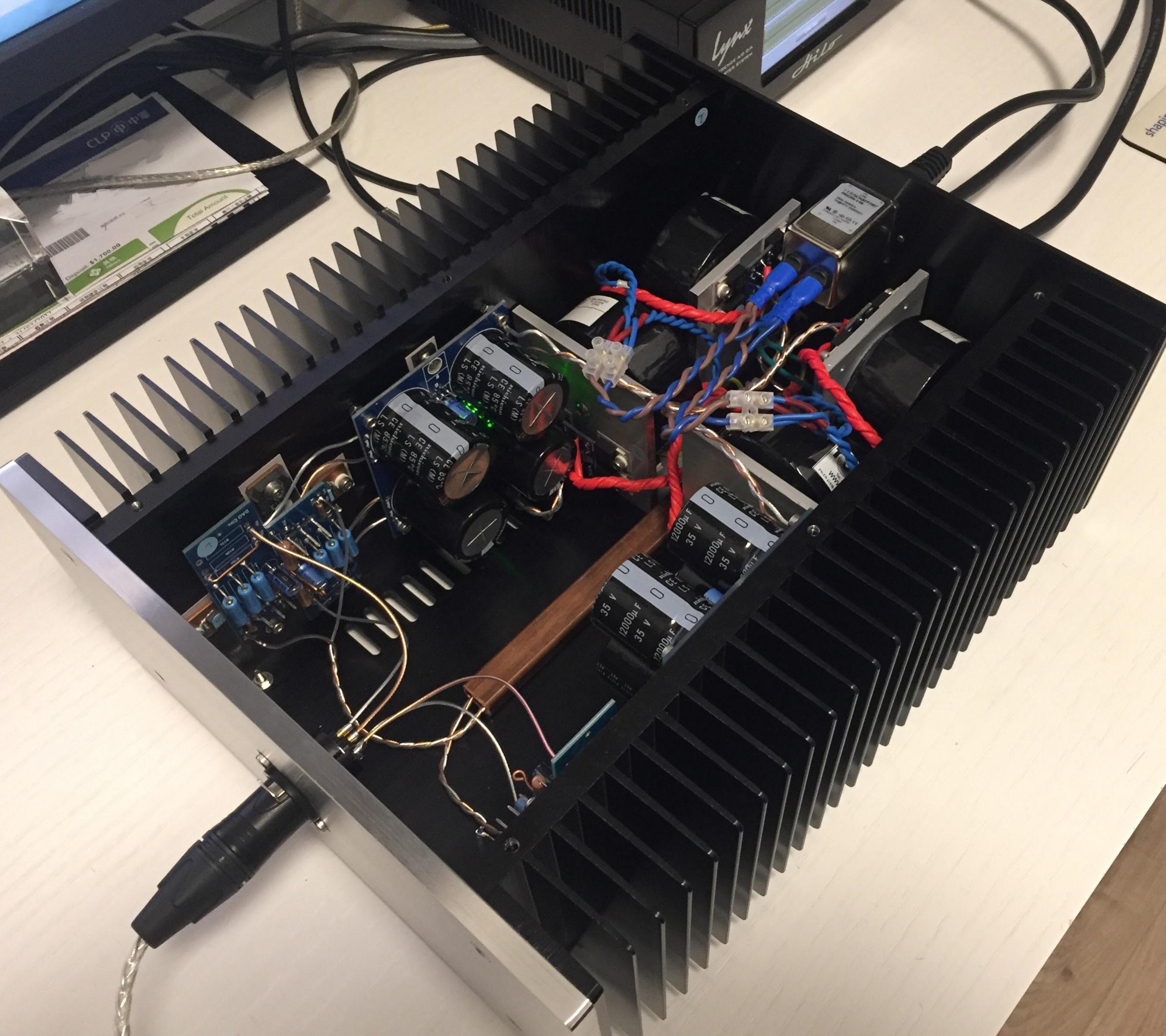

Correct about the transformers.
And this is only a prototype build using less well matched components.
There will be a final build with custom designed enclosures and perfectly matched devices later.
I am quite confident that we shall then have distortion level even lower than this prototype.
Very well built indeed (for a proto).
Patrick

Some very nice photography from Stixx.
DAO - Original-Ton
WOW! That looks more like a work of art than an amplifier.
Congratulations on such a nice build.
I'm sure some guys out there would gladly give up one of their testicles for an amplifier of that caliber!
By the way, what's the point of having through-hole pads on the PCBs for the axial leaded components if you aren't going to solder them from the top as well as the bottom sides of the board?

Not even for the balanced DAO which has < -104dB THD for the HAGS, and <-107dB for the circlotron.
All without any global feedback of course.
All of Stixx's amps look gorgeous.
In the end, you have to like the sound as well.
He certainly does.

Thank you Ammel. This is not the final case yet, although I will retain the general layout and the heatsinks.
I usually only solder from one side but make sure that the joints are flowed nicely.
And btw., I'd rather keep my testicles as well.
