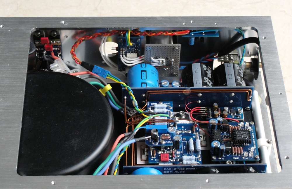

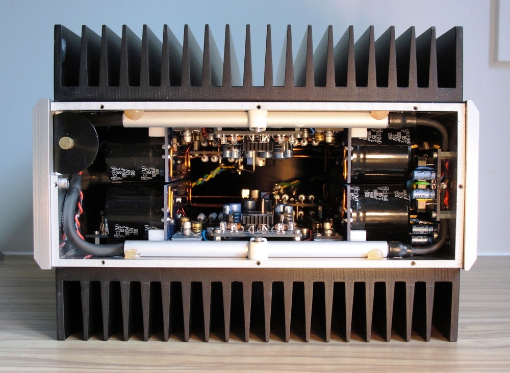

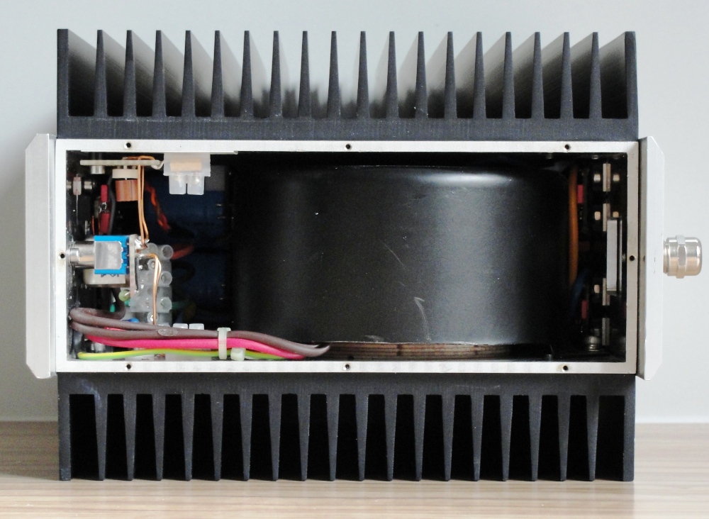

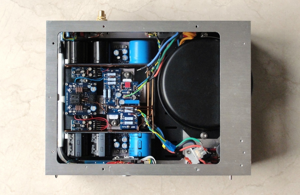

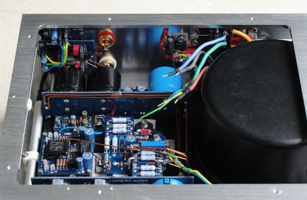

Quite a few years ago, I was challenged to build an even higher power version of the DAO for the HE6.
Also recently there is a trend for headphone amps with power up to 8W.
So just for fun, I obliged.
This uses the original 330mA triode cell, on +/-30V rails.
Weighs 11.5kg, with 150VA toroidal transformer.
Will surely power any headphones other than electrostatics.
Patrick

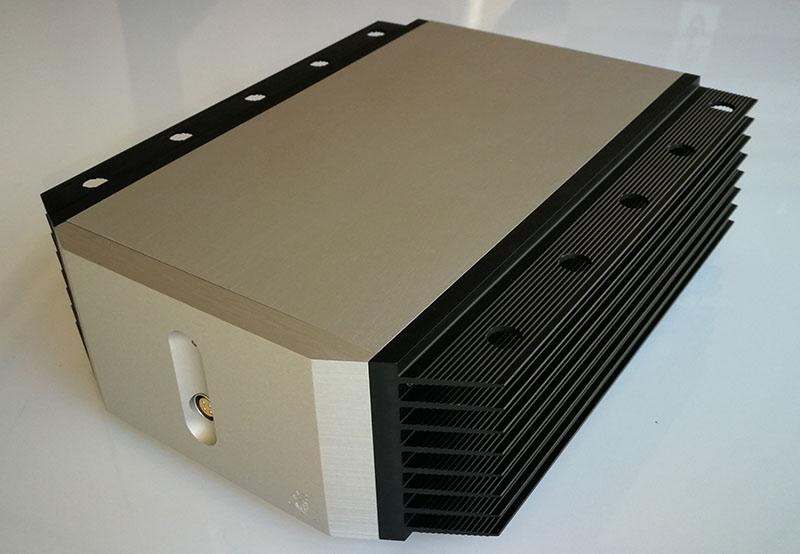

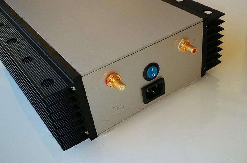

We are now allowed to see the work of one GB1 member (this one is not from XEN).
His design, his batch production, for those lucky GB1 subscribers only.
He even charged less than they cost him to make.
What dedication !!!!!
The rest speaks for itself. Absolutely gorgeous.
Patrick

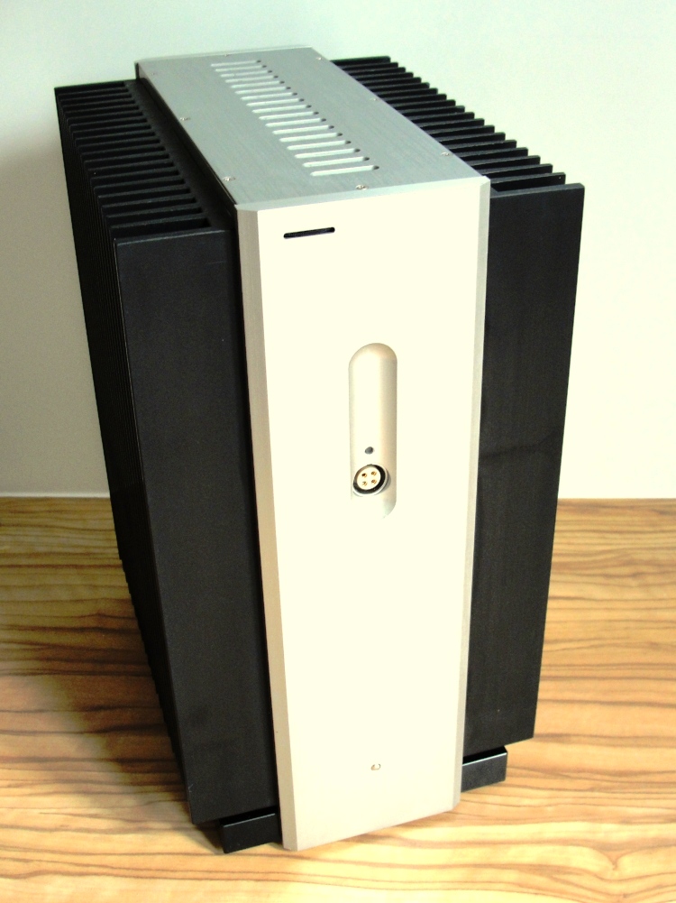

Yes, all subscribers decided for Lemo 2B 4 pin.
Much better connector than XLR.
There are also a lot of details such as internal ventilation, volume knob, etc.
They are all well hidden so as not to obstruct the aesthetics.
The brushing and matt anodising is very well done.
We know how difficult it is.
