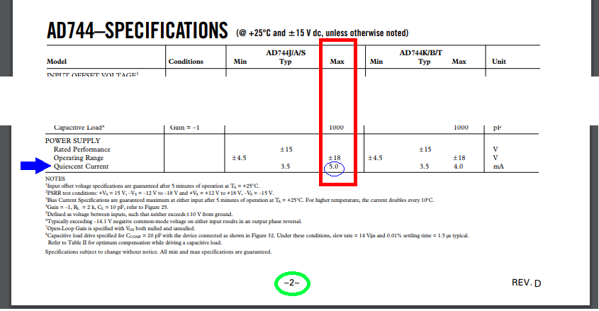

I’m still reading up on how to translate the output current (or other appropriate spec) for the AD744 into a supply current. The HA-5002 clearly lists the range of 8.3mA typical to 10mA max supply current. Fun stuff.
Different companies use different words or phrases to express similar ideas. Here is how Analog Devices describes and tabulates the expected supply current on their AD744 datasheet.
_
I had looked at Quiescent current, but I was not sure if I wanted the current with no load / idle or the max current (output current shorted). I thought it may be somewhere in the middle of the two.
There are so many similar terms, supply current, output current, quiescent current. To a noob, I looked them all up, but whether they can be interchanged seems to be based on the application and the circuit. All a bit <whoosh> over my head for the moment. Don't want to swing the thread to EE for noobs.
