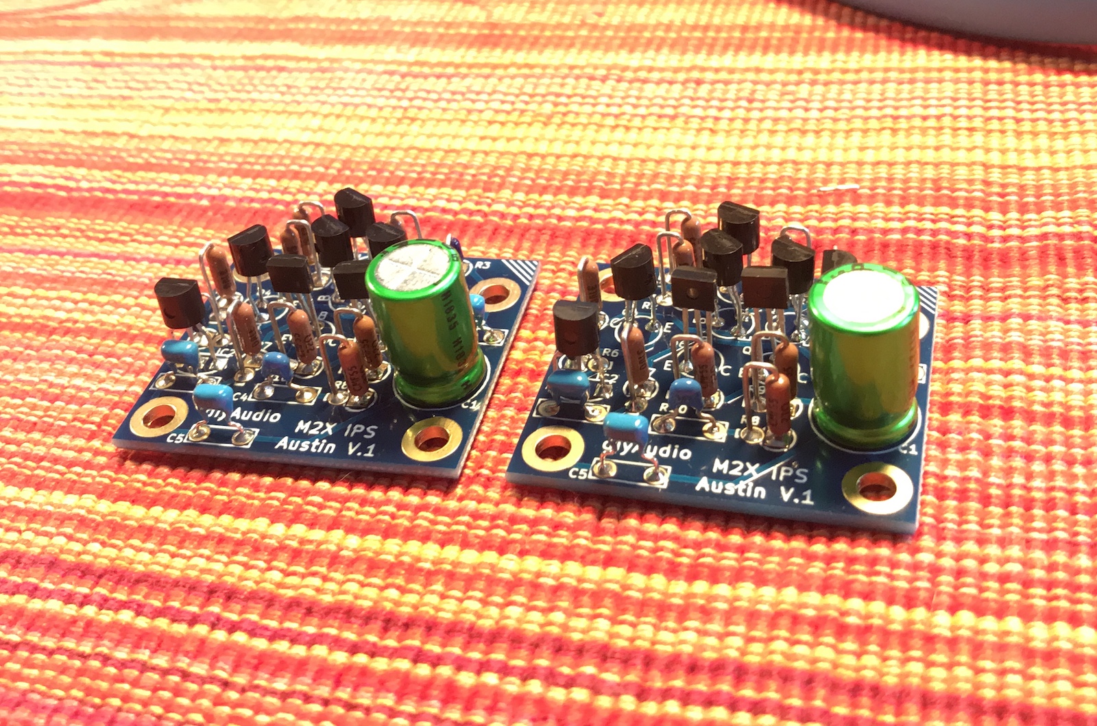

I was looking for a photo of an assembled Austin IPS board but could not find any...
Call me anal retentive, but I was wondering for the upright resistors which side the long lead should go, to the square pads, or the round ones, or maybe it's different for each and I should just look at the schematic to see where the "hot" vs the "not so hot" side is? I know, it's probably ridiculous...
But Mark must have had a reason to make one side of the pads square and the other round... what's the right way to do it? Thanks!

The square is the side where the shorter lead goes, you can see where he left room there for the larger diameter of the resistor... then the long lead goes to the round. (less room) This does make a difference for the layout as the carbon acts as an insulator... the design tries to keep two bare leads from being in close prox to one another. I/E you bend one a bit it hits carbon instead of shorting to another lead...
There's a nice hint there, look around the square pad and yo will see a circle, that circle indicates that something that size should go there... hence, above.
You can insert Austin's vertical-orientation resistors (member 6L6 calls them "soldiers") either way, and the board will work fine.
The schematic of Austin drives the PCB layout completely, since KiCad is an automatic-DRC, automatic-ERC system. Therefore, if you look real hard at the schematic and the layout, you can deduce the graphical convention for butted-lead versus bent-and-longer lead. What you see there is my attempt to make certain critical nodes available for easy electrical connection / probing, with a either a voltmeter or alligator clip or scope probe attachment clip. The bent-and-longer lead is much easier to access from the top side of the board.

Look at post #101
Thank you, I also just finished my own!

Finished the Austin boards, and listening now. These have the sweetness from the other 2 boards - the precision of Norwood and the energy of Mountain View at the same time.
I used the 0.4w vishay resistors that come in an 1/8th watt body. Tiny little things. I'm still traumatized by fitting all those transistors, with the data sheets printed out even.
My favorite of the 3 so far. Ishikawa and Tuscon built, but I won't listen to them this weekend most likely.
