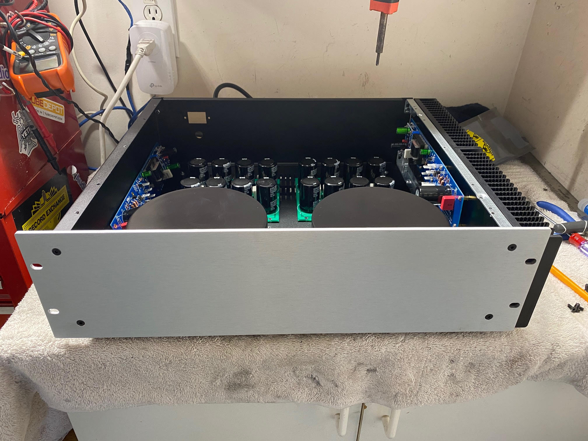

I am currently building M2x monoblocks out of some 400 mm 3U Pesante cases with 400mm by 300mm heat sinks on one side of each chassis. It didn't work perfectly so I had to re-drill some holes but I got one chassis put together.
The problem I am having is I have one AS-4218 but Antek is OOS. I am considering going with two AS-3220 transformers instead. Any problem with using these with 20V secondaries? I would imagine that gets me 25-26V rails.

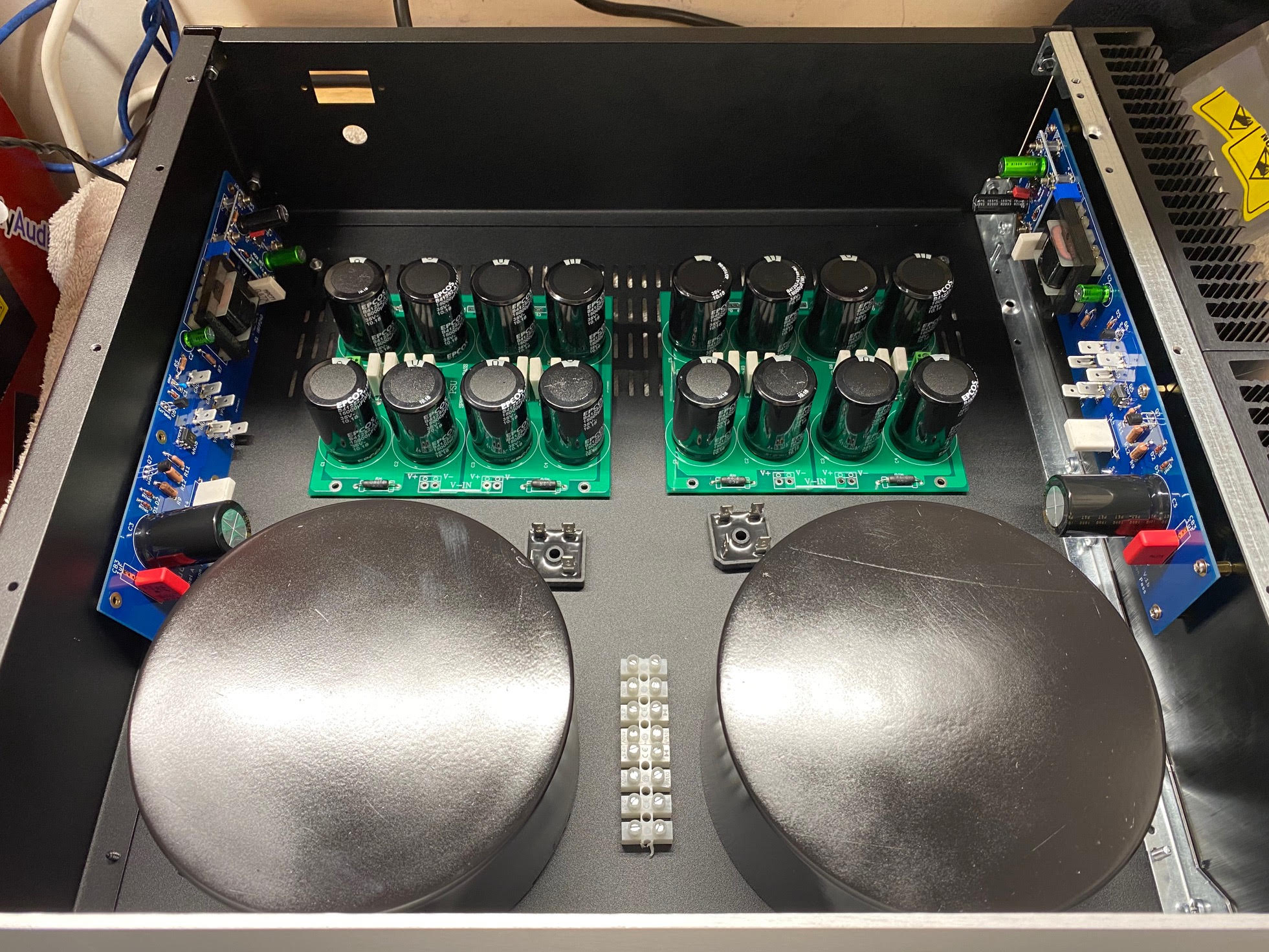

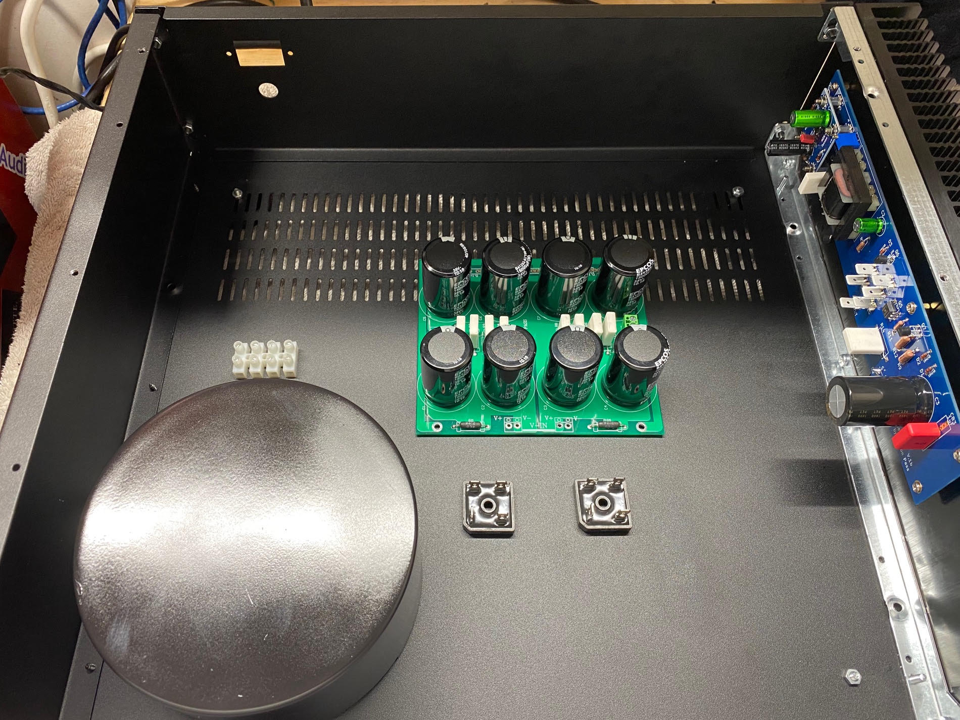

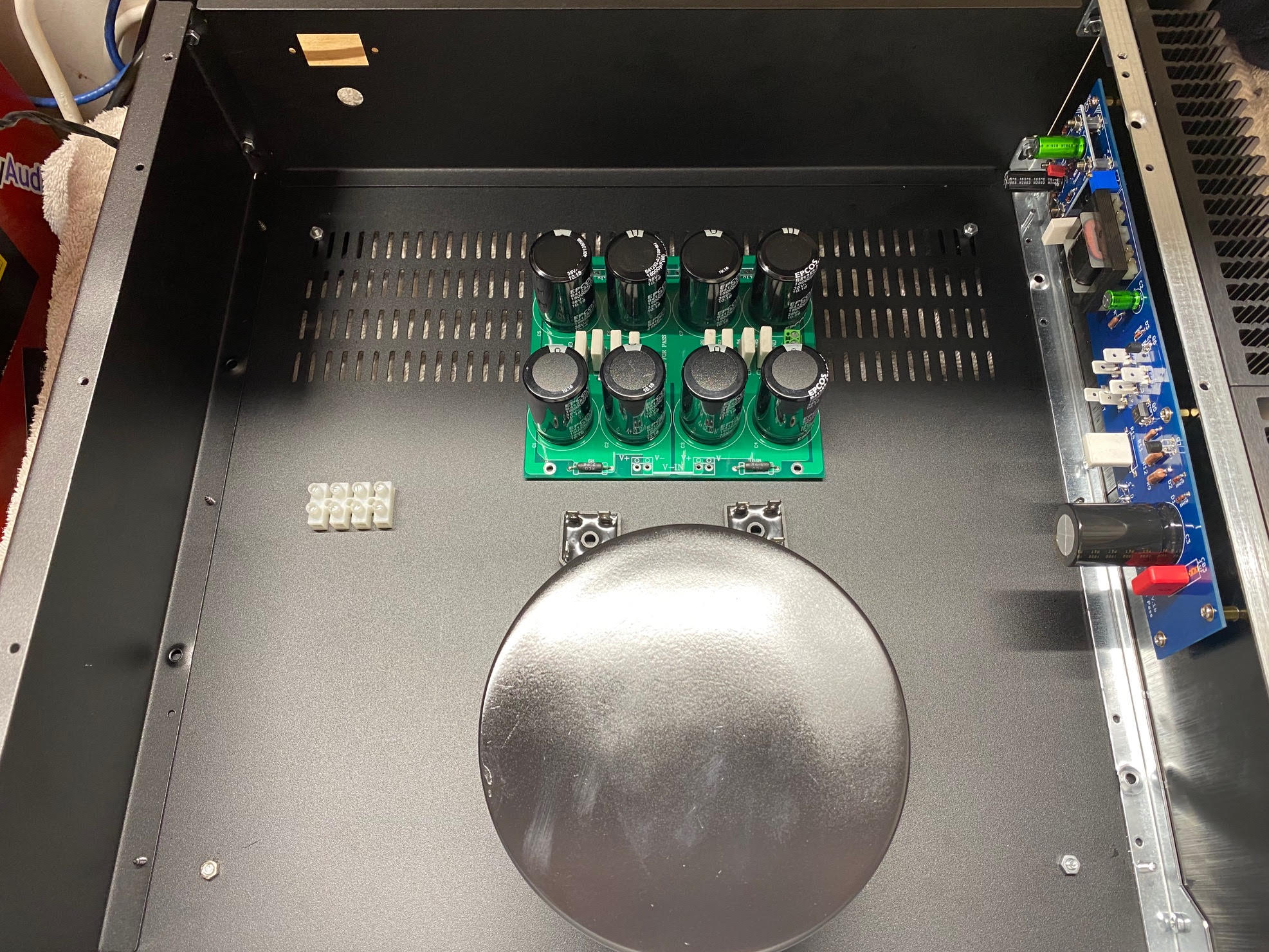

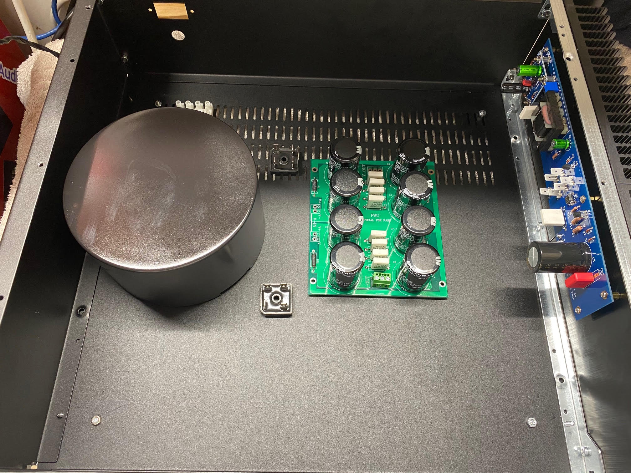

I ordered two AS-3220 for my build. My original goal was to build two monoblock M2x in separate chassis with the Edcor Transformer on the opposite corner of the Power Transformer in a cover, but I realized these larger chassis have much more space than expected. I wanted to get an opinion on how I should lay out the chassis. I chose to go the monoblock route because I was able to buy 2 Pesante 3u (with IEC hole), 2 pairs of mounting brackets, and the heatsinks for just under $300 and It allowed me to minimize transformer noise. The 5u deluxe chassis was $400 so I save a little over $100.
See below for the different options I have. The last picture just shows what the front looks like. I would like to swap out the 5mm to 10mm faceplates without the rack mounting holes so I can shift it over and it covers the heatsinks completely.

Yes, shielding and physical separation are needed to minimize the induced hum from the power transformers to the Edcor signal transformers. The last two pictures look like a good basic configuration.
The heatsinks will be plenty for an M2. Bias current is set automatically, and is independent of the supply voltage. That’s one of the neat tricks of the optocoupler circuit. Those block rectifiers will drop about 3.2V to 3.5V from the max of (20 x 1.4 = 28V). So expect 24.5V or a little more on the rails.
