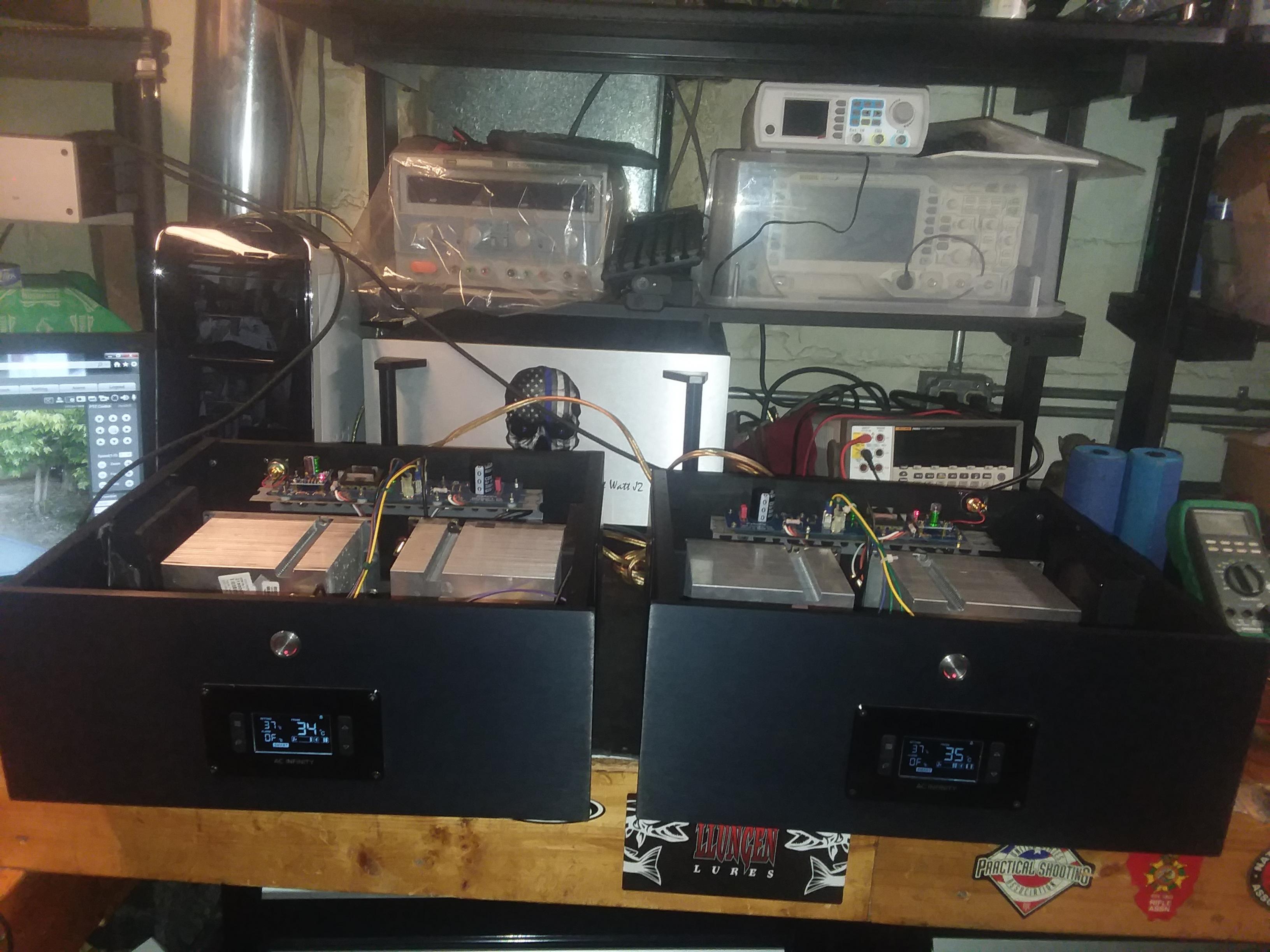

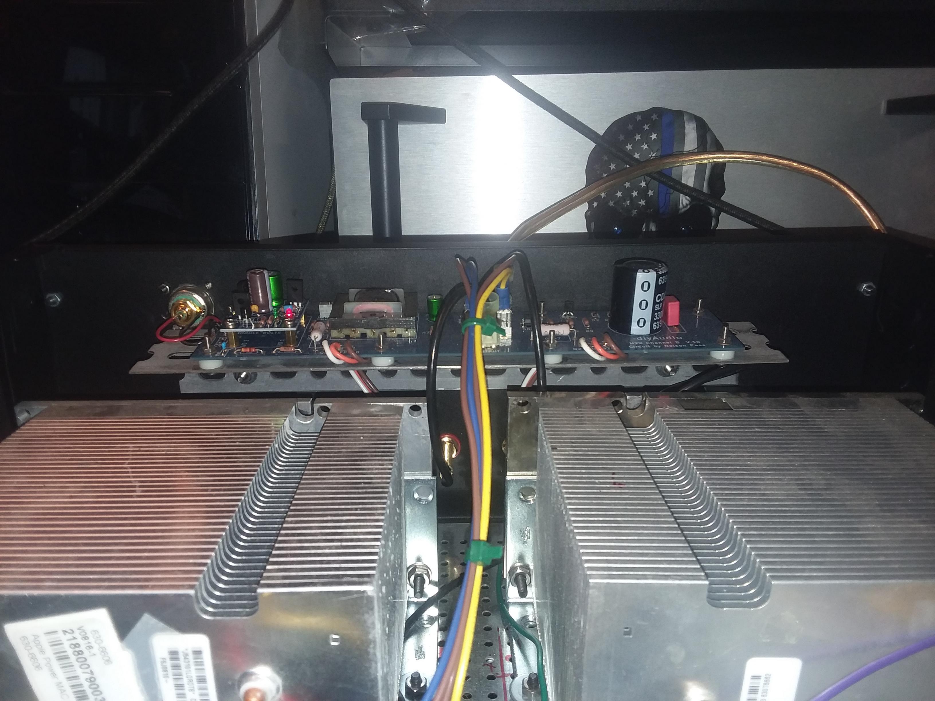

Well, I don't need any special stuff to change the boards cause they are right there... Also, I think this is the first case of mono or any build for that matter with flying leads on the M2... Been listening for about 4hrs and grinning like a fool. Also, no need to do anything with shielding around the Edcor... there is no hum.
I guess a pic is the best way...
How sexy are these ladies!! :) Listening to MTN right now with Mavis Staples. IF you don't know who Mavis is, you need to do a search. :p

Thanks AB.. Those displays actually come with fans, which I didn't need, but hell, cooler is better right? :redhot:
Amazon.com: AC Infinity AIRPLATE T8 PRO, Quiet Cooling Dual-Fan System 6" with Thermostat Control, for Home Theater AV Cabinets: Industrial & Scientific
I milled some stuff to put the probe close to the chip... if anyone really cares, I'll take a shot of it for you.
I have two M2X running cooler than the human body... lmao
I need to make a couple more tests, but I think the numbers are solid.
