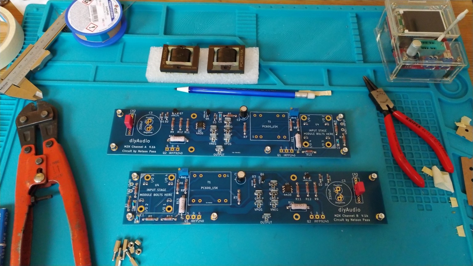

Few days ago i received my M2x boards. Feels like christmas! This will be my first amp build.
I have found a big used heat sink. I made two halfes out of it, they measures 200mm x 330 mm, each weighs about 2,2 Kg. Hope that will be enough. PSU will be DIY Audio Universal PSU with some big 18000 uF caps and a 500VA toroid.
I will build Ishikawa DB while waiting for parts for the Mountain View DB.
I have soldered the first bits on the mainboard today. Still waiting for mu metal foil to shield the Edcors before soldering them.
Looking forward for the next few weekends of soldering. Thanks to everyone who made this project possible.
