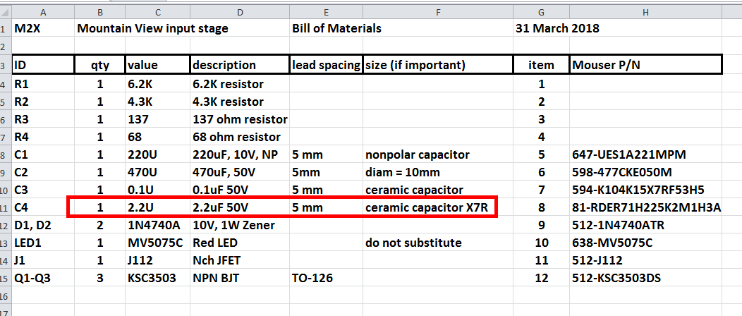

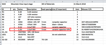

Either one will work; nonpolar/polarized are both good. You might have some 2.2uF CERAMIC caps lying around from previous IPS daughter card builds; those would be fine too. In this circuit the caps are just bypass & smoothers. It's a DC circuit and they're not working very hard.
It takes an extra 2 seconds to edit the schematic and change the displayed symbol from one to the other. I needed those 2 seconds for other purposes.
Here is what I attached to post #3377 ; click to remove the image distortion

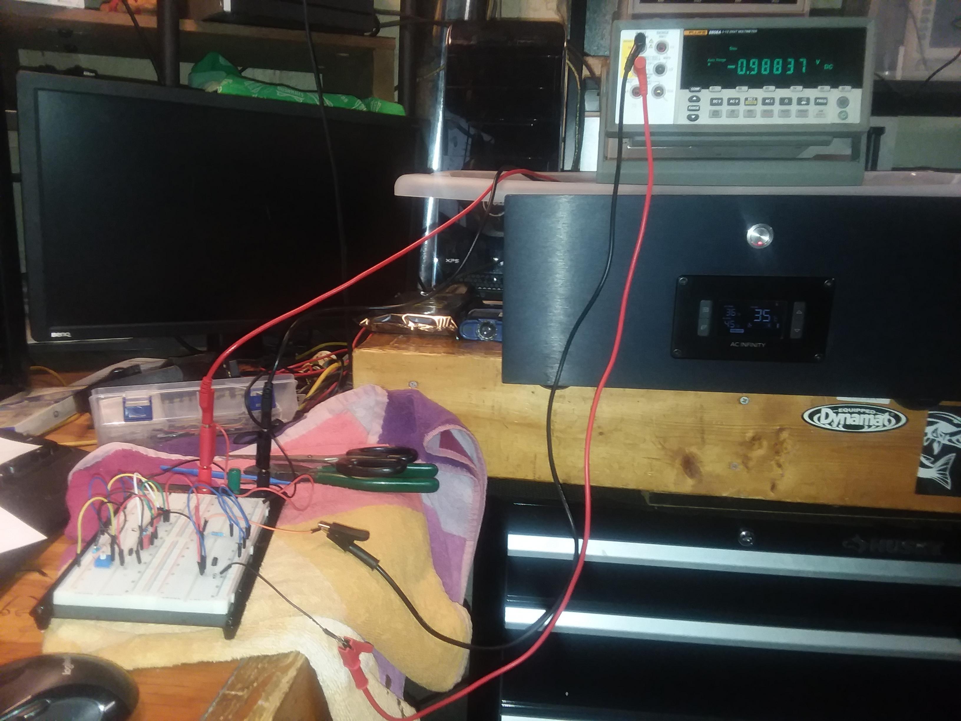

I got the boards from Mark today (Thanks buddy!) and boarded the jig. I ran through 72 of the 100 J113s, before my butt went numb and my patients ran out. I haven't pulled my pairs yet, or really looked them over, but I'd say that the spread was very much like what Mark was seeing... mine seemed to be a bit tighter than some of his, but overall I'd say well worth the effort.
Here's the jig and some of the parts.

these are most definitely NOT japanese fets but don't let perfect be the enemy of good enough. There are a few pairs in there.

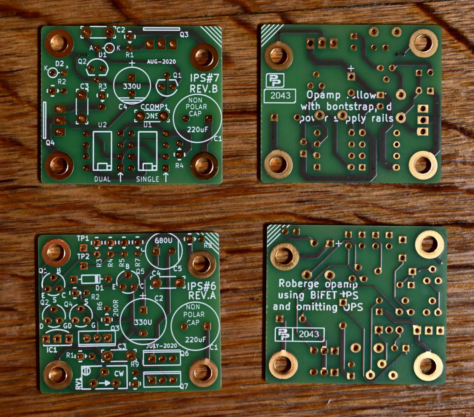

I got a small batch of IPS6 and IPS7 PCBs today.
I have 5 pairs or each I can sent out to other DIY members in Europe if anybody interested.
Also if you want an extra pair of of Tucson I have some left from Mike's group buy some time ago.
