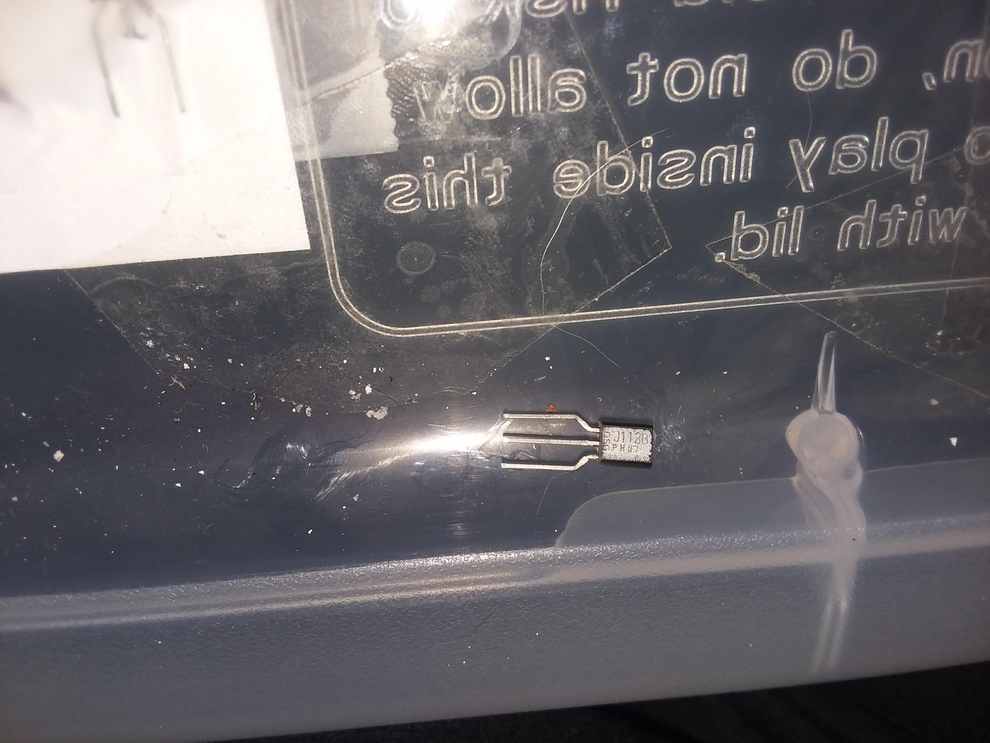

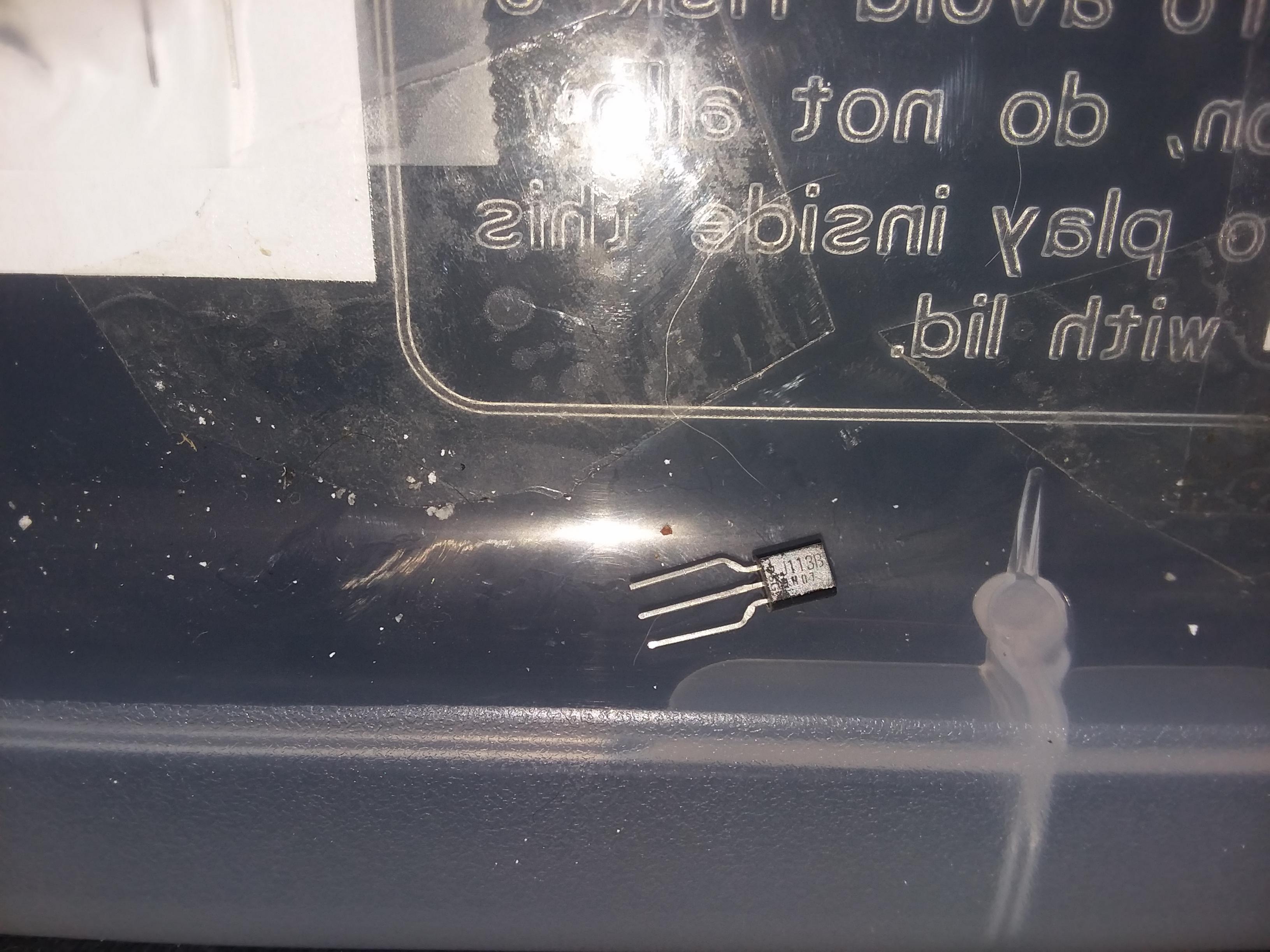

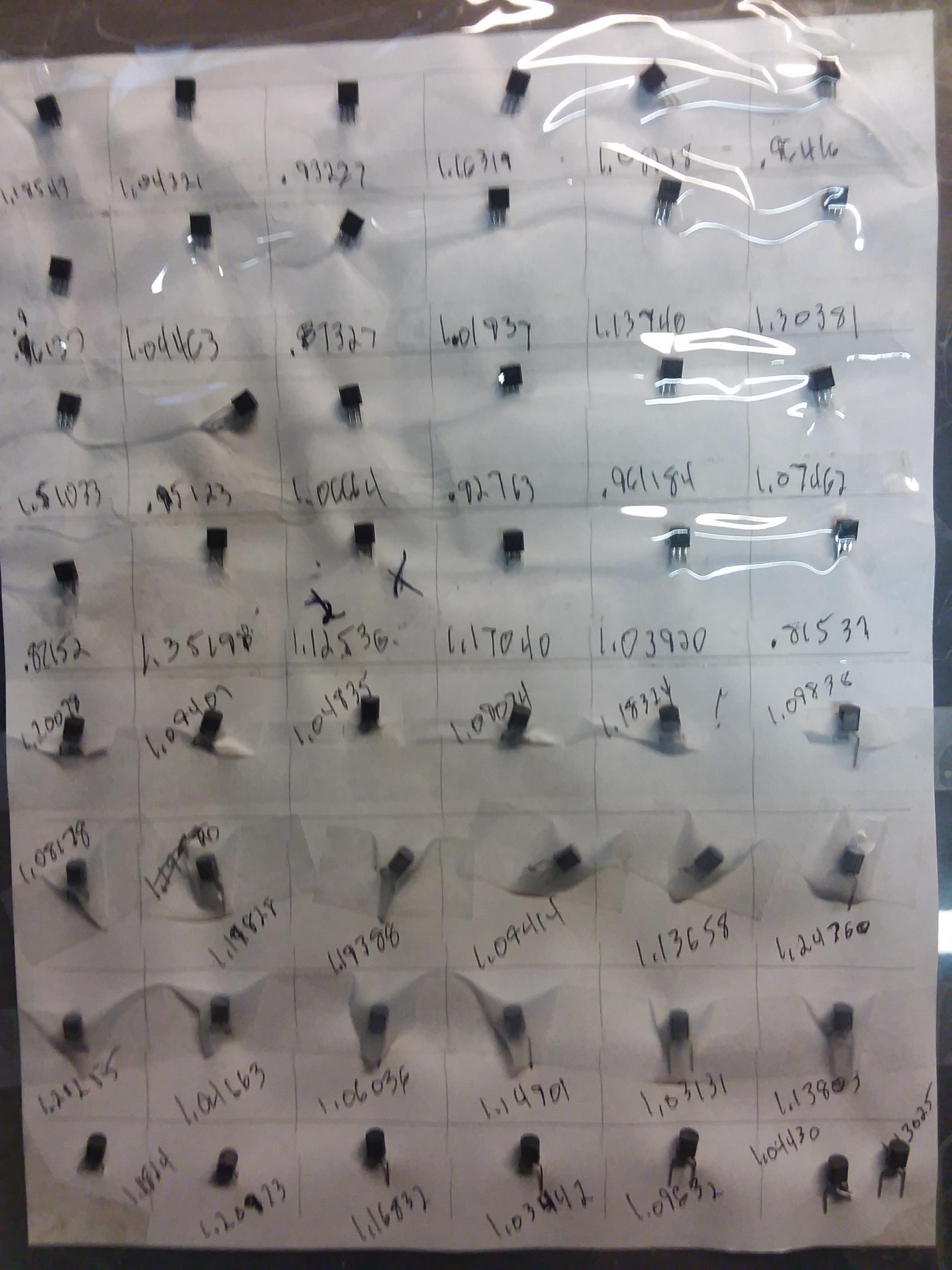

J113 N Fairchild vs Phillips
OKay same jig same power supply same meter. Same same same.
I bought 25 J113 Phillips to see how the matched up to the ON/Fairchild I bought from Mouser.
The Phillips were obtained through a vendor I trust on ebay cost $12. .48 per device.
First 6 rows ON second 6 rows Phillips.
Thoughts, the Phillips are all a lot closer overall. One other thing I noticed was that the Phillips took way longer to settle. A lot of the ON were pretty stable after only 15secs. Almost none of the Phillips were they were climbing pretty good for a minute or so. I took the initial values at 15 secs. What I found typical was someting that looked like this 1.20000 (15sec) 1.201XX (30 secs to 1min)
I understood... I have some Phillips on the way, I'll jig them and post those numbers too.

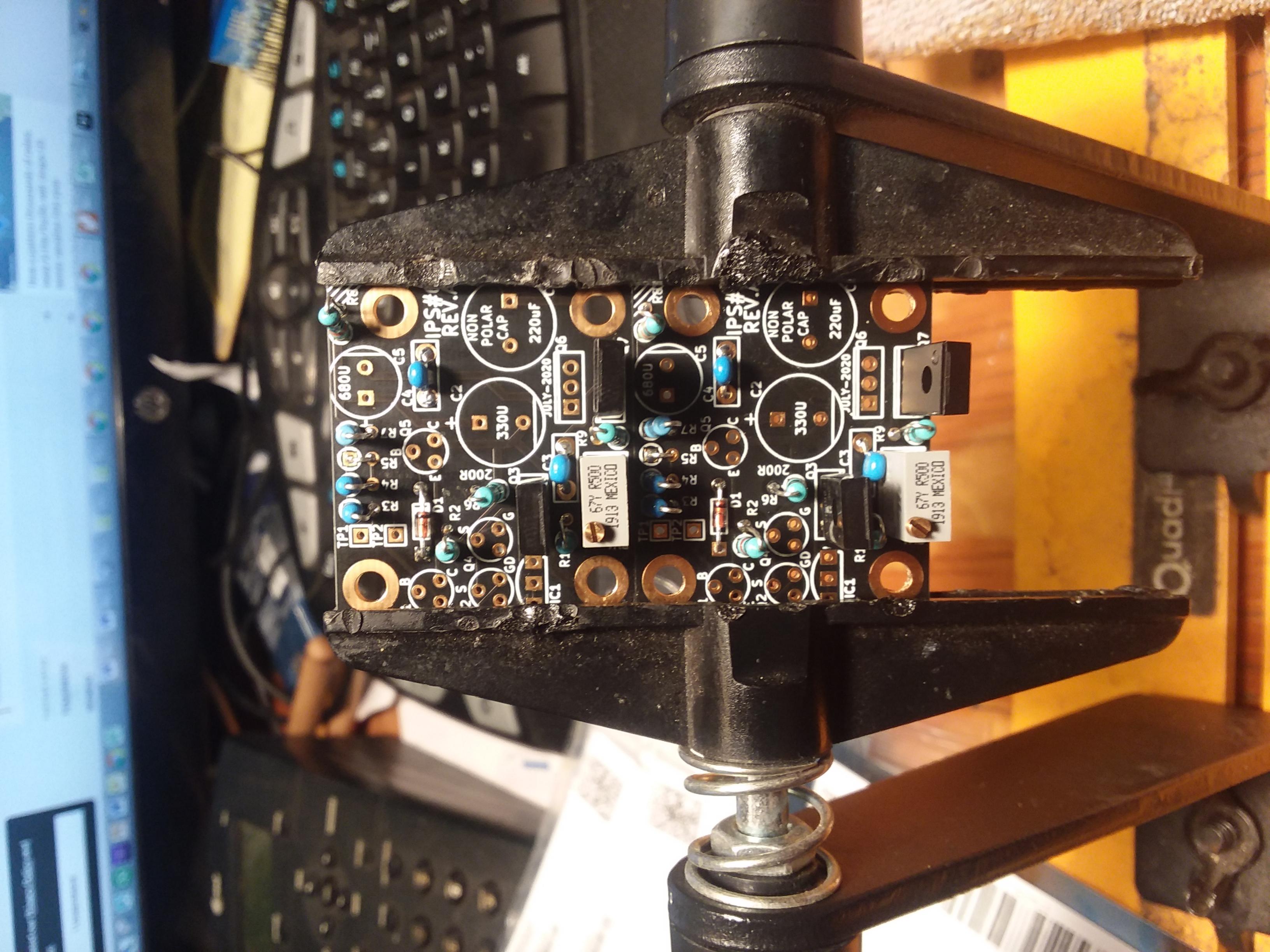

Switched to Austins and had no sound from one board. I think I found the issue, unfortunately it took out pretty much all the BJTs.
No smoke or pops, just nothing. I pulled the board and went over the soldering first cause it's a very busy board. I found what looked like a tin whisker, that appeared to be short IC1. A few of the SCs looked to be reading okay, but since they are cheap, I'm going to go ahead and replace them all.
Funny thing, when I power down, I hear music just for a sec or so as it bleeds down.
Okay guys and gals... I finally got around to pulling the parts on the Austin and doing a board repair. To be sure, I decided to replace all transistors and the regulators. I was pretty sure what was bad, but I figured I didn't want to to a chance of taking something else out, so I just did them all.
That is one little busy *** board to remove parts and clear the holes. I took my time removed all the solder, placed the new parts, double triple and then checked again. I soldered everything up and dropped the board in the MX and hit the power switch. A loud snap followed by a green cap flying in the air.... no just kidding.
Now I can let them run in and go to work on Mark's boards. So, it's on to the IP boards Mark.
