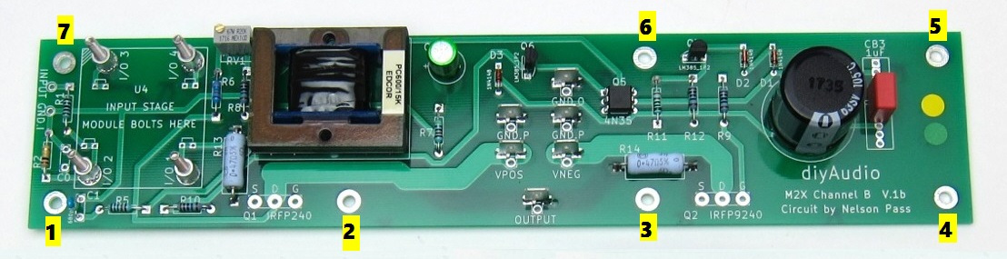

Here's what the daughter cards look like. Size is 40mm x 35mm, bolts are metric M3. Centers of bolt holes are inset 4mm from edge, except pin #3 which is intentionally asymmetric. This makes it very very difficult to install the card in a wrong orientation. (Nothing is impossible if you have a big enough hammer).
Leave some extra copper surrounding the bolt hole, where the star washer and the hex nut will go. Especially if your daughter card is simple with very few components, there's no reason not to have big surrounds and big clearances to neighboring traces.

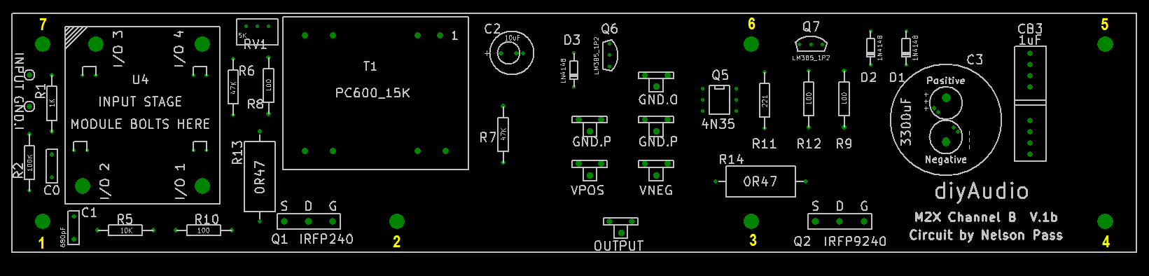

Green == drill holes
White == Front side silkscreen
