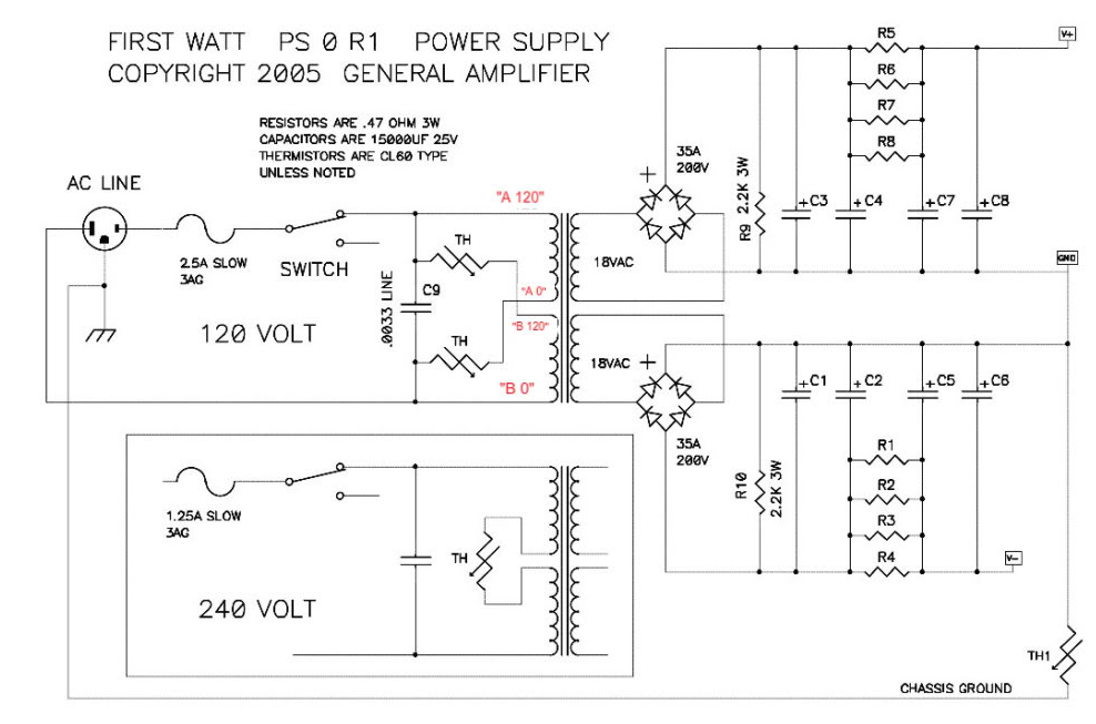

Even with the CL60 inrush current limiter(s) in the standard First Watt power supply, the DC voltage rails reach their final value (plus and minus 25 volts) quickly. However, over on the M2x amplifier PCB: it takes a very long time for resistors R6 and R7 to charge up the enormous capacitor C3.
Because the output transistors Q1 and Q2 have very little VGS, they are both OFF. Thus no current flows into the LED side of the optoisolator Q5, and no current flows in the output transistor side of Q5 either. R6 and R7 are charging C3 while the optoisolator is completely shut off. Eventually the voltage across C3 grows large enough to turn on both output transistors, and then the negative feedback control system wakes up and sets the bias current. Just as Nelson Pass drew it up.

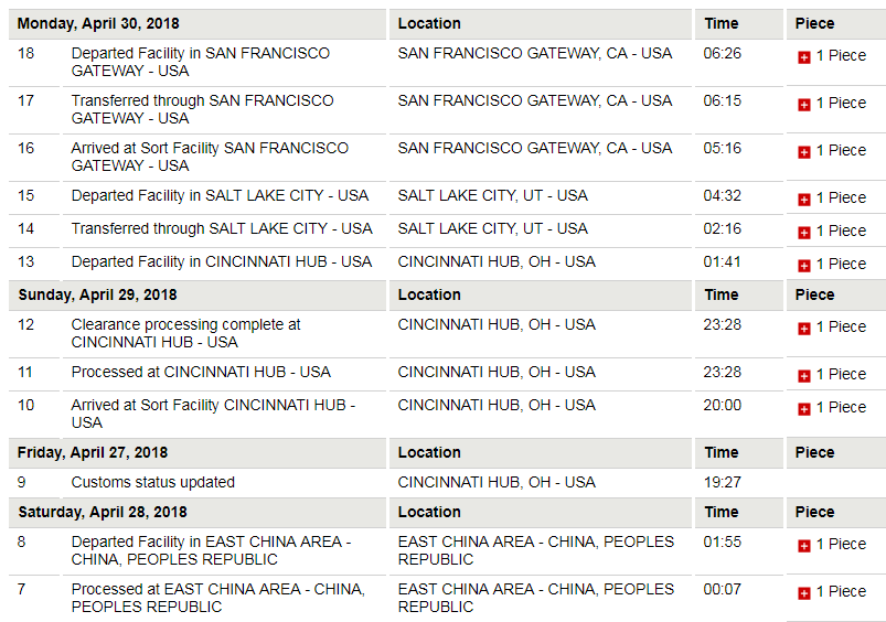

PCBs for a skunkworks project (see 6L6's remarks in post #2 above) had a very busy weekend. According to DHL, these boards flew from China to Ohio, changed planes, flew to Utah, changed planes again, and then flew to San Francisco. They must be exhausted by now. When they arrive at my lab in Silicon Valley this afternoon, I'll give them a good long rest before we start working.

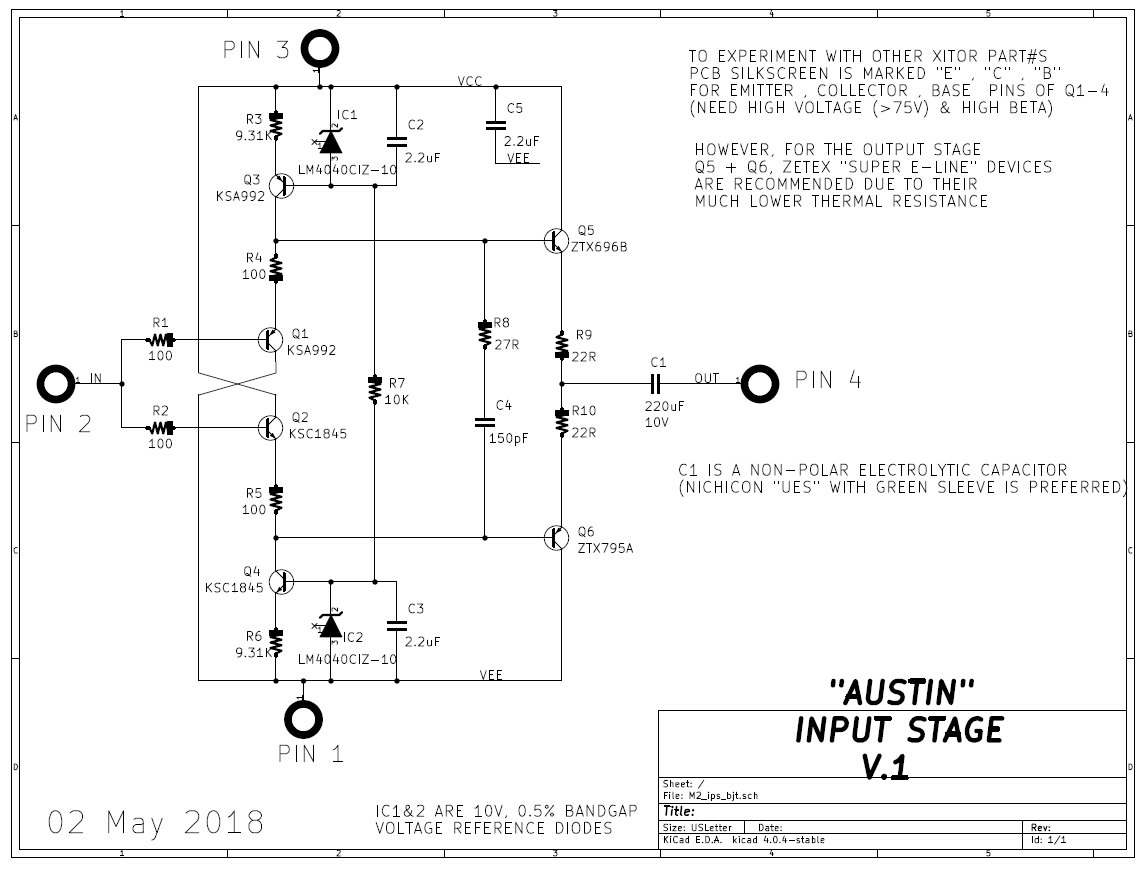

Here is the fifth M2x input stage, named "Austin" for Motorola's fab.
Austin turns out to be kind of a misnomer because, at the eleventh hour, I yanked out the Motorola input transistors and replaced them with (gasp!) Fairchild devices. But we've already got a Fairchild input stage board, and besides, Austin is a pretty cool city. So the name stays.
The circuit is usually called a "Diamond Buffer" since Q1, Q2, Q5, and Q6 roughly form a diamond shape on the schematic. Diamond buffers are frequently used in audio circuits and there are quite a few threads here on diyAudio about them. Bob Cordell's textbook discusses Diamond circuits in section 10.4, for example.
Transistors Q1 and Q2 operate as emitter followers, with Q3 and Q4 providing current source loads. Q5 and Q6 are another pair of emitter followers, which drive the output.
I've used relatively high precision "C-grade" (0.5%) IC voltage references, to get precise control of the emitter currents of Q1 and Q2. Don't worry, they cost less than a dollar each. Precise emitter currents establish precise base-overdrive voltages thanks to 1% resistors R4 and R5. The precise base-overdrive, plus 1% resistors R9 and R10, establishes a solid and fixed bias current in the output stage.
I'll see if I can upload the Austin schematic, and its Bill Of Materials, into the .zip archive attached to post #1. However, don't expect immediate miracles!
BTW-- If you've got access to some New Old Stock of Motorola MPS8099 and MPS8599 transistors, they'd work great in this board. But right now they're only available in surface mount packages, not TO-92s.

For those who hate, hate, hate Adobe Acrobat, here's the Austin schematic as an embedded image file. Click once to get rid of the obvious foreshortening distortion, and click again on the white "X" at bottom left, to see it full size.
