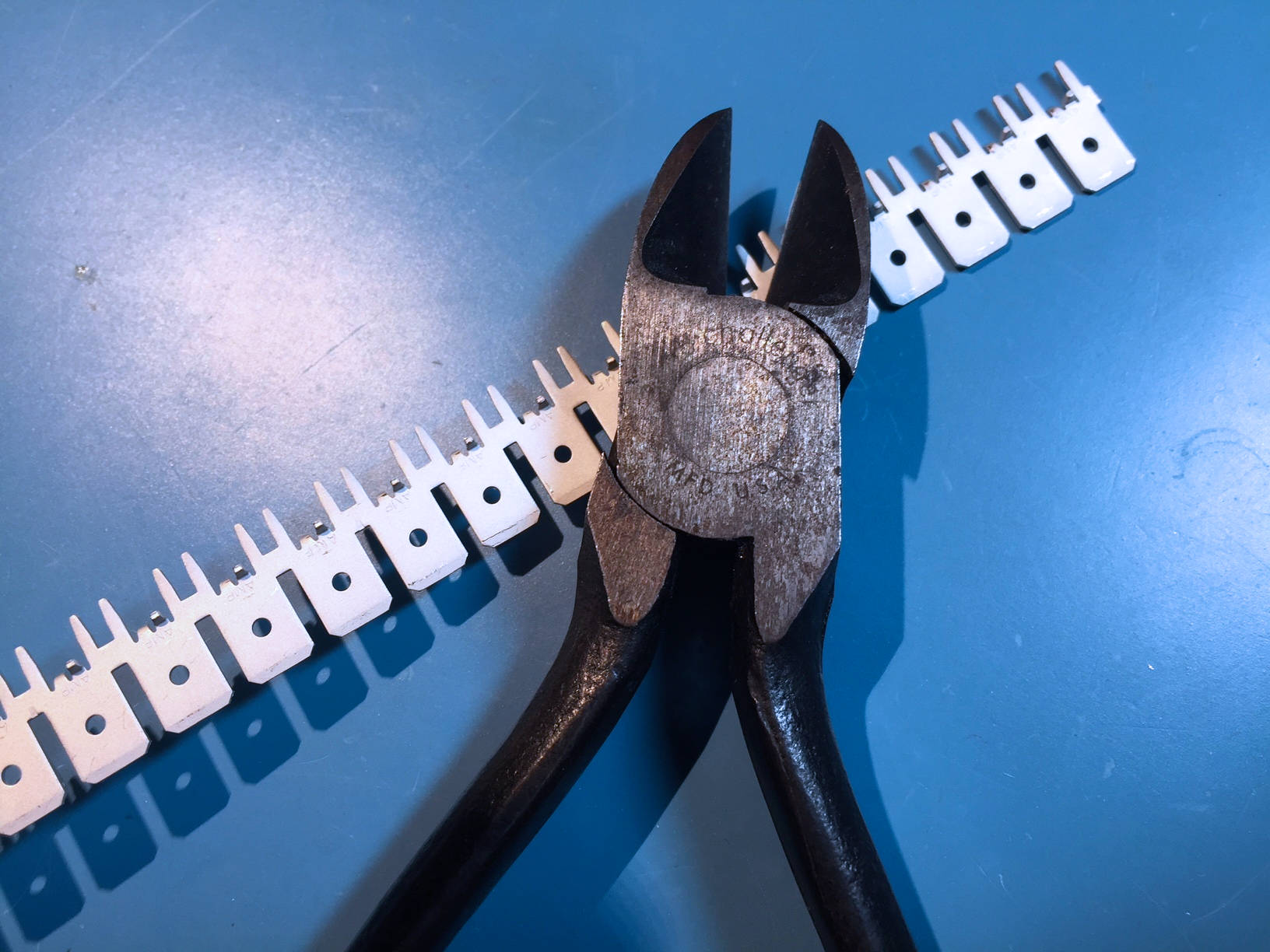

Examples of the items mentioned in post #3, section 1:
Possibly useful examples of low price & unknown quality M3 fasteners
- Reel of blade connectors and large "dykes" side cutting pliers: see Figure 1 below
