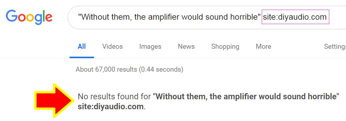

R13 and R14 are local feedback resistors. Without them, the amplifier would sound horrible, or be unstable (thermally) or both. In the front end, R3 and R4 are also local, degenerative feedback resistors.
In relation to the M2 R1 cct diagram.
Google Advanced Search:
_
attachment.php
I guess you could try again in a couple days to see if their Web Crawlers found something.

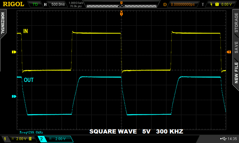

I ran a large signal pulse response test on a Norwood board this afternoon, using a 300 kHz, 5V square wave input signal. The output waveshape was exactly as shown in Analog Devices' datasheet, which is expected but also comforting. This thing is fast. Which means, its bandwidth is high. Which means, in a single-pole rolloff, NFB circuit such as Norwood, there is tons and tons of feedback at high frequency, giving tons and tons of distortion reduction.
But how does it SOUND? There have already been a couple of listening evaluations posted here, if I recall correctly. Google Advanced Search might accelerate a hunt for them. When the 15 stereo pairs of assembled and tested Norwood boards are shipped to buyers, in February, I imagine there will be more reviews / listening evaluations posted.

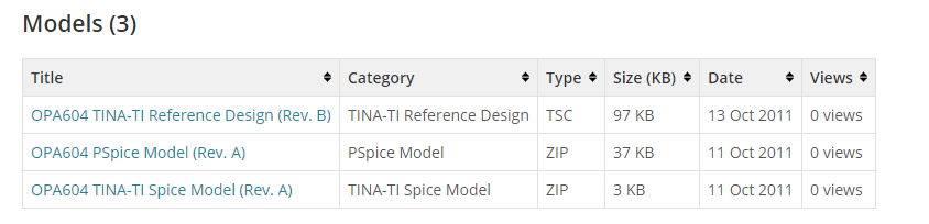

The output impedance of an unmodified Tucson board would not be difficult for curious experimenters to obtain, since TI provides simulation models of the OPA604 opamp used in Tucson. I think you'll be surprised and delighted with the number you extract; Tucson's unity gain connection (100% negative feedback!) has quite an effect upon output impedance. Just as the textbooks predict.
