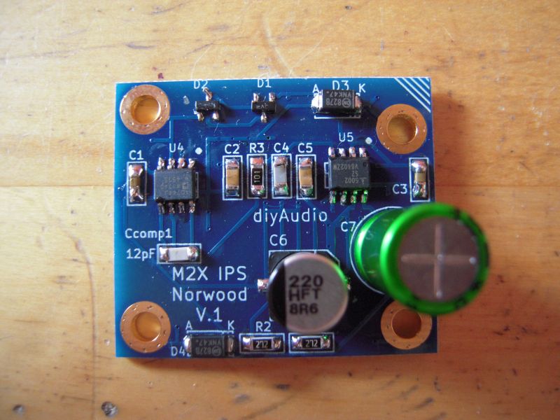

Hello M2X-builders,
today I put out the NORWOOD-boards for a second inspection.
I checked the orientation of the OPAmp / BufferAmp, You can see on the
foto that the points at PIN1 of each OPAmp correspond with the points on the
pcb (U4 and U5).
I checked the Diodes orientation: D1 and D2 can't be turned around (3 pins) or
would not fit; upsidedown - impossible, pins would be in the air.
D3 and D4 Kathodeline on the part corresponds with the line and 'K' on the
board.
I also checked the resistors. Am I blinded?
Greets Dirk

Cubicincher, I looked at your photo and it doesn't seem to show any obvious errors. Both zener diodes are oriented correctly. The two SOIC-8 integrated circuits are oriented correctly and they aren't swapped. The electrolytic capacitor is oriented correctly.
I find that hand-soldered SMD boards usually have "open circuit" faults more often than any other kind of mistake. You attempted to solder pin N onto landing pad P however a connection was not made -- it is an unintentional open circuit.
One way to check for this is to use a Digital Volt Meter on ContinuityTest ("buzzer") mode. Probe only the metal legs of electronic components -- don't probe the solder or the PCB traces. If the metal leg of U4 pin 2, shows continuity to the metal leg of U5 pin 8, then you can be certain that both chips are correctly soldered to the PCB and there is not an open circuit anywhere in that current path. Continue this way for the rest of the board. I myself just built 30 Norwood boards by hand, and buzzed out every trace on every board. Once you get proficient it only takes 5 minutes per board. For you, not yet proficient, it will take 10 minutes. So what, no problem, you've got 10 minutes.
Finally, if you give up completely, I will test and repair Norwood boards for free, but YOU pay the cost of postage in both directions. The US-to-Europe postage costs USD 15, I have no idea what the Europe-to-US postage costs. Norwood and only Norwood.
Dirk,
Assuming no errors on the PCB,
The next question is "did you make a wiring error in the daughter card selector switch?"
Could you place Norwood in a position currently occupied by Austin or Mountain View? It may be a safe assumption to say that either of those positions work properly.

Thanks Mark Johnson, 6L6 for your help!
I don't give up!
I will measure through the boards tomorrow again. I have this phenomena
on both boards (left and right channel).
Then I put in the Tucson - boards today. Same runaway of offset.
I measured from the standoffs (switcherboard) to the mainboard
and did not find that there is no contact or any wires crossed.
Then I thought: Could this be affected by the length of the cables from
switcher board to the mainboard. I read a lot, that OPAmps can be sensitive
to bad routing of pcb traces or
in my case - long cables? perhaps?
I will find the reason.

I fully agree with you MEPER. Logical conclusion.
That is why I thought of the length of the cables (main pcb to switcher/ inputboards) influencing anything.
But today I resolder the Norwood - board. I found 1 pin at the buffer-OPAmp
(and measured it) that seems to be suspicious.
I am cooking amplifiers - and I will never give up since the 'meal is served'!
Thanks for your help!
Greetings from Dirk

Re-soldering pin 1 of a chip on a Norwood board, is not expected to correct the problem mentioned here:
