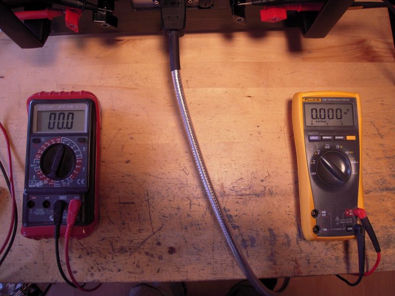

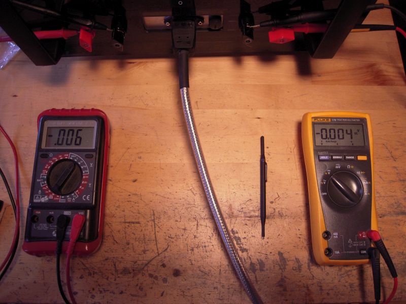

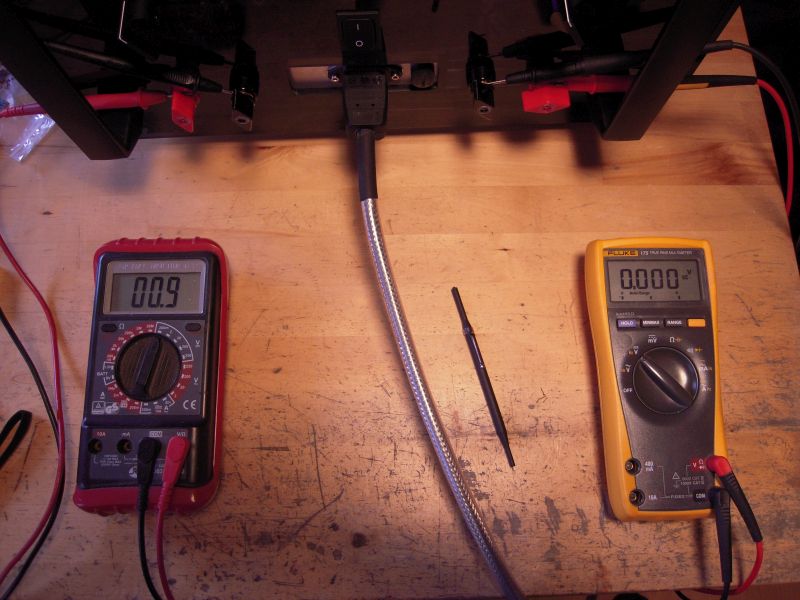

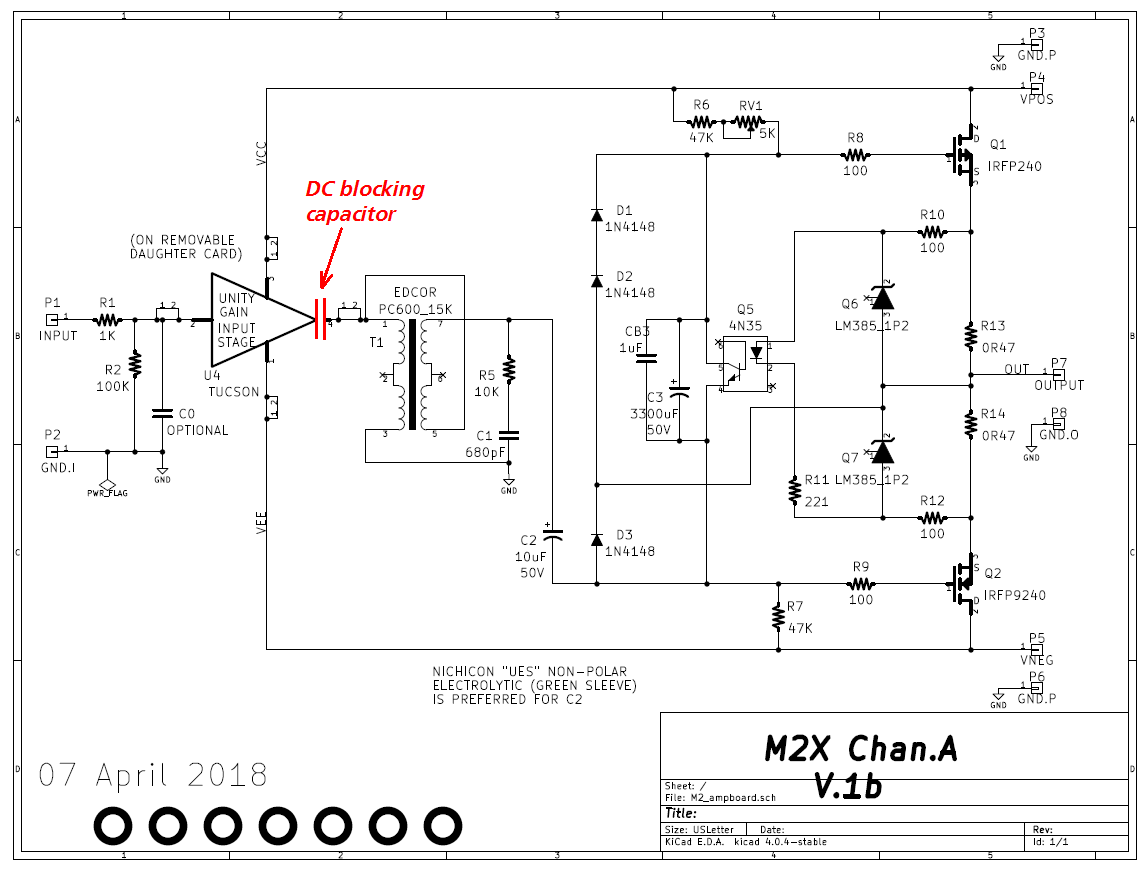

I had a problem with my loudspeaker offset. When I was turning down RV1
to 0 ohm I had an offset on the output around - 44mV to - 50mV.
I followed the 'blasphemous heresy'-way of 6L6 and changed R6 to 37.4 kohm
and RV1 to a 20kohm trimpot. Then it was easy to adjust the M2X.
Some pics taken in short time (all few seconds). It is fluctuating a little bit.
But that is normal.
Greetings
Dirk

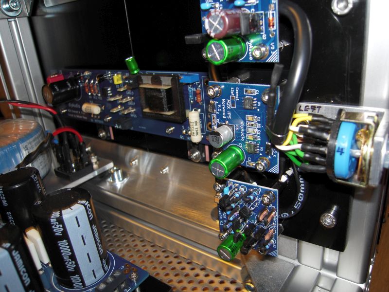

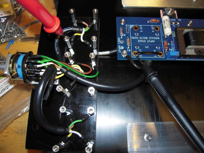

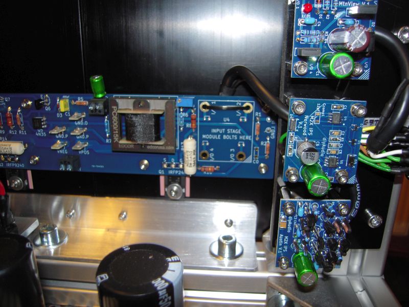

M2X experience
I made an switchable input for the inputboards. Then I tested the loudspeaker
offset with the different boards (at the moment AUSTIN / NORWOOD /
MOUNTAIN VIEW).
AUSTIN and MOUNTAIN VIEW behaved very similar (extremely low offset /
most often below 1mV).
NORWOOD let my offset run away. It run very fast to more than 150mV at
the speaker outputs. So I did an emergency shutdown. No smoke. All is o.K..
But I have to check for the reason.
Hallelujah!
Dirk

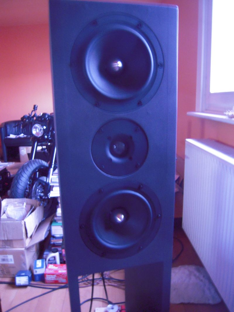

My test setup for the first round of listening:
PRIMARE CD - player and
MUSICSERVER (all in flac)
Preamp: PASS BA-3
Amp: M2X
Loudspeaker: self construction - 2 -way d'appolito
tweeter: 30mm silk dome
bass/mid: 6inch with phase plug (2 each)
passive crossover with lots of MUNDORF-parts
first impressions are very promising! Nothing to complain about yet.
Will take some time to listen and to write all down.
I'll be back! :cheers:
Thanks to Mark Johnson, 6L6, Nelson Pass and everybody else who
was involved.
Dirk

The R6, RV1 change to 37.4 k, 20k if DC offset can not be zeroed using original values….can I do something up front to verity if I need original or modified values?
Has it something to do with matching the output FETs as a pair?
Is there a post # which is good to read?

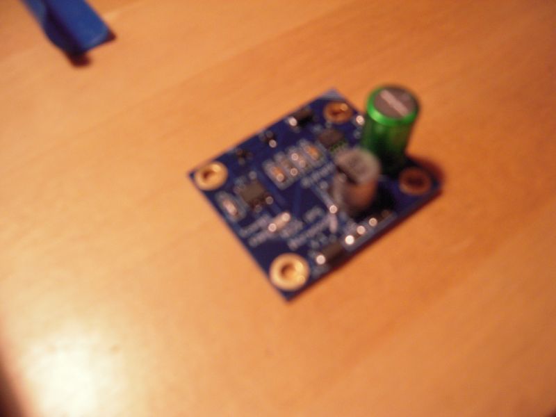

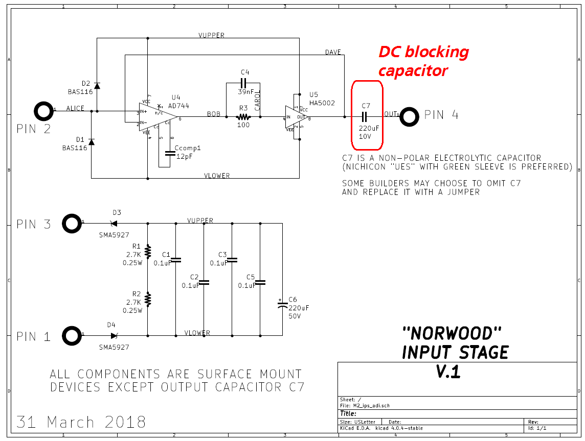

If everything is assembled correctly, the green nonpolar electrolytic capacitors on the input daughter cards {visible in the photo of post #1329}, guarantee that every daughter card has the same impact upon offset voltage. And that impact is: zero. There is no circuit pathway for the daughter card to have any effect; the DC blocking capacitor prevents this. Swapping daughter cards should have no effect upon offset at the speaker termianls.
It leads me to wonder whether perhaps your Norwood boards might contain some kind of mistake, such as a poor soldering joint, two components accidentally interchanged, a component accidentally installed backwards, or something like that.
_
Max - not a lot to do beforehand to see if you'll need the additional adjustment, but I see no logical reason to not make the change as suggested by Mark.
Post #3 has the specific information, the "Blasphemous Heresy" comment is merely humor, as it's a change to Nelson's original circuit, however small.
If you haven't yet read all the linked documents in posts #1, 2, 3 & 4 I suggest you do, it's very interesting stuff as well as has essentially all the information you'll need to understand the amp and the various daughterboards.

answer to Mark Johnson #1333
Hello Mark Johnson,
I only wanted to describe what happened. Your boards and the build guide is absolutely perfect!
If anybody is not perfect - than me myself.
I added the missing Ccap last night on both boards. I also rechecked the whole
board for shorts and so on. But it was very late.
I will do a check again of the Norwood.
The amp sounds wonderful!
Thanks for your patience and understanding!
Greets
Dirk
M2X experience
Hello members,
after a few hours of listening and many kinds of music (through rock-history - can't write down all),
some Jazz:
Marcus Miller: Afrodeezia - Papa was a rolling stone
Flim + the BB's: Tricycle - Tricycle
Siggi Schwab+Percussion Academia: Rondo a tre - Kassensturz
some classic:
Karl Richter: J.S.Bach - Toccata and Fuge
I can say, that I have a slight tendency to prefer the
MOUNTAIN VIEW board over the AUSTIN board.
But they both sound very very good!
Very detailed information, good dynamics, female and male voices sound
very natural, good bass and bass control. Good room information.
Only little minus for MOUNTAIN VIEW - more audible hum if music is off
Only first impressions. Yours can be different.
Good night!
Dirk
