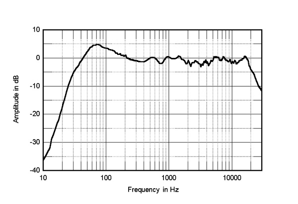

Let me give you an example from John Atkinson's measurements for Stereophile and not the following is very common:
![1019MAG300fig5.jpg](https://www.stereophile.com/images/1019MAG300fig5.jpg)
Here is his explanation:
"The trace below 300Hz shows the sum of the nearfield woofer and port outputs, taking into account acoustic phase and the different distance of each radiator from a nominal farfield microphone position. The rise in response in the upper bass is due almost entirely to the nearfield measurement technique, the Gold 300's reflex tuning being maximally flat." John Atkinson
So whenever you see this showing up in measurement, just be aware that the bum is exaggerated. But it looks like the port nearfield measurement is the problem, considering this is showing up at an even lower frequency.

I still don't understand the 150 Hz peak. I don't see how the proximity effect would be relevant here, as it does not happen with omni mics.
The Stereophile example is different. It shows a steady rise in the nearfied SPL response towards lower frequencies, until it reaches the bass cut off. This is the typical design approach taken in order to compensate the baffle step that occurs in the far field. This is different to the 150 Hz peak seen in the Elsinore curve.
Note that combining farfield measurements of the woofer and the port can be tricky, and merging them to the farfield curve is also not always straight forward. I therefore prefer the mic-in-box method, which directly yields the combined output of the woofer and the port, and it is easy to accurately convert its SPL level to the 2pi farfield.

It does happen with omni mics. There are heaps of measurements by John Atkinson's Stereophile and they are all done with omnis. I use omnis. I suggest you read JA's measurements on nearly a thousand loudspeakers for Stereophile and maybe all of them are online now? He refers to it quite often, also as to what mics he uses.
Below is an omni measurement of a Magico speaker:
![217MagS52fig2.jpg](https://www.stereophile.com/images/217MagS52fig2.jpg)
His comments:
"The impedance traces suggest that the sealed enclosure is tuned to 34Hz. The two woofers behave identically, and their summed output is shown as the green trace in fig.2. The crossover to the midrange unit (red trace) appears to be set at 300Hz, and the broad peak in the midbass will be almost entirely due to the nearfield measurement technique, which assumes a 2pi (half-spherical) acoustic environment for the drivers. This peak aside, the –6dB frequency is just below 30Hz, which means that with the slow, 12dB/octave rolloff below the tuning frequency that is typical of a sealed enclosure, and the typical amount of boundary reinforcement or "room gain," the S5 Mk.II's output will extend to 20Hz. The Magico's upper-frequency farfield output, averaged across a 30° horizontal window centered on the tweeter axis (fig.3, blue trace above 300Hz), is impressively even overall, though with slight depressions in the presence region and in the top octave before the ultrasonic peak, due to the tweeter's primary dome resonance. Note, however, that this resonance lies above the 30kHz limit of this graph.”
With a farfield measurement, also with an omni, the peak disappears with the same speaker:
![217MagS52fig5.jpg](https://www.stereophile.com/images/217MagS52fig5.jpg)
Only look at the RED trace, the other is another speaker entirely.
Re the Elsinore, the 150Hz peak also disappears with any farfield measurement using RTA 1/6th Octave with Pink Noise.
I am afraid it is what it is.

Like Joe says, Stereophile measures speakers with the built in XO’s, so the speaker XO would include corrections for bafflestep losses (usually a high shelf attenuation filter circa 800Hz to 1kHz or higher for typical 10in to 12in wide speaker baffles). I am not sure what you mean by “they did not include bafflestep”? 150Hz bump is way too low to be a bafflestep effect unless your baffle is like 3ft wide.
I have not experienced a proximity peak in my measurements, but I never am closer than 0.5m - probably where it’s no longer an issue.

I believe that now your are referring to the proximity effect, which is a low-frequency boost that happens with (directional!) pressure-gradient microphones. It does NOT happen with (omnidrectional) measurement microphones. See here: Proximity effect (audio - Wikipedia)
Note that the proximity effect creates a low-frequency boost, NOT a peak in the SPL curve.
I think what he means is that a nearfield mesurement does not see the bafflestep that happens when the box is in a room and you are far-field. As humans we do hear the bafflestep and that is typiclly 2-6 dB and where it happens will be somewhat dependent on the bffle width.
+1. And baffle step is something else than proximity effect.
