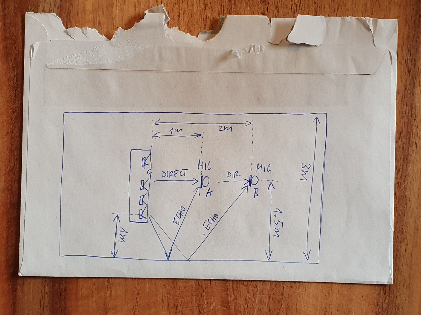

I agree, but with most speaker you don't need 100Hz, unless the speaker has a well over 1 metre wide baffle.
With a baffle width of 28 cm, the Elsinores will exhibit a baffle step that extends to well below 100 Hz. See Online Baffle Step Calculation to get an idea of the shape of the baffle step.
But your point is well taken, this is why I use 2 metres for my main acoustic measurements, you can get reliable data down to a lower frequency and with the Elsinore width of 280mm. That way I had no problem seeing the diffraction loss with lowering frequency.
Unfortunately, it does not work this way. It's actually the opposite. If you move the microphone further away, the anechoic part of the impulse response gets shorter. Consider this back-of-the envelope calculation (see attached drawing):
  • (A) Microphone at 1 m from baffle: The direct sound arrives at the microphone after a "flight time" of 2.9 ms (1 m flight time). The distance travelled by the floor echo is 2.69 m (Pythagoras is your friend), which corresponds to a flight time of 7.8 ms. The anechoic data between first arrival of the direct sound and the arrival of the floor echo is therefore 4.9 ms long, which corresponds to a lower cut-off of 204 Hz (this is also the FFT resolution).
  • (B) Microphone at 2 m from baffle: The direct sound arrives at the microphone after a "flight time" of 5.8 ms, whereas the floor echo arrives at 9.3 ms (same math as above, with different numbers). The anechoic part of the impulse response is therefore only 3.5 ms long, which corresponds to a lower cut-off (and FFT resolution) of 286 Hz only.
But later, with in-room RTA type measurements, you will be able to confirm if you got it right
Depends on what you mean by "it". The in-room RTA measurement mostly shows how the speaker interacts with the room. It will not show the baffle step curve, and it will not show what is going on with the 150 Hz peak in the farfield. You need an anechoic measurement for this.
Joe, I guess what I am trying to say is that you'd need meaningful measurements to back your claims about the low-frequency bahaviour of the Elsinores. You need a 20 ms long anechoic impulse response recorded in the farfield. You could get such data in a (very) large room or outdoors. This might be a bit of work, but it would clear up the "expert judgement" fog and you'd make sure to avoid the issues that Joe d'Appolito had with the Thor loudspeakers. If you think this is too much work (I would!), it would be better to say that you don't have the measurements -- no harm done!
