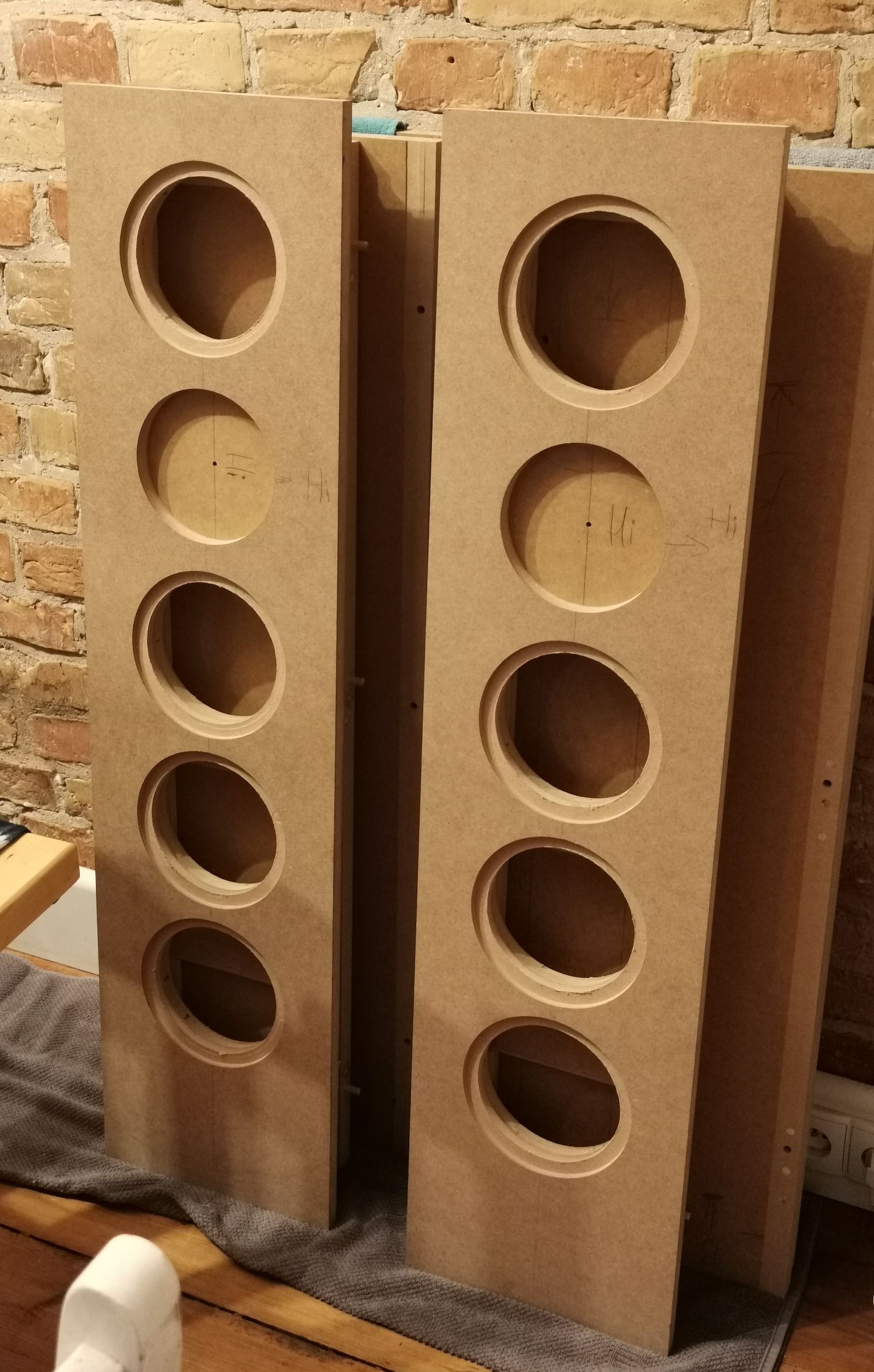

I have been working on the Joe project in my free time since the beginning of January. Waveguide reached Poland very quickly. I know that my friend is also waiting for them, which means that a second set of Elsinore v.6 is being created in parallel.
Meanwhile, I'm getting closer to gluing the box. Greetings to all builders and those already enjoying the ready speakers.
