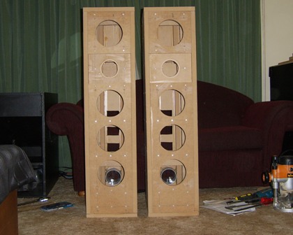

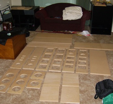

danieljw said:still waiting for drivers and crossover parts...
little bit of progres today though![]()
Your project looks great Daniel , I want to use the peerles HDS tweeter in the future because it must be very good sounding.
Go on with the good work
