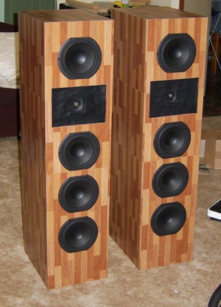

danieljw said:Finished Boxes
(Thanks for Rob, Helmuth, Tinitus and Obviously Joe's Advice)
Havent listened to them yet I am still building the crossovers.......
Will be a week or two because of work commitments...........
-Dan
WOW! They look really nice. Good work.

Hi danieljw, great work! Could you show me a closer pic of the felt around the tweeter? Is it felt?

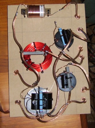

Finally got the Elsinores going,
The cross overs took me quite a long time to "knock up" they are
just zip tied to MDF at the moment I will probably put them in an enclosure much more neatly in the near future.
I ended up using:
Jaycar 9.0mH
Solen 1.0mH (measured 1.0003 mH@1kHz / 0.347 Ohms @ 100Hz)
Generic 1.8, 0.82 and 0.47 Inductors (all less than 0.5 Ohm DCR)
3.3uF Solen Polypropylene
10uF Solen Polypropylene
68uF Generic aluminium electrolytic (NP)
4.7uF Solen tin foil
10W MOX resistors 1-2% tolerance.
I measured all parts were correct prior to use.
I am really happy with the sound. highs are crystal clear, bass is very fast, clean and deep and they sound flat to 20Hz (in room) The bass/mid bass tones are really easy to differentiate there is no "boominess' or resonance which can sometimes be an issue with subwoofers designed more for SPL in a small user friendly package. I really like the speed and depth of the bass.
The tweeters (Peerless HDS) really are sweet, the highs are excellent, cymbal crashes are smooth, instrument picks are not lost, singers taking a breath etc etc i can hear things which were muddled in my other speakers i did not even know they were there.
Mids are also excellent they sound very natural... actually across the board they are hard to fault.
See attached pics of the prototype crossovers which have the footprint of A4 paper each.
-Dan
1 happy little vegemite.

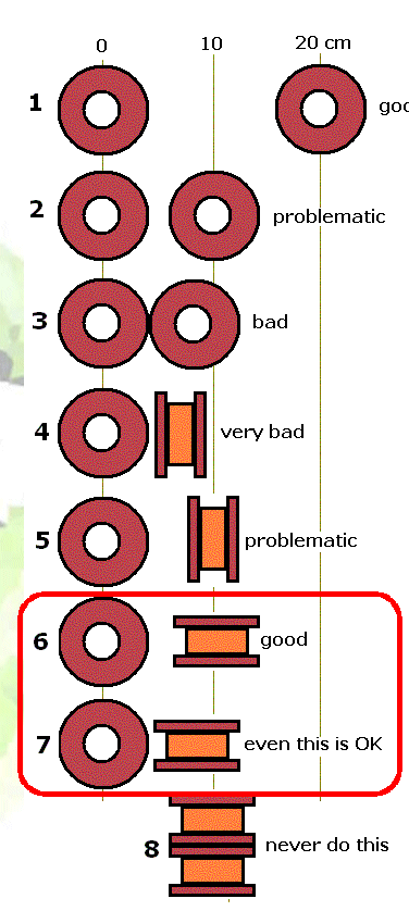

Hello Salas,
Thanks for the interesting link the info is useful.
The coils are placed approx 15cm apart.
I intend rebuild the crossover in a wooden box, with a neater layout.
Perhaps I will make it larger than first anticipated !!!!
one other thing, the rebuild will use solid core tinned copper wire and i think the caps will be "hot glued" or "siliconed" in place.
should be alot neater.
Despite the simplicity the crossovers are deceptively large !
-Dan
-Dan
-Dan
Well done Dan. Nice description of your first impressions, can I quote you?
Re the choke layout, the one numbered "6" in that link, is the most useful as it allows the most compact crossover. Even then a little space should be there. But chokes that have relative axis at 90 degrees is a good thing. See "6" and "7" below.
Joe R.
