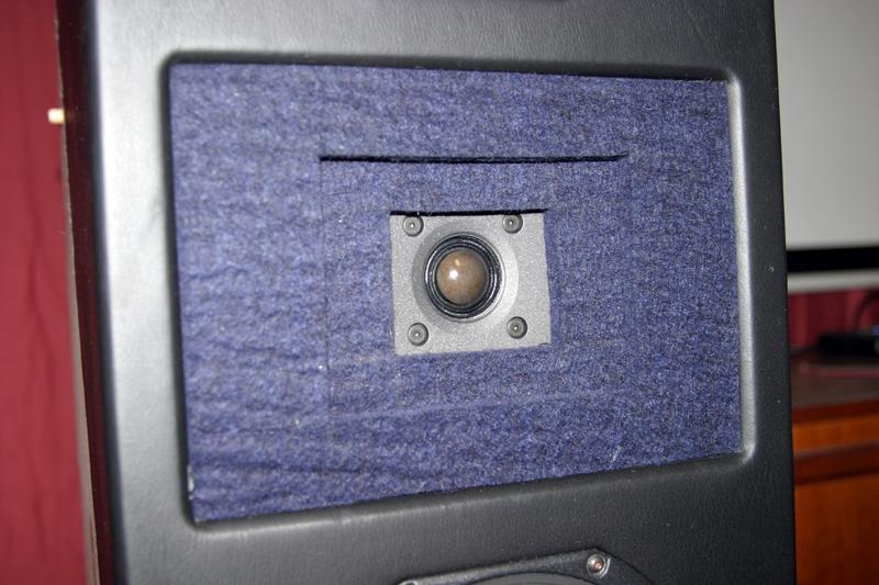

Are there different drawings for the tweeter waveguide as they apply to the HDS tweet or do the original drwings still get used?
Looks like you start with several layers of mdf and then make waveguide from built up felt, do you use autobody filler or something similar to make a smoothed waveguide surface first?
Ralph Johnsen said:Are there different drawings for the tweeter waveguide as they apply to the HDS tweet or do the original drwings still get used?
The current box construction drawings are definitely Mk3 (using HDS tweeter).
Some of the photos show Mk1 and Mk2. As it says clearly "The Photos below relate to older Mark 1 and Mark 2 versions".
Ignore the four-sided waveguide shown in these photos and use the Felt pieces instead, as shown at the bottom of customanalogue.com/elsinore/elsinore_4.htm.
The two Felt pieces simply sits inside the cavity that the tweeter is mounted - the tweeter needs to be flush mounted inside that acivity, so that the inner Felt piece fits flat, as shown at the bottom of customanalogue.com/elsinore/elsinore_index.htm.
Joe R.
OK don't mean to be thick, just ordered my drivers and will start cabs soon.
I copied the attached picture from a completed elsinore someone posted.
Is this the setup for the HDS tweet ?
Would it be better to have smooth transition rather than a couple of steps ? Would be easy to smooth out.
Yes, that is it. The felt used as shown in that pic came from me, to Rob (rob323 is Rob a Mazda guy?). Others who have done their own and could not get the same thickness of felt - around 8-9mm (although the manufacturer says it's supposed to be 6.3mm or somesuch). They have used three layers, even seen a four layer. But as you say, if it smooths it out a bit it will not likely be a problem. But avoid making the cutouts in the felt round, keep them square as show, just more layers with cutouts spread out. I don't think that will cause anything adverse. BTW, round cutouts tend to show up at the same frequency, square spreads it out, generally speaking.
Good news, sounds like you are on your way. Go for it!
