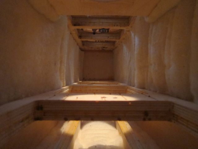

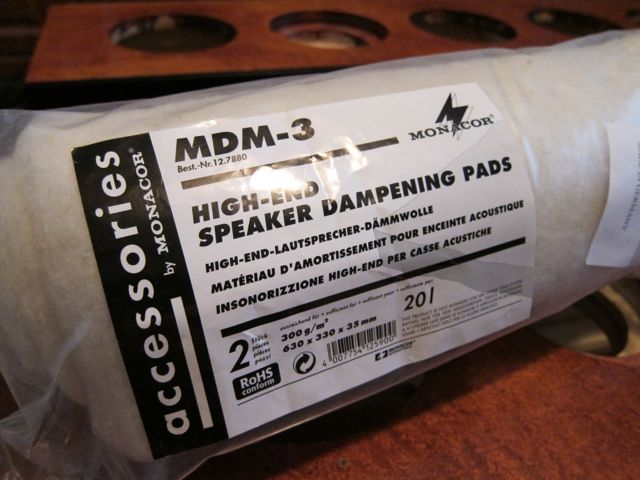

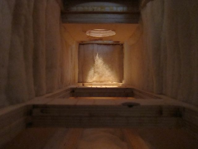

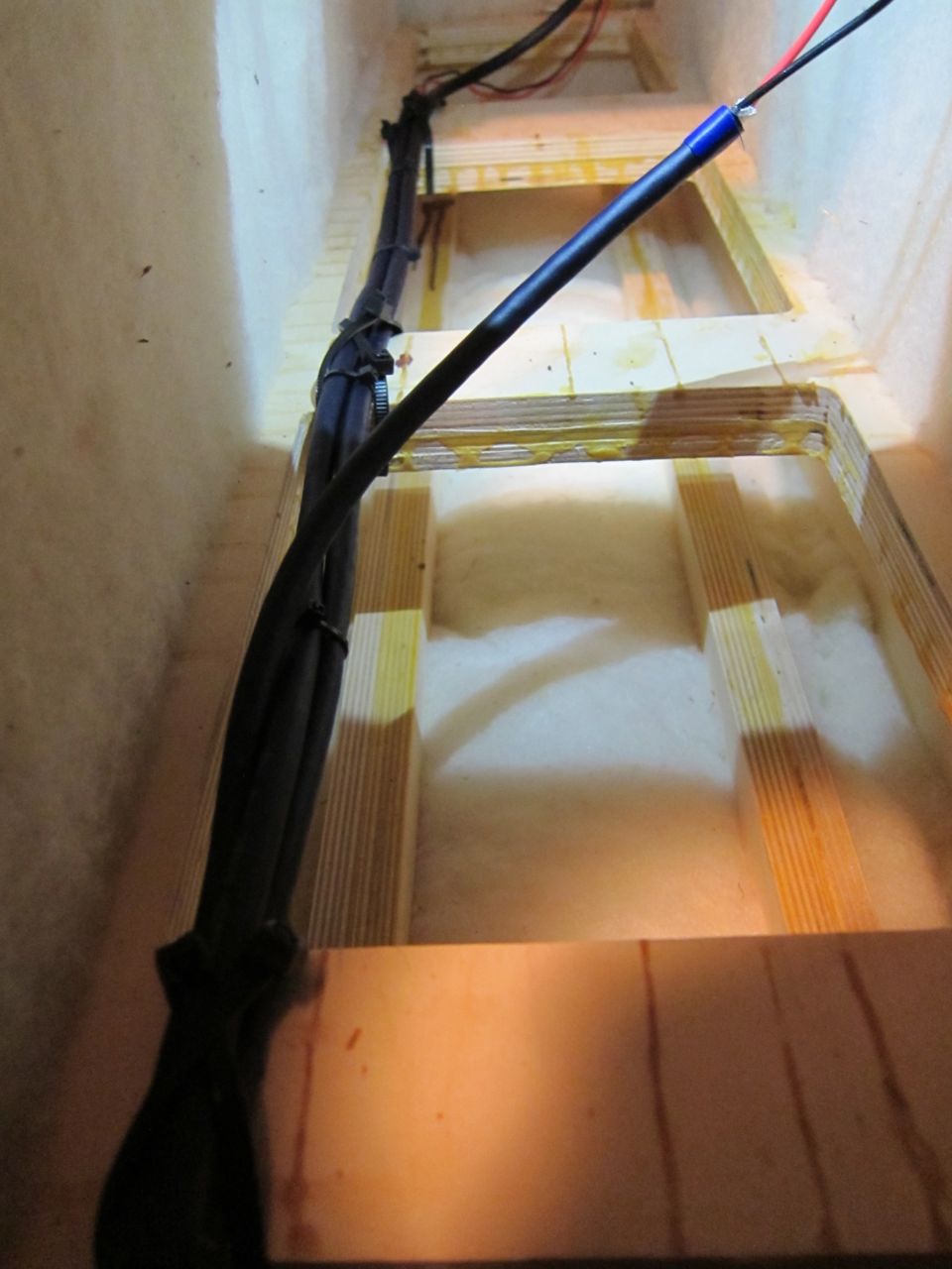

I finally installed the acoustic dampening fill. I ended up using the wool/poly blend rolls available from MCM electronics (Acoustic Dampening Pad | LS00916 | Distributed By MCM). If you catch them on one of their 25% off and free shipping deals, they are not too badly priced. Although, the price has seemed to go up significantly as of late. I bought a bunch of them a while back.
This material, while close to the right density blend, is a bit thicker than Joe used on his original build. So, I went with a single layer on the sides and a double layer on the back. I figured that was close enough to Joe's original specs and would provide a good starting point. I ended up using about 4 and 1/2 rolls of the material in total. Easy to work with, but, messy when cutting as the fine fibers seems to come off the cut into a dusting of material. In hindsight, I should have cut them outside.
Below are a couple internal shots of the finished installation. Time to move onto the wiring harness.
BTW, these things start to become very cumbersome to move around. They are currently weighing in at 72.8lbs a piece (~33.1kg). You can certainly build some muscle moving these around.

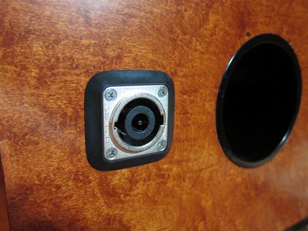

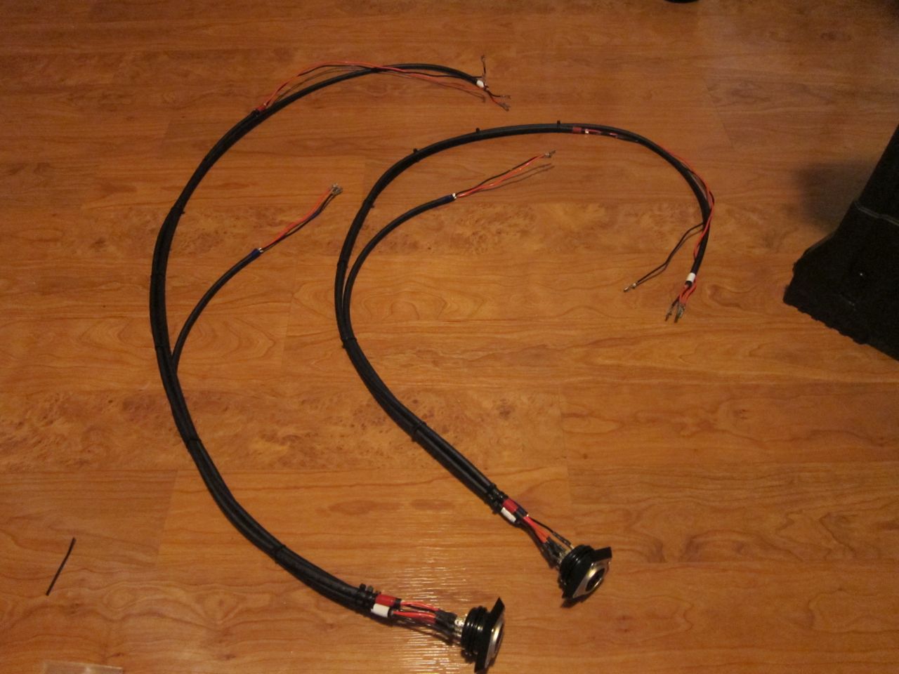

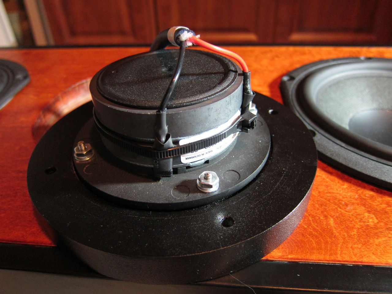

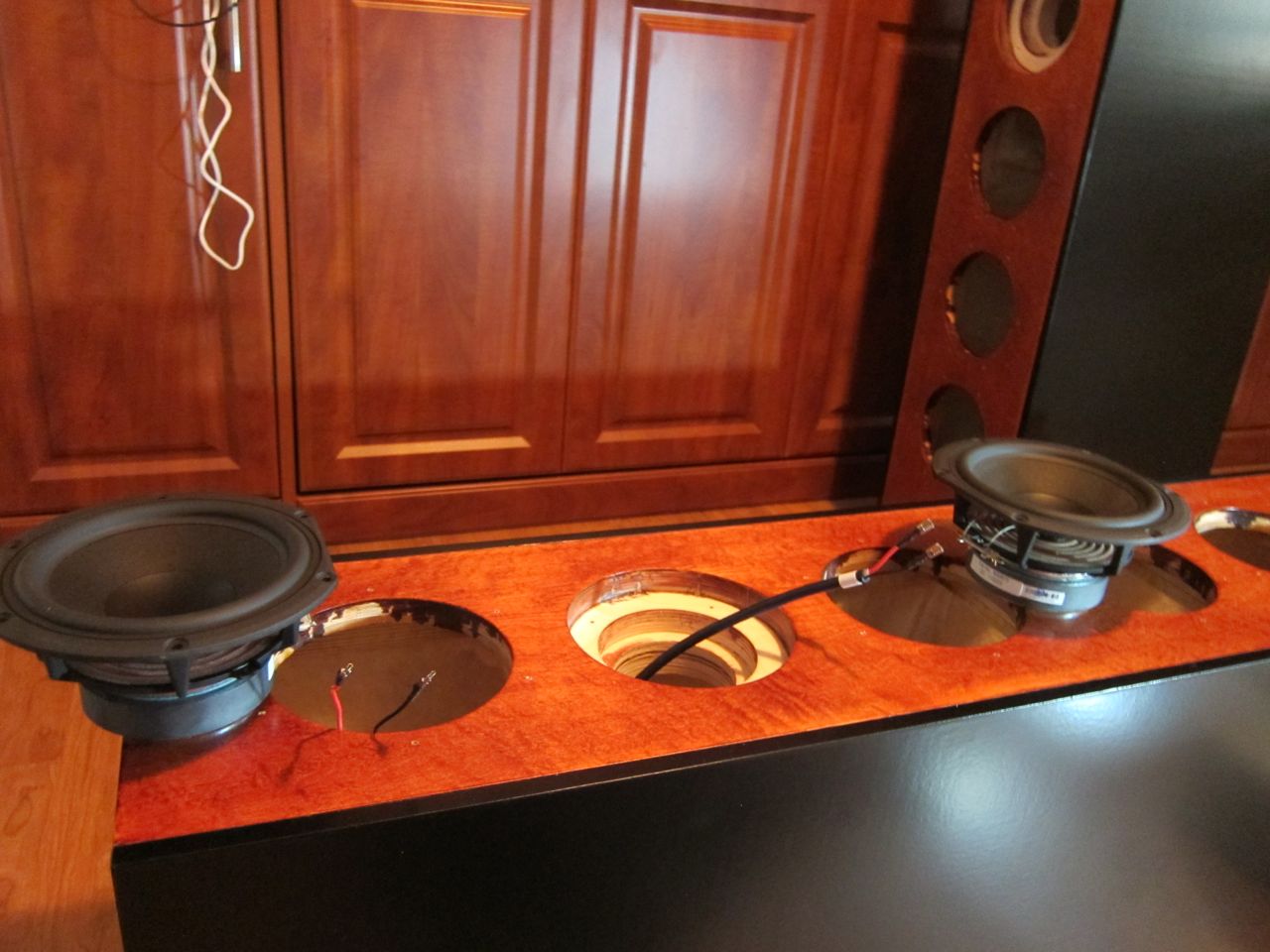

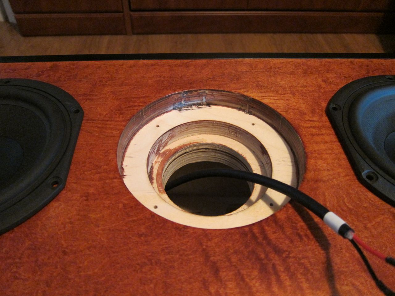

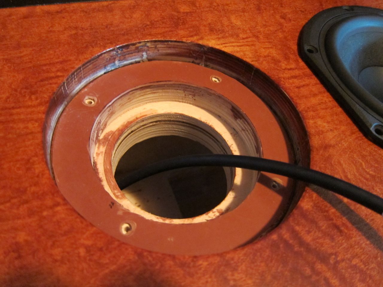

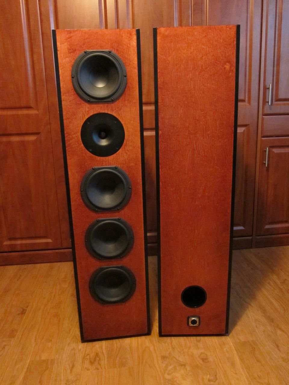

Wiring Harness completed and Drivers installed...
Put together the main wiring harness that ties into the speakON connector. The speakON spades fit one side of the peerless drivers perfectly (the positive side). The negative, not so much. A bit of "modification" and rework is needed to get a good mechanical grip on the small spade negative side of the drivers (same with the tweeter lugs) using the neutrik spades. In hind sight, I should have gotten the proper spade for those lugs. But, the neutrik spades were already installed and solder into the harness and I was able to get them to work just fine. It would be nice if this was a standard across all connectors. Perhaps it is, but, I was unaware of it if it was.
In any case, installed the drivers, screwed them down tight and also installed the neutrik jack. So far, I am happy with the neutrik system. Very clean and neat.

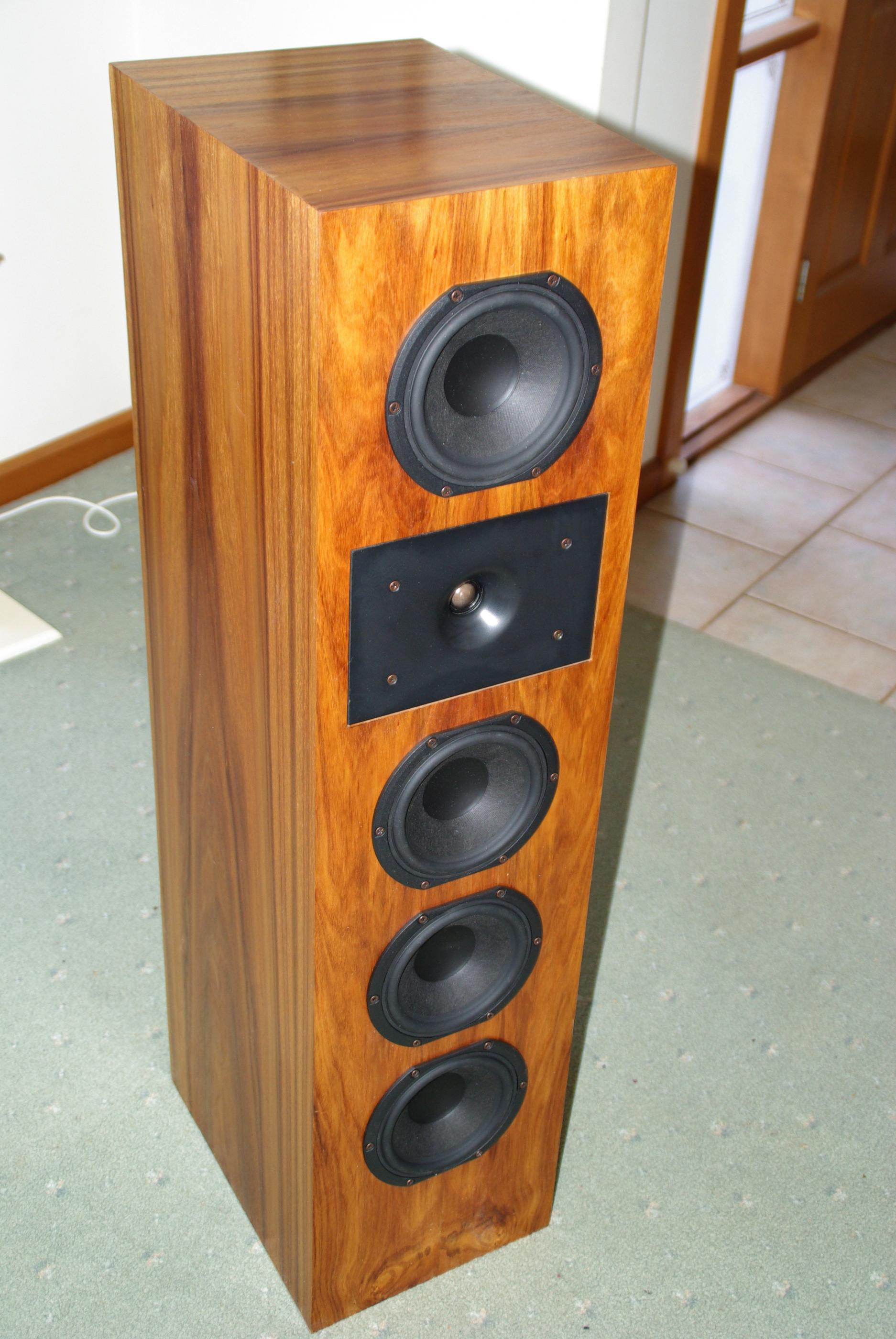

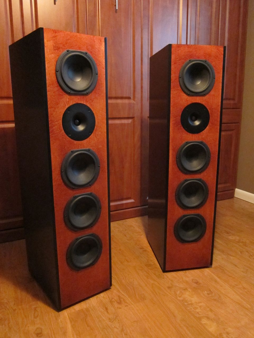

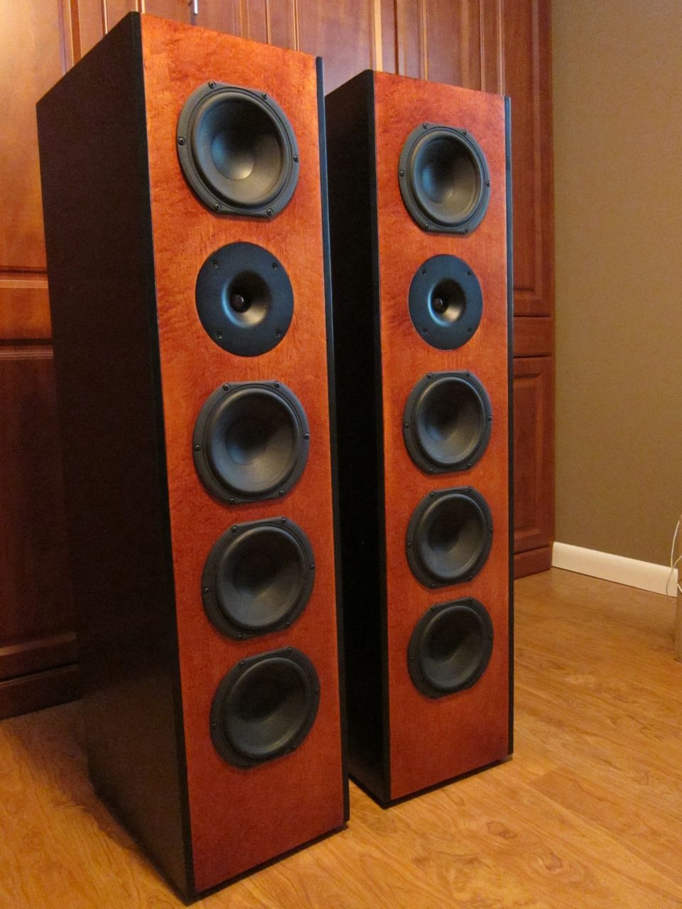

90.2lbs (40.9kg) a piece...
Well, the drivers (and the waveguide) certainly added some mass. An additional 19.4lbs (8.8kg) of it to be exact. Very tricky to move around. I would have relocated them to a different room to get better pics, but, I need to go get a new dolly for moving these bad boys around! Very difficult to move around once the driver holes have been filled. Waveguide looks great, thanks again to Joel for making those available. They are truly first rate.
Cabinets are complete and stuffed (finally!!). Time to get cranking on that cross over. All the parts are in-house. Just need to start building it.

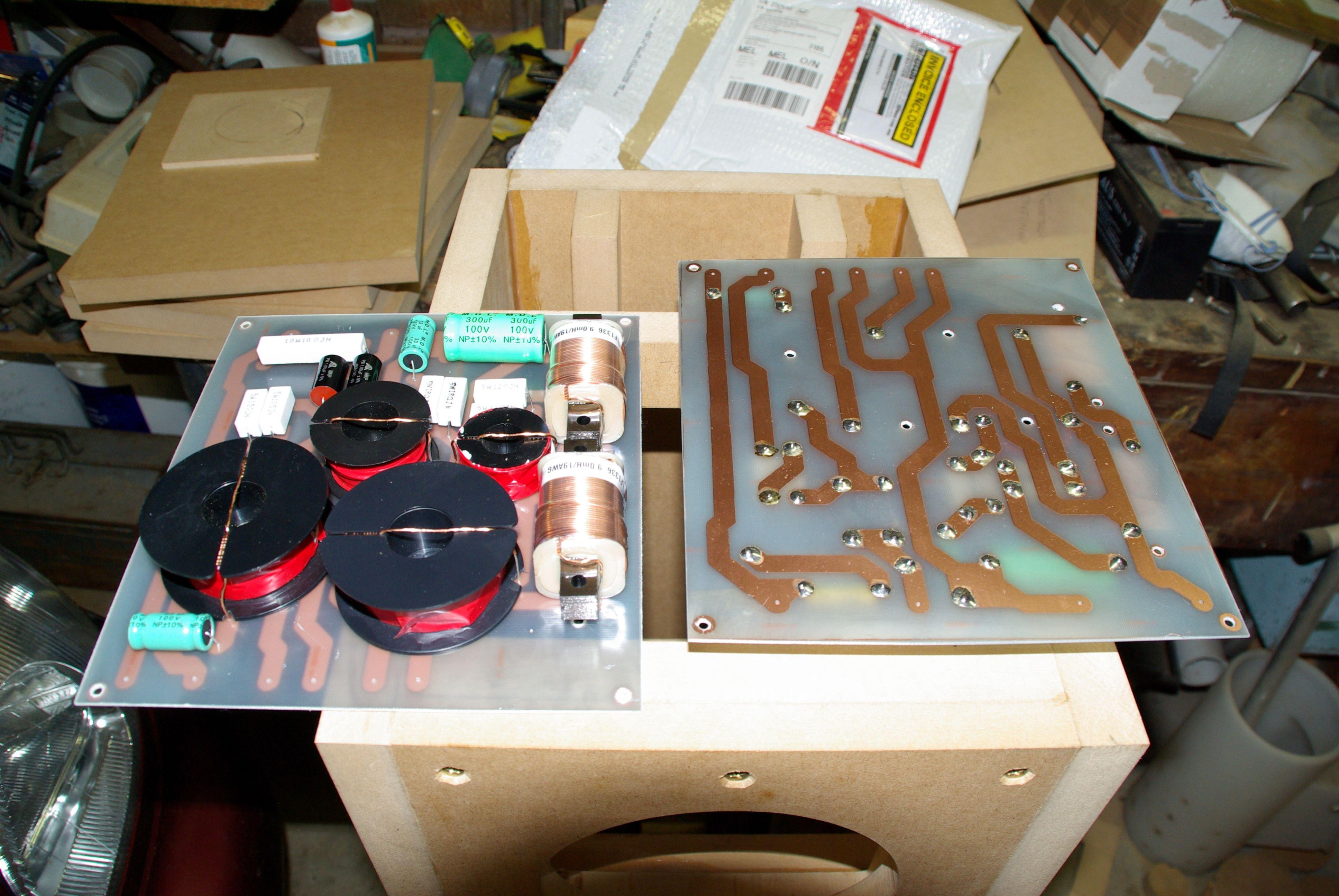

I did the PCB's myself. I designed them using Protel PCB design software and used photo paper on a laser printer to create the etch resist. You use an iron to press the resist onto the bare copper PCB. Then etch using ferric chloride. It takes a lot of practice runs to get it right! Trouble is I have changed several components for better quality ones (mainly caps) and they are a lot larger. Maybe I will do a new artwork. I love the look of your cabinets JK. They look very professional. If I was building mine now I'd definitely use the round waveguides and most definitely use the 8 way Neutrik Speakon connectors they would be so much more convenient.
Joined 2010
I have heard about the iron on technique. I see a lot of folks using the UV light technique as well. I need to learn how to do that one day as it sure is convenient being able to make a custom PCB. If you consider doing new artwork, you might want to check out this link on coil placement to minimize interference effects between the parts. (Placement of coils in crossover networks).
Thanks for the kind words on the cabinets. I am very pleased with how they turned out. Installing the drivers really brought everything together as far as the overall look. I could not be happier with the results.
