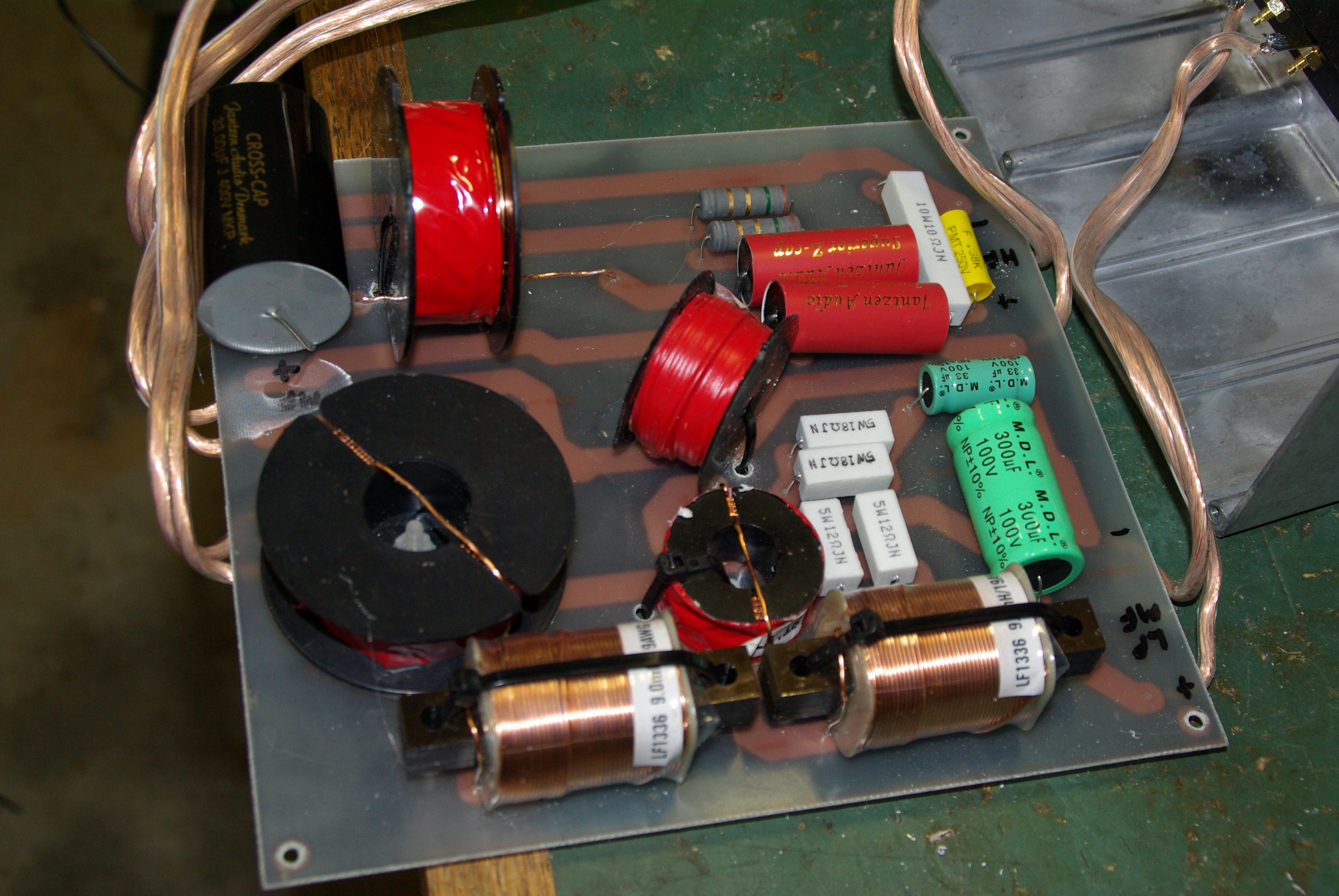

Elsinore Xover rejigged.
I've now rejigged the inductors in my xovers to satisfy the data given by Troels Gravesen. (as best I can given the constraints of my pcb). Many thanks to JdkJake for the link. It'll do for now but I'll definitely have to redo the artwork to satisfy myself. At first listen my impression is better performance at high listening levels which I guess would make sense as the cross coupling would surely be worse at higher levels as the induced fields between the inductors would be greater. My nice neat pcb is looking a bit messy now however. It's another good reason not to mount the xovers inside the cabinets.
Boy, that did not take long to reconfigure. Very handy and flexible board you have there to be able to make such dramatic changes so quickly.

I too was having trouble with interactions between the inductors and put a 10" post on the crossover board and mounted the iron core inductor on top of it. Not pretty but effective. Got the inductors away from each other and didn't increase the footprint of the crossover board.

I separated the inductors after Bolserst did his measuremnts and indicated that there might be some interactions. At the same time I moved the iron core I did the mods that he suggested. Hence I can't say how much of the change was attributed to the movement of the intuctor. However, the overall sound became much more focused and tighter after the mods.

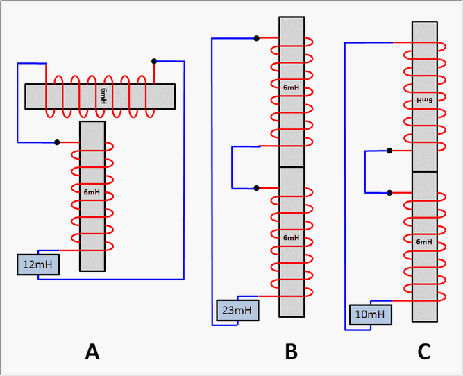

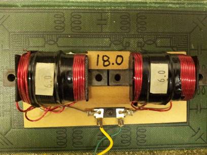

I noticed you had two 9mH iron core inductors hooked in series to get the required 18mH. However, when the iron cores of two inductors are positioned in-line and close together there is considerable mutual inductance generated thru coupling.
Attachment #1: Actual inductance measurements for two series connected 6mH inductors
(A) Where coupling is minimized by axis orientation, total inductance = 12mH
(B) Where mutual inductance is additive, total inductance = ~23mH
(C) Where mutual inductance is subtractive, total inductance = ~10mH
Case (B) can be used to your advantage when creating larger value inductors from two small ones. The gap between the cores can be adjusted to give a value anywhere between 2 to 4 times the individual inductances. For example, Attachment #2 shows an 18mH test inductor I build from the two 6mH inductors carefully spaced apart be MDF blocks.
So, depending on the orientation of your 9mH inductors I would estimate the total inductance is probably either ~23mH or ~16mH; not the 18mH you were going for. The good news is that this inductor is only used for impedance compensation "up-stream" of the woofer crossover and has fairly non-critical tuning. But, something to keep in mind if you ever use inductors like this for critical areas of a crossover.

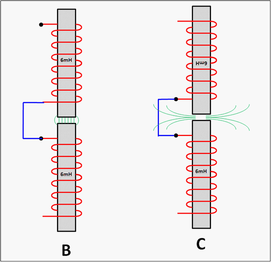

Another thing to point out about case (C) is that the magnetic fields from the two inductors are bucking against each other. This results in a strong flux field shooting radially outward from the gap between the cores. So, positioning other inductors near this area is not a good idea. You can confirm this by listening to the tone from a coil placed in this area. Case (C) will produce considerable louder tones in the headphones than case (B). Attachment #3 is an attempt to graphically depict the behavior of the flux fields for cases (B) & (C).
