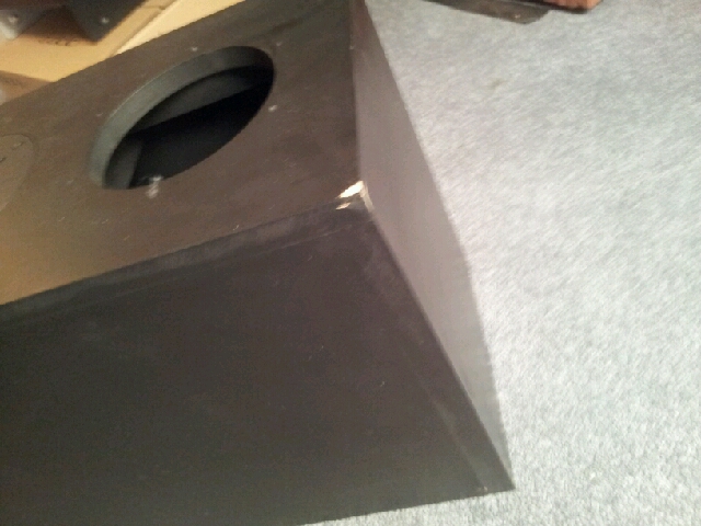

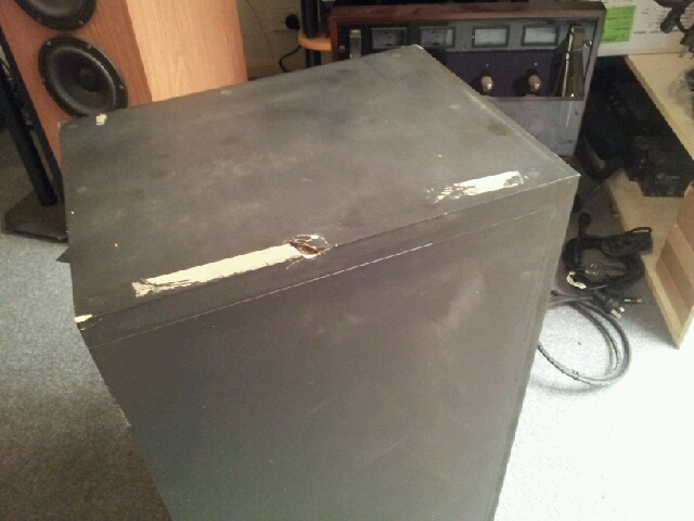

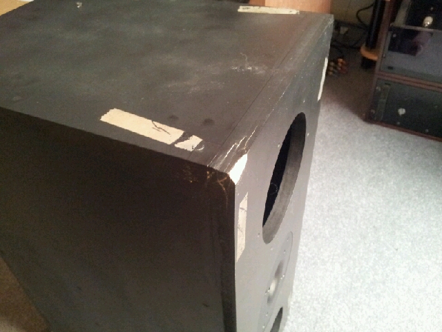

The hamlets are at Joes house but were damaged in transit.
They had been repackage by the courier company at some stage as I didn,t put tape on the boxes,and looks like the transport company isn,t going to come to the party.
Good news although not ideal they can be repaired with something like sellys plastibond etc.
Francois G the hamlets were built by myself with the help of Joel and Jdkjake so Joe could design the crossovers.
Joes busy at the moment and the crossover design will take up alot of his time. (4 ohms or 8 ohms)
But first things first the hamlets need fixing and I live 5000kms away i,m not keen to jump on a plane to fix them.
Anyone in Sydney willing to spend a fews ours fixing them for us would be greatly appreaciated.

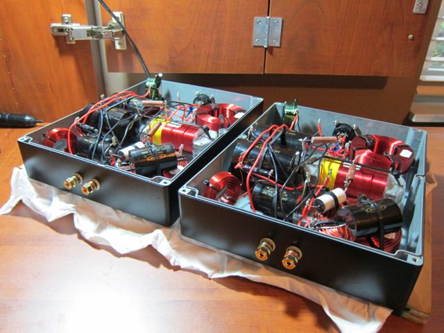

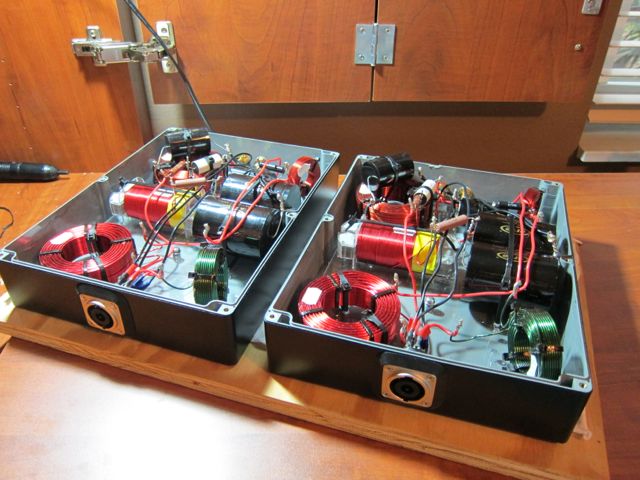

Built up and mounted the crossovers...
Got some time today to finish up wiring the crossovers. They are mounted in the bottom shell of the enclosure. There is a top piece that will seal them up.
Need to make a couple speakON cable harnesses that will connect the crossovers to the speakers themselves. I got started on those, but, ran out of time.
Hope to work on those this week if the day job permits. Man, I am so close, I can taste it!

That's Beautiful.. Amazing looking layout

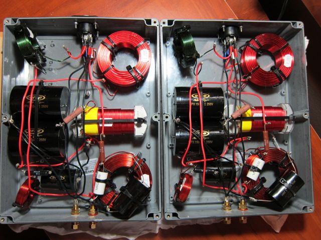

Got some time today to finish up wiring the crossovers. They are mounted in the bottom shell of the enclosure. There is a top piece that will seal them up!
I have completed my Mk Vs about two weeks ago and they sound great! My crossovers take up the entire area of the bottom of my speakers and I don't hear any L interaction.
So, Jake's CO experimentation and implementation experiments were moot in my case, but very interestig at the same time. I'm looking forward to near about his results, but I expect in the real world these parts placements don't matter so much.

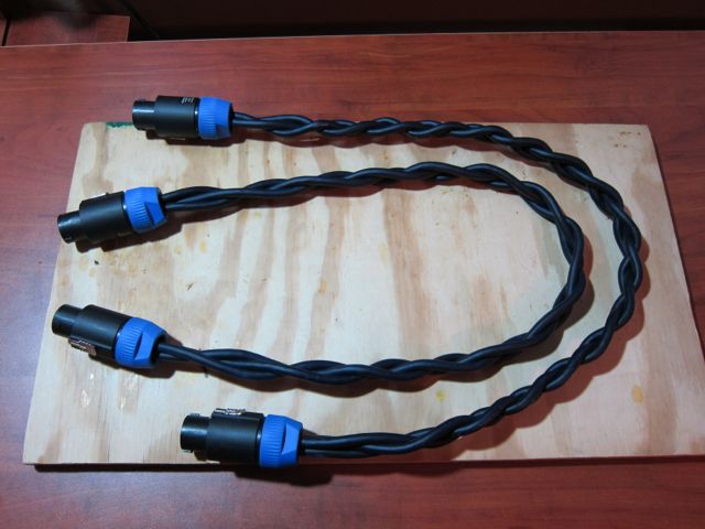

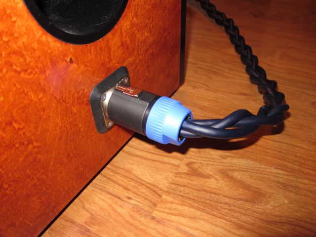

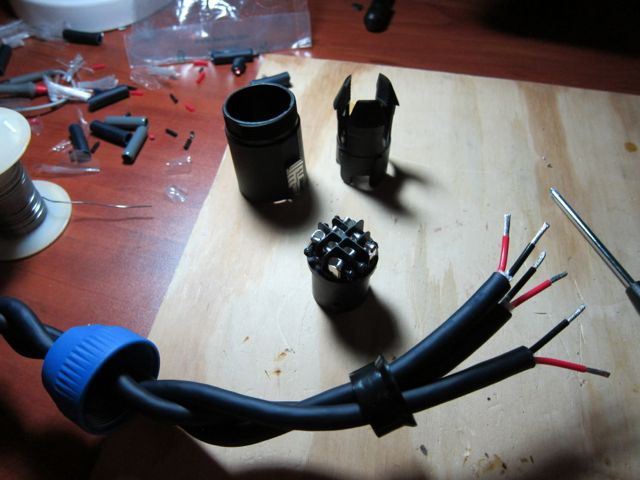

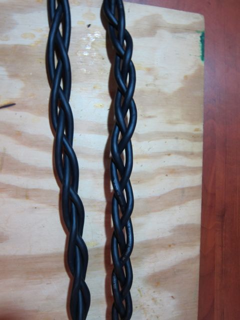

Cable building day...
This morning, I built up the speakON interconnects used to connect the crossovers to the speakers.
The process of building these cables went well. Very straightforward as the neutriks are pretty well thought out. It is just a matter of getting used to the components and how they play together. A couple of false starts and re-dos, but, nothing out of the ordinary. I really like these connectors and can highly recommend them.
I ended up braiding the individual cables (seldom used skills developed many, many years ago on baby sister). One cable is a tighter braid than the other by about three braids. I think I like the looser braid better, but, I will probably not go back and re-do the work. They are close enough and I have waited far too long to bring these bad boys to life!
