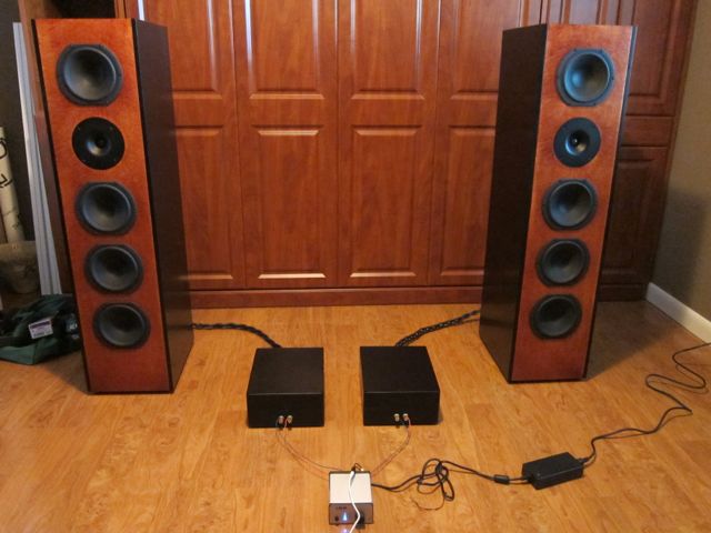

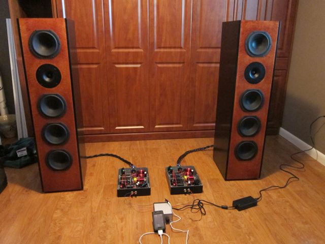

Finally, they have been brought to life!! And there was much, MUCH rejoicing!! :cheers:
Did a quick polarity check and then hooked up an iPod via a T-Amp to give them a quick sound check using my traditional checkout song (Natural Mystic). They work JUST FINE. 😀

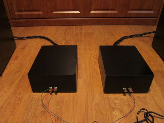

I also closed up and put the lids on the crossover boxes. In hindsight, they did not have to be quite so tall, but, they are what they are. Lot's of room for expansion and experimentation if warrented. The paint job turned out fine. They look a lot better than the anemic gray they started life out as.
As for the sound? So far, I am very much liking what I am hearing, but, it is far, far too early to offer any kind of opinion. Gonna leave them on the iPod/T-Amp for a few hours to let them wake up a bit and then move them into the main listening area and hook them up to a source/amp far more capable. In time, I will measure the port frequency and adjust/tweak as deemed appropriate to finesse the resulting sound. Same holds true for the crossovers.
Man, I have to tell you, this has been a long, LONG time in coming. Thanks to all for for the helpful input and guidance. Thanks for the patience and indulgence of my meandering diatribes and far too many pictures of the project. Most of all, thank you for all the well wishes, kind words and encouragement. That made all the difference to strive to achieve something far greater than I originally envisioned. A happy day for sure.
This has been one HELL of a ride! Time to pour multiple adult beverages and enjoy the fruits of the labor.

You have the patience of a saint. I woke mine up with my twin 120 watt mosfet amp in the lounge room. I couldn't wait any longer. You will soon hear the difference between your ipod and a real source with these speakers. Happy listening!
Actually, it is probably more attributed to being lazy. Those mothers are heavy! I did not want to have to move them back if they needed some debug/rework.
I moved them into the main listening space last night and spent a few hours getting acquainted. They are very sensitive to placement. Especially toe-in. I have them dialed in pretty good right now. Going to spend the day rocking them out a bit to see what they can do.

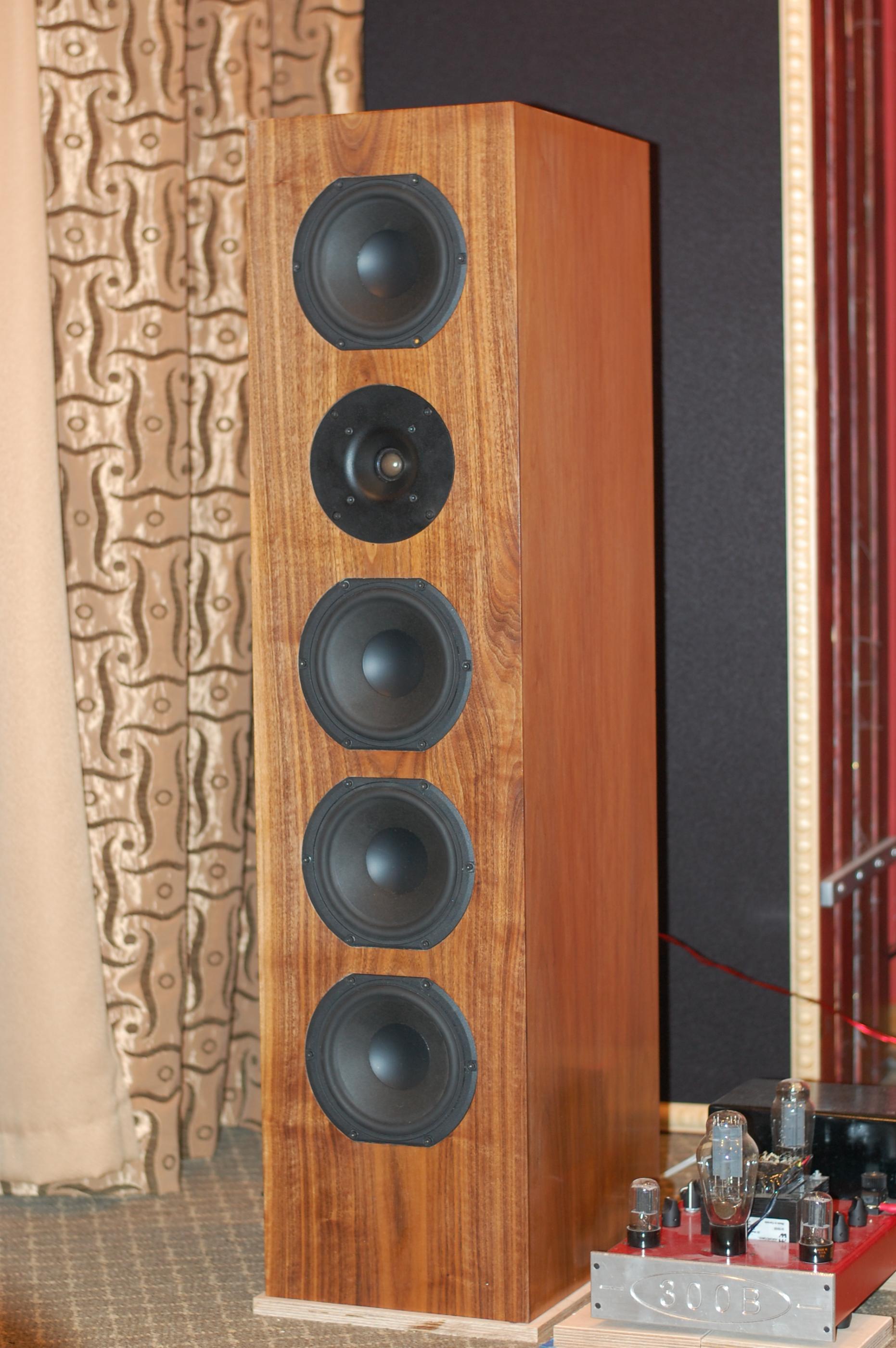

New Pair up after much work on finishing techniques.. :Olympic:
Crossover on back plate with solid connection..
Sounding great!😀😀
Have next pair in the works.. Trying a 18mh air inductor on this one and going up in capacitor selection..

Beautiful work Joel, as always! What is that veneer? Very deep character.
How about a pic or two of the back plate mounted crossover? 😀
Did you go with the Jantzen torroid at 18mh?
Thank You.. The veneer is walnut but the front is a walnut 4mm thin board.. The 2 front boards were machined from a 1" solid walnut.. Band sawn in half, then planed to 4mm..

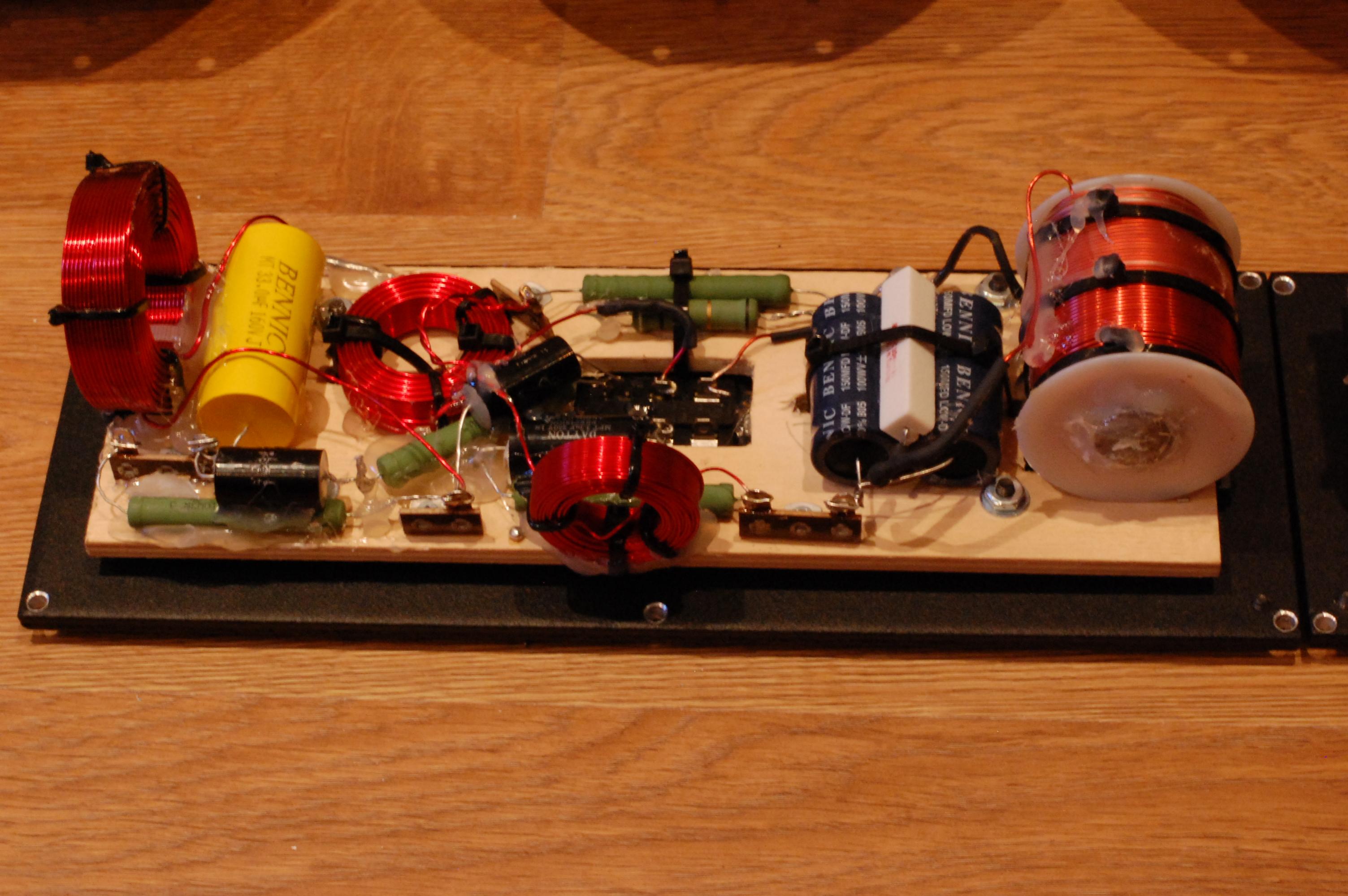

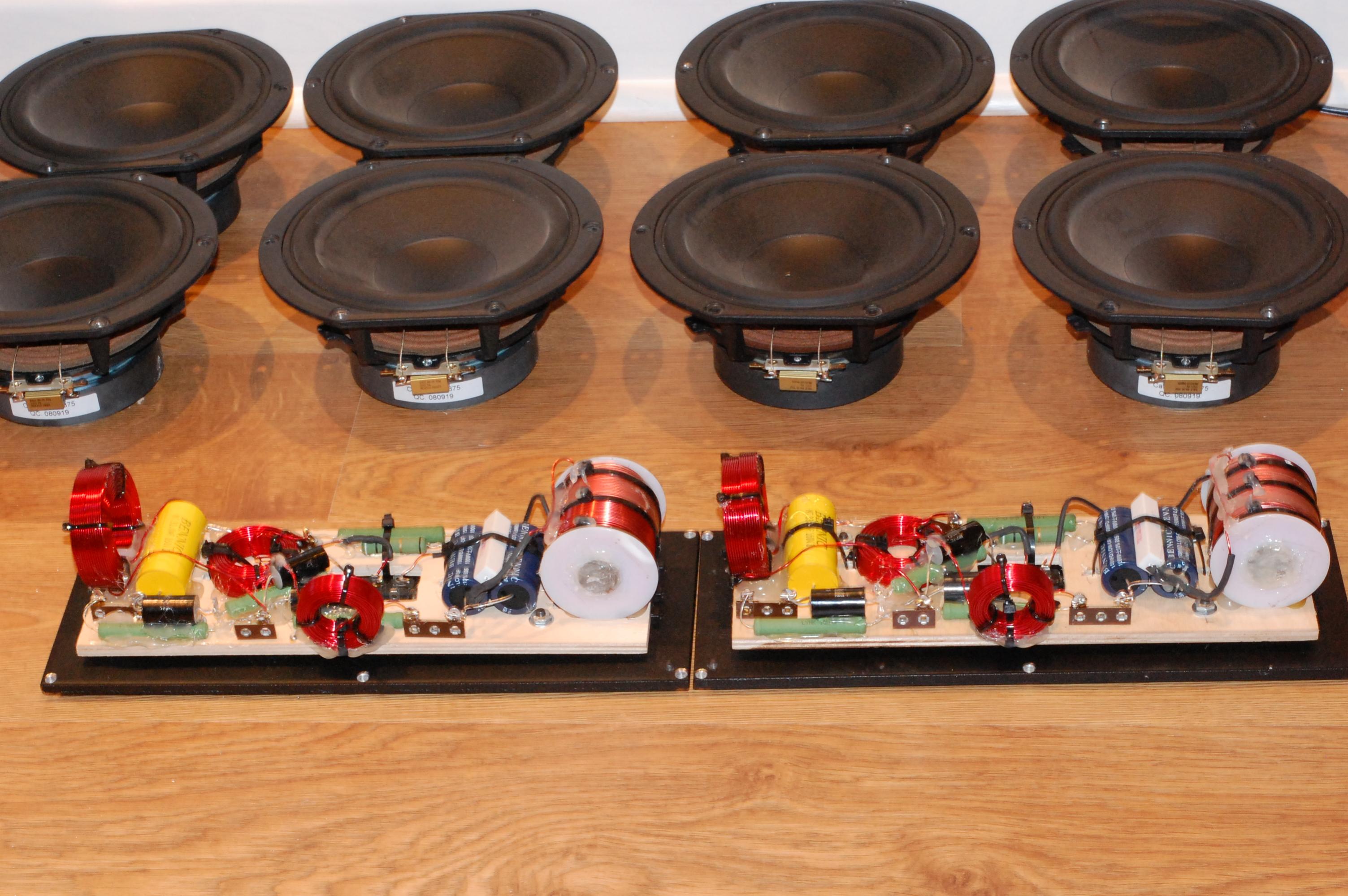

Just a picture I took after I had the crossovers built on the plate. the wood that holds the parts is 96mm wide and fits between the stiffening braces.. The larger 1.8mh going to lower woofers is not on the plate but attached to the main brace... Next pair has 2 rear plates.. one for tweeter and one for mid/bass..
Stayed with the choke I had. 18mh parts express I believe..
