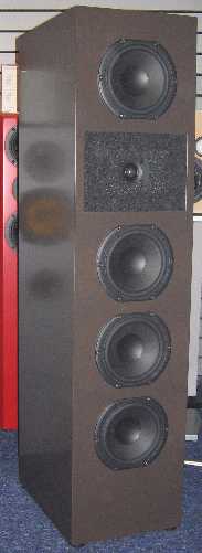

Here are my Elsinores.
I like them a lot. Very, very dynamic speakers.
These ones are with the HDS Nomex in it. I'm still tempted to buy 8 pcs of the PPB. Just to try.
I would like to thank Joe for all his work.
