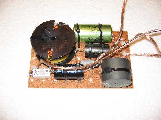

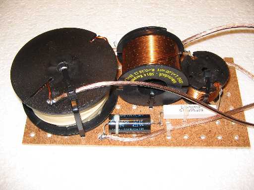

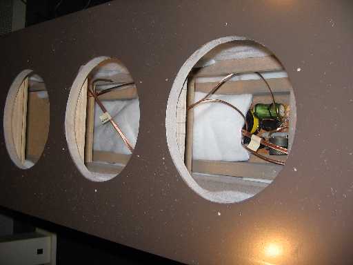

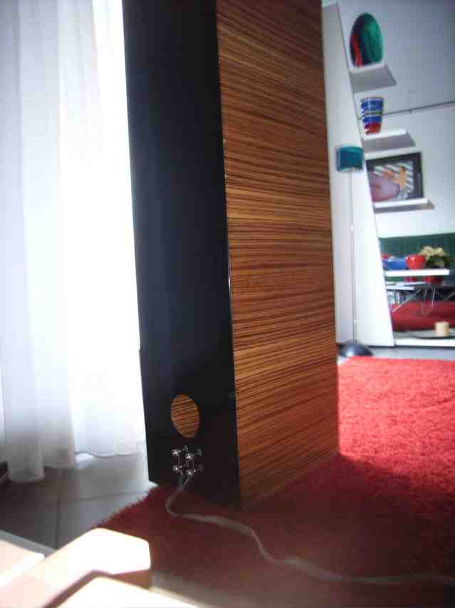

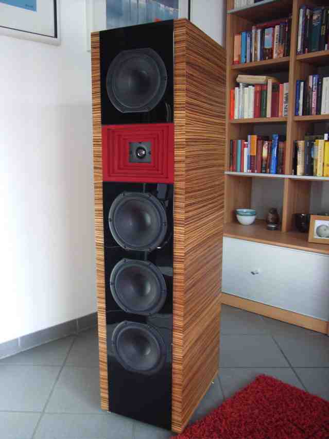

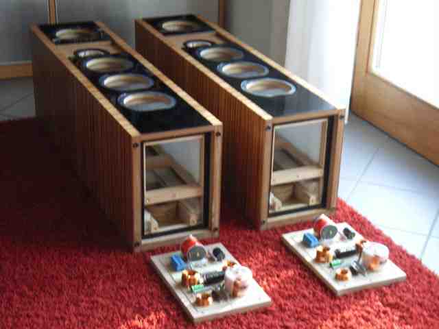

Elsinore MK3 build
Hi, just build my pair of MK3 some weeks ago. Kept Joe's design as close as possible with some minor changes:
- crossover is inside on the bottom panel, which is removable
- separate connections for tweeter and midbass/bass
- front and back panels are covered with 3 mm black acrylic sheets
- tweeter felt is made from 4 mm felt I had on hand, slope is more gradual
- tube is made from mdf and covered with veneer (i did not get adequate tubes in Germany)
Crossover parts are from Jantzen/Denmark.
Sound is outstanding. Hopefully more people will give design a boost.
