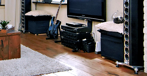

Nope, very true... I've asked if I needed to hide my subs in these same canvas covers. This won't be needed so I "grew" with the sub size: 3 cm in all directions .
These feet bench are 37 cm x 37 cm x 35 cm. My subs will be 40 cm x 40 cm x 40 cm (outside).
Still unsure about the feet (I want some kind of decoupling there). The feet used on my arrays are NLA as it seems.
