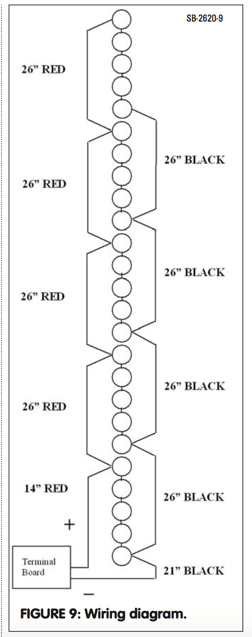

Interesting project, btw. How do you arrange your 25 drivers electrically? 5 x 5, I suppose?
Best regards!
Yes, 5 drivers in series and that 5x parallel.
@sannax: You can do it that way, but if you blow 1 driver, it will tend to cascade, because the remaining 4 in parallel will now take more current. You lose 5 drivers before the whole speaker opens up. When you do 5 strings, if you lose 1 driver, it stops there, blowing 1 speaker, silencing 4 more, and letting 20 keep playing.
Marc
Marc
Would it be any difference to arrange 5 in parallell and then these 5 groups in series?
8/5 x 8=8ohm
You would also need a lot more wire inside the cabinet which is not a good thing.
This image is a pretty good visual representation of how to do it from Roger Russell
![597632d1486469724-full-range-tc9-line-array-cnc-cabinet-screen-shot-2017-01-24-10.13.47-pm.png](https://www.diyaudio.com/forums/attachments/full-range/597632d1486469724-full-range-tc9-line-array-cnc-cabinet-screen-shot-2017-01-24-10.13.47-pm.png)
