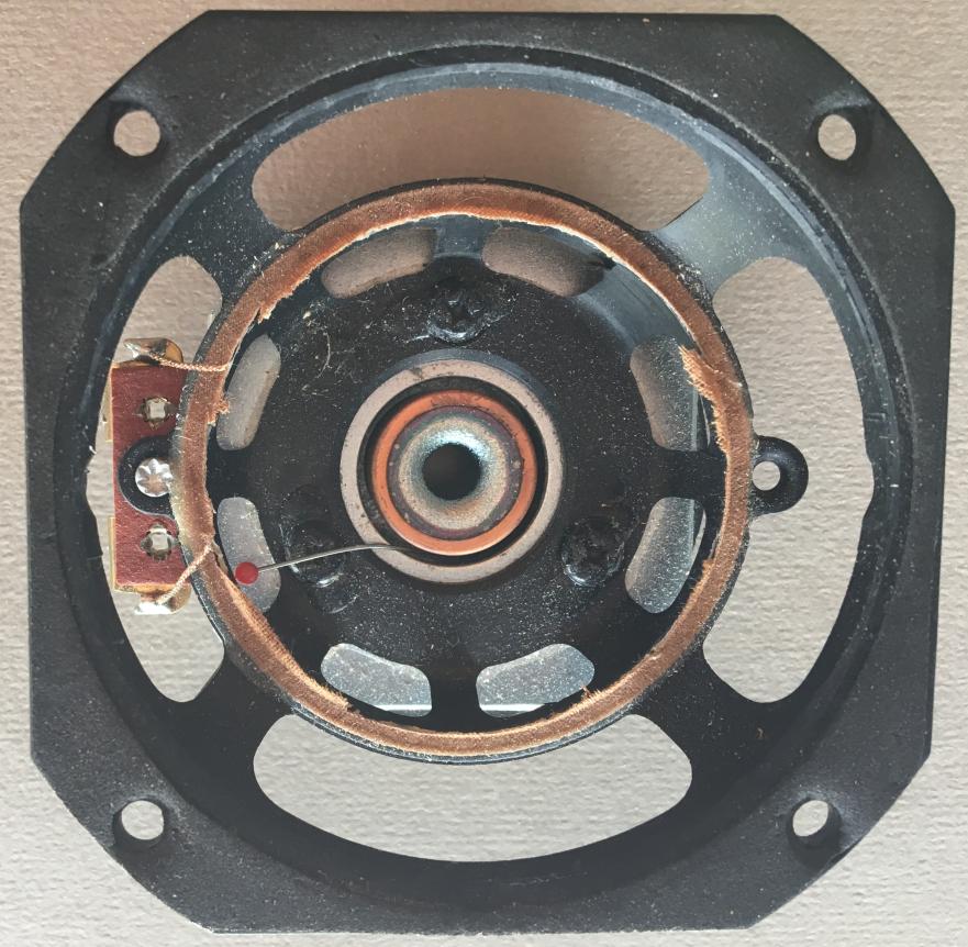

LOLHad been using this little TC9FD as a cutting and drilling guide, since it wasn't working. Looks like I discovered the reason why.![]()
