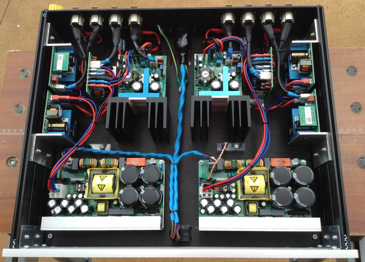

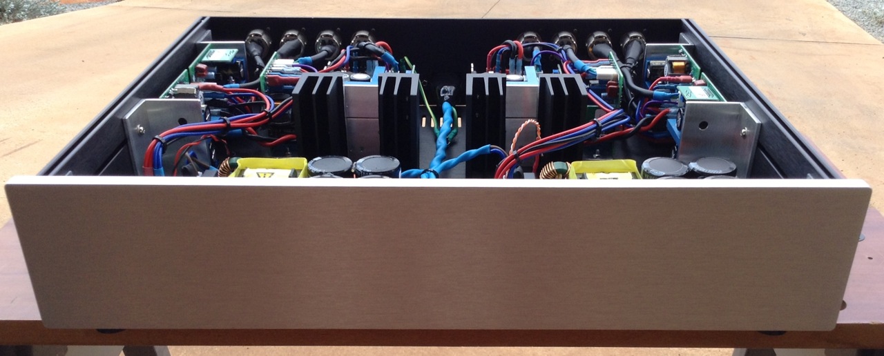

I see Power Supplys. Assumed Class D multichannel Amp. Is there DSP?
Nice and light... Sigh. I miss my toroidal transformers. But that's potential power right there.
8 channel Hypex UcD Class D. 6 x UCD 180 on the sides, 2 x UCD 400 in the centre at the rear. 2 x 1200W power supplies at the front.
I don't miss toroids at all. Every single one I own hums annoyingly in the house I live in now. If I used toroids this would weigh about 40 to 50 Kg. In lower power devices I am using R-core transformers now and they have no hum either.

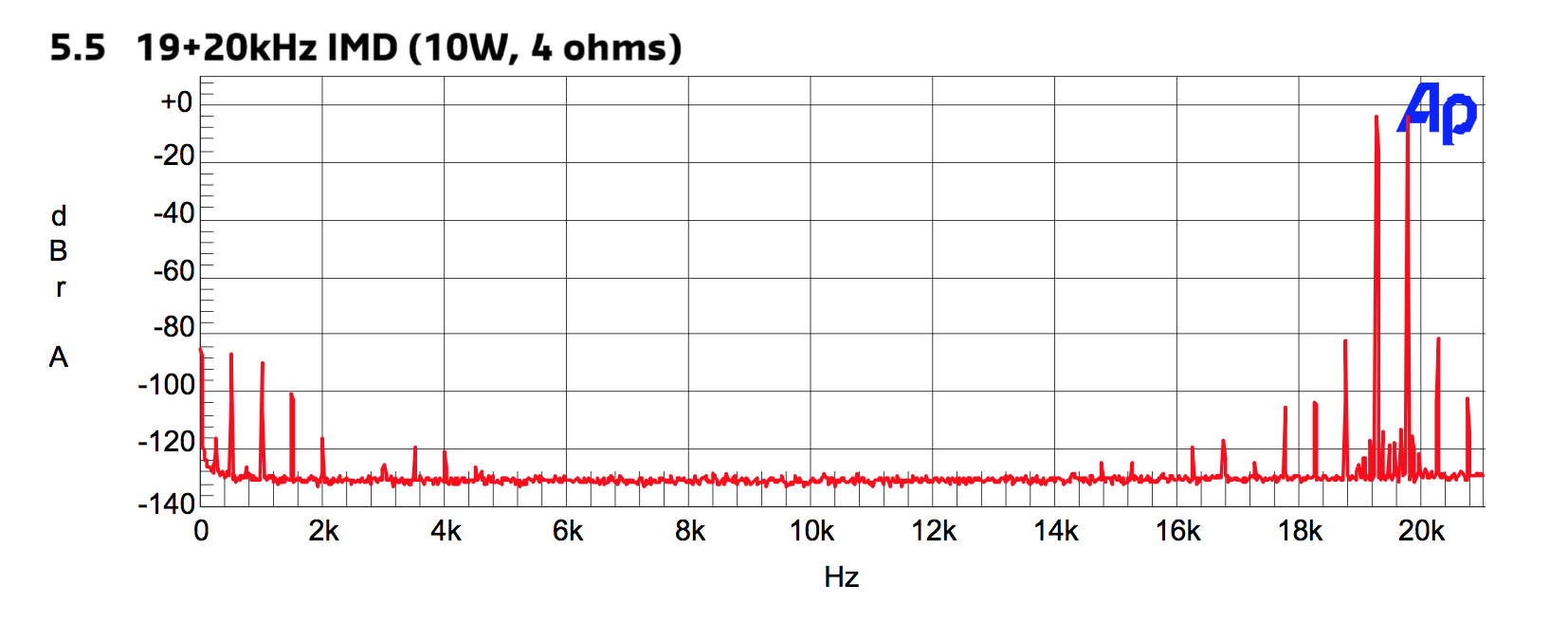

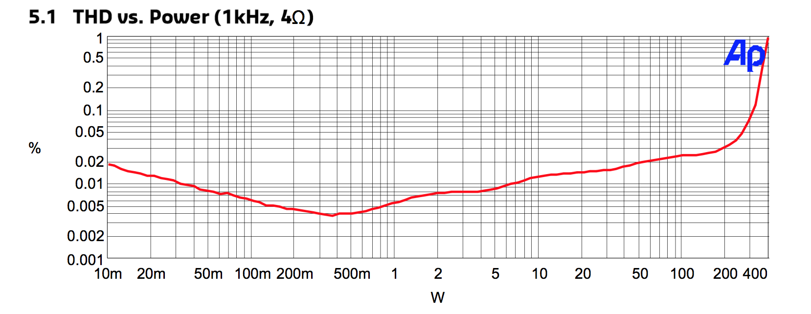

Class D used to have so much IM and THD distortion tho. Was perfect for cars, but 10% THD is not attractive for home. Have things gotten better?
Not all Class D amps are alike. Bruno Putzeys know what he is doing
This is THD and IMD for UcD400 the ncore is a bit better. SL also has some IMD testing on his site and you can see that the UcD is very good in that regard.
Distortion Link to testing graphs

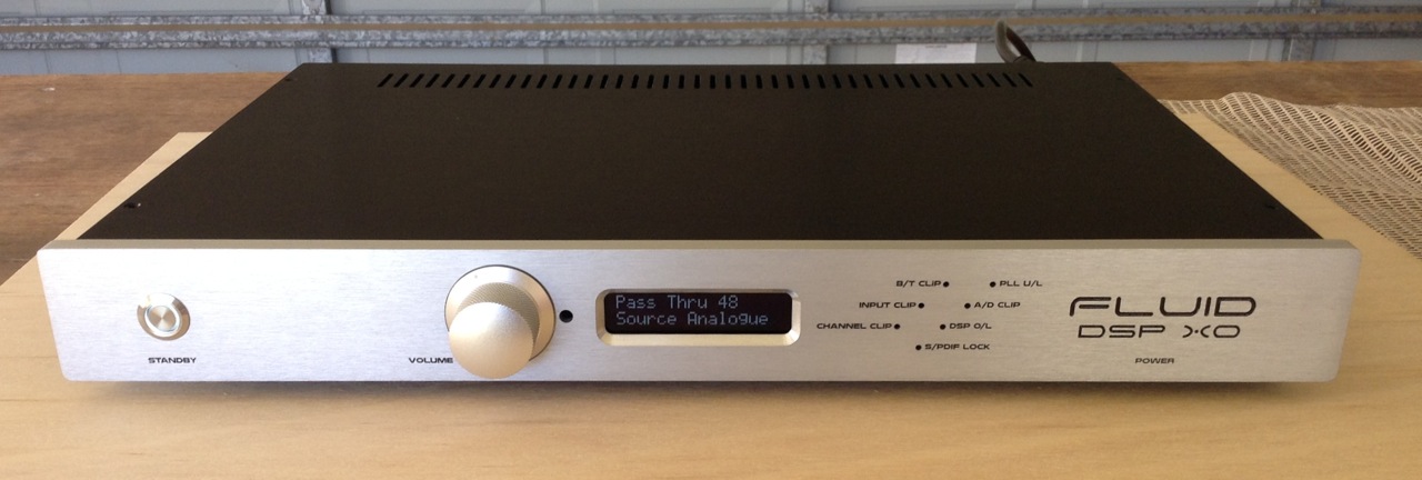

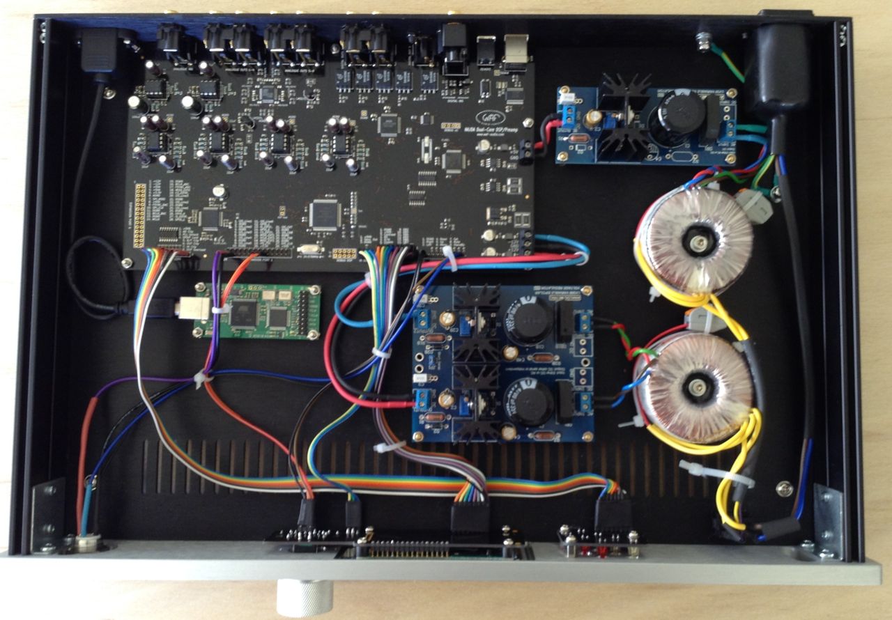

DIY multichannel DSP?
Do tell us more. I've been looking around for something like the Exasound e38 but without the price tag.
It's a Najda DSP board in a box I designed with a linear power supply kit. I don't know how easy they are to get anymore as Nick the designer dropped off the map a bit. His website is still up but I haven't tried to contact him to know if they are still available.
