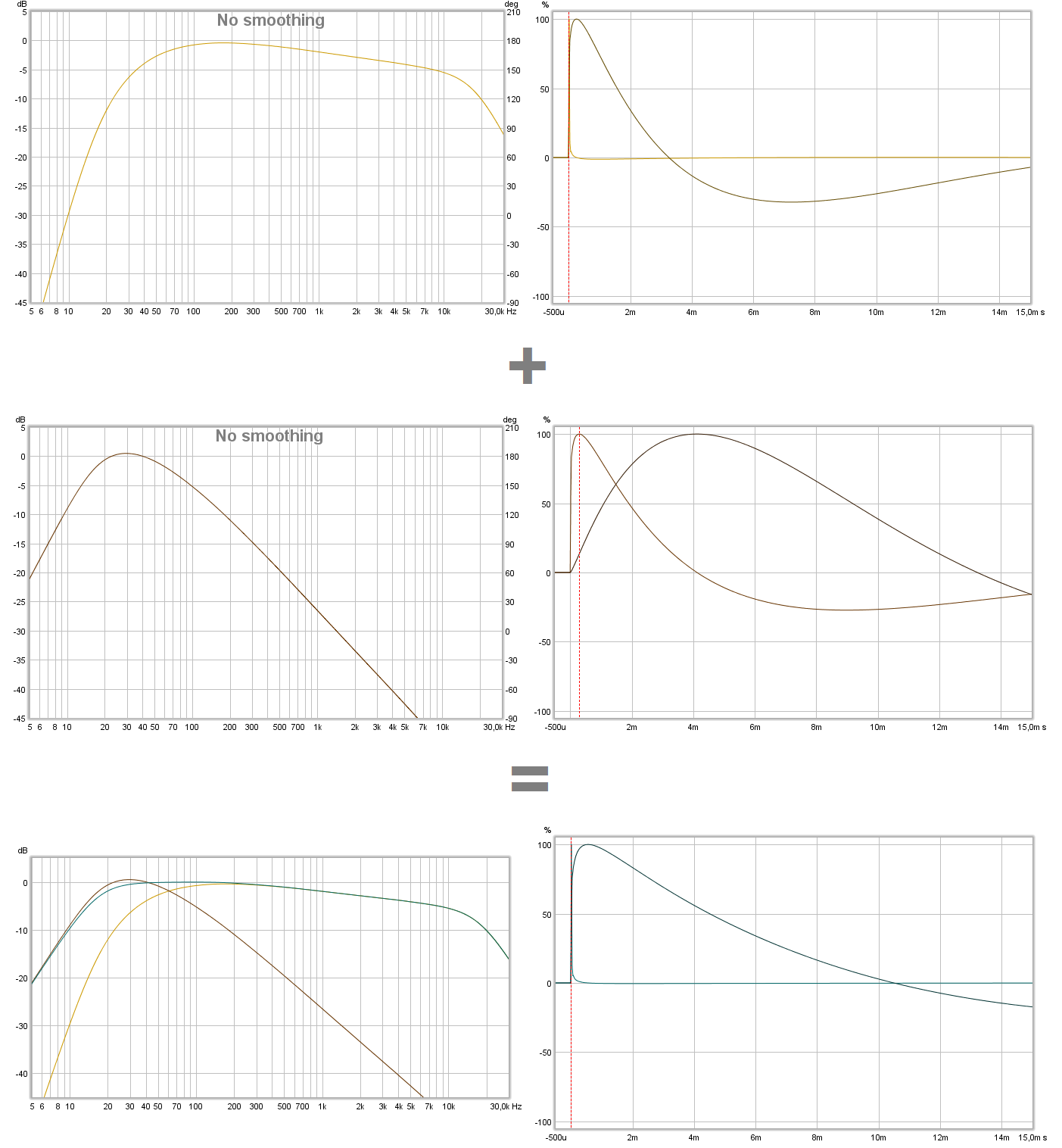

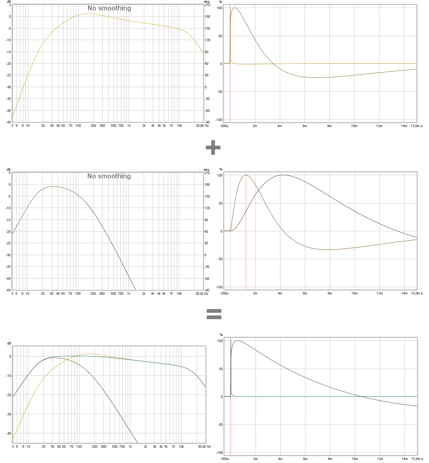

Hi perseval know I'm not wesayso but here some idea and examples
Its pretty easy create sims in REW based on IR wav files of band passes created in Rephase which is method used below and also good as target responses when calibrating live speaker system.
First one have sharpest roll off for sub and softest roll off for midtweeter and second one has opposite scheme, and as can be seen the more HF material sub include the more sharp non wide IR and the less the HF material is the more wide and wooley is IR.
Technically below sims are close to wesayso's system in that sum is 17Hz-18kHz band pass with a B&K curve. Slopes maybe looks bit weird and they low order that's because they comes from weird experiment trying let a two way system do what a 3 way B&O hole filler system normal do, so in first example woofer slope response is same as in the 3-way system but midtweeter slope response include both filler and tweeter from the 3-wayer and in the second example roles are opposite so that woofer slope response include mid filler. These IIR slopes can give transient perfect system without having to use FIR DSP but in its uneven order they not in phase at XO point which lead to tilted acoustic lobe in WT config where WTW config will help correct the acoustic tilt.

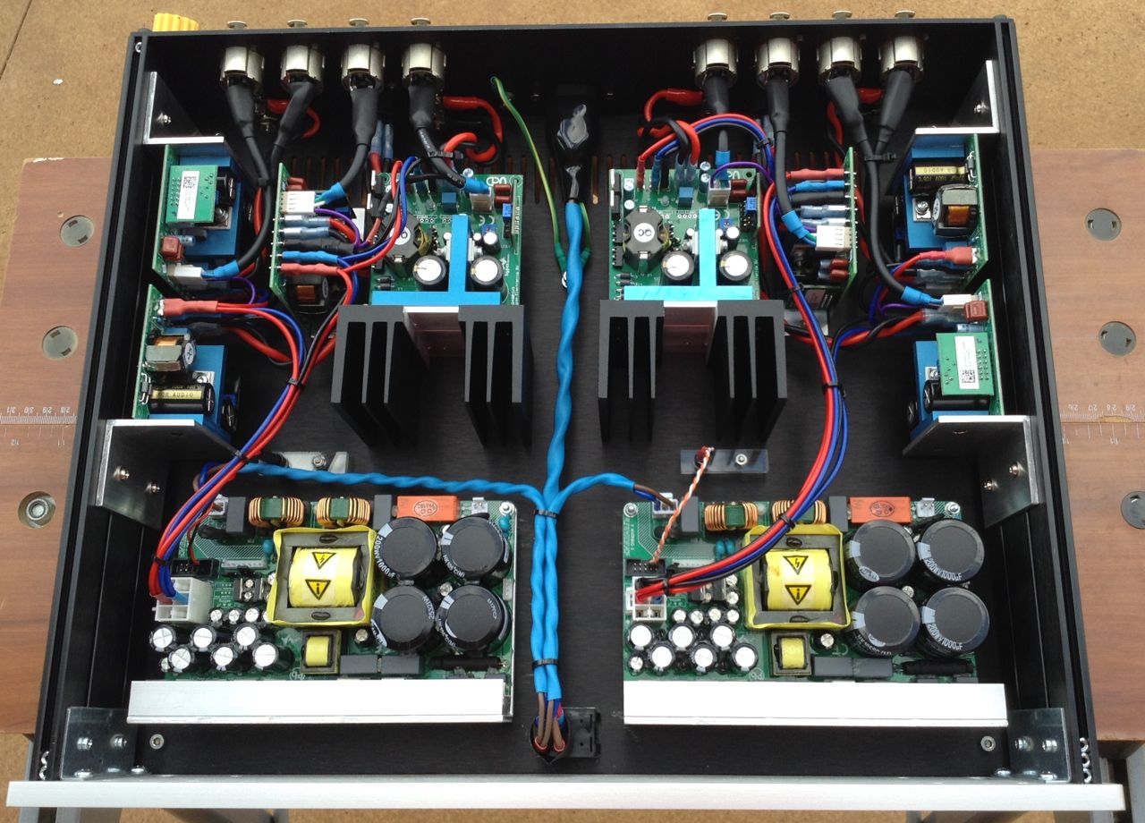

Modushop make some very nice aluminium enclosures and they can fit quite a few Hypex modules in. They have different sizes with more or less heatsink and come in black as well to match the rest of your gear. The chassis can be quite an expensive part but I think they are worth the cost.
This is inspirational

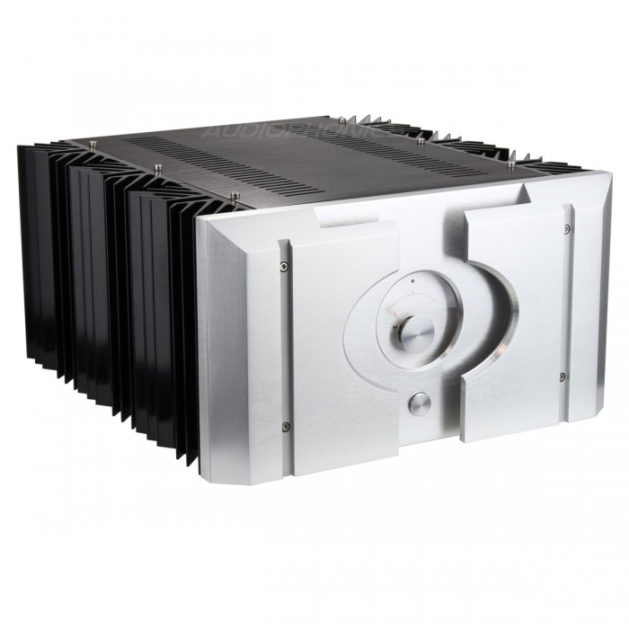

A while ago I saved a link to this enclosure (mimicking a Pass Labs amp)
Figuring it could hold everything in a single amp. First One Large for mains, Ucd for all the rest. Still think it's a bit too bling bling for me though.
I just remembered something Lazy Cat mentioned a while ago. Why not re-use an old amp to hold the new components? I'd be willing to sacrifice the Pioneer A-447 (which I bought cheap) to hold the ambient + sub channels and still have room to spare for future experiments.
I don't see myself replacing my A-757 Mark II anytime soon as it's in superb condition (well maintained) and I still have absolute faith in it's performance.
That way I get to keep the same look and size, might be able to re-issue the on/off switch and "on" led. Volume control is not used anyway.

This is inspirational. I could replace my Pioneer A-447 (which powers the ambient channels) with UcD 180 modules and integrate 2x UcD 400 for bass while leaving room for future experiments (like ambient tweeters).
Sounds like a good idea, I have bought some chassis from ebay and more recently directly from taobao, very good quality but the shipping gets to be expensive. You also do not want anything else in a case with a First One amp of any size, they get hot. The 6 channel First One I am building is in a 5U chassis and I will be putting a couple of fans in at low speed just to keep some airflow. SMPS get pretty hot too, keeping the temperature down is what allows them to produce more power without shutting down.
You could do that easily, I would gut it completely as the power supply doesn't look like something a first timer should try and rework. That is a step up from plugging together Hypex modules! You could probably sell the individual parts from the inside on ebay for more than you paid for the amp
You might be able to reuse the connector holes by using TRS Jack plugs instead of XLR's depending on the size. The Hypex amps work well by using a pseudo balanced cable which needs a 3 pin connector on the amp end to work.
The on off switch will depend on what type and rating it is, you can always rig it up to a Hypex soft start board then you can use any switch you like.
If you decide to try and you want some help you know where I am

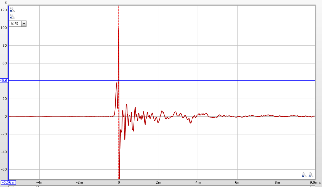

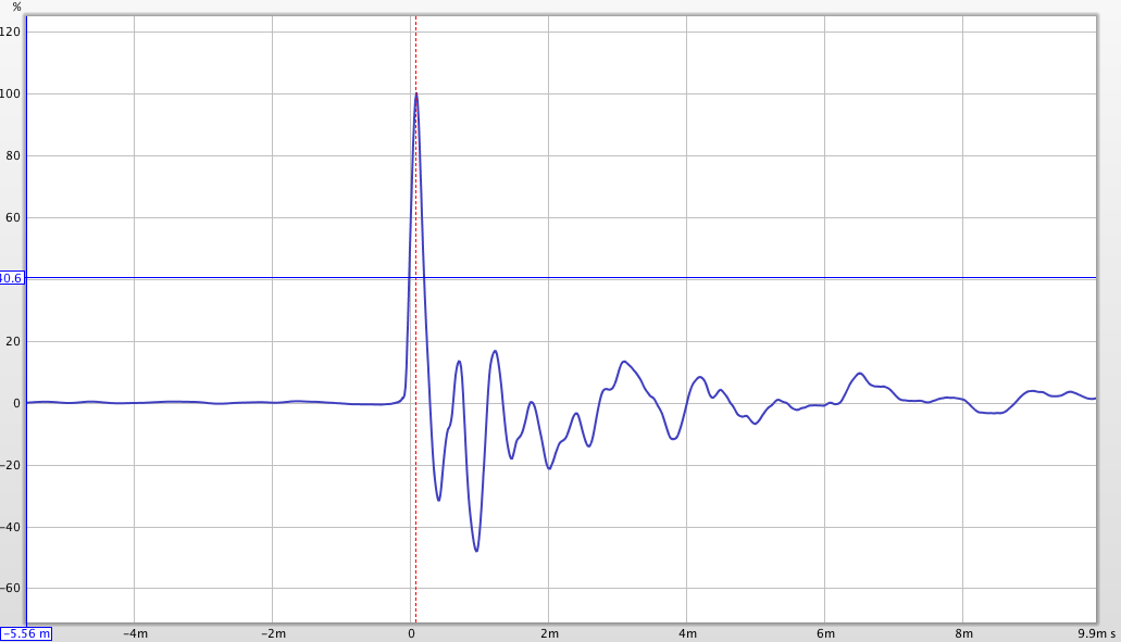

Hi perseval know I'm not wesayso but here some idea and examples.
Thanks Byrtt! I mentioned wesayso, because he was looking at subs lately, but your replies are good too!
I've been testing a couple of 15" woofer/subs I get around here. Trying to find a good one is not so easy. And shipping 15" drivers is crazy!
Here's a couple I got... I think the red one looks better than the blue. Both were taken without any filter. I just ran a sweep as is, mounted on an open baffle.

Which one would be better is a matter of opinion. The red one shows more high frequencies.
The blue one more resembles what I'd expect a sub to do without any filtering.
Which one would be better is a matter of opinion. The red one shows more high frequencies..
yes, the red one is a "fullrange 15" with a Fs of 35Hz, and capable of reaching 10kHz
Opinion it is then. When used as a sub only, the red one is sharper, bass it tighter, more snap. The blue is not so fast and seems slow at keeping the beat.
