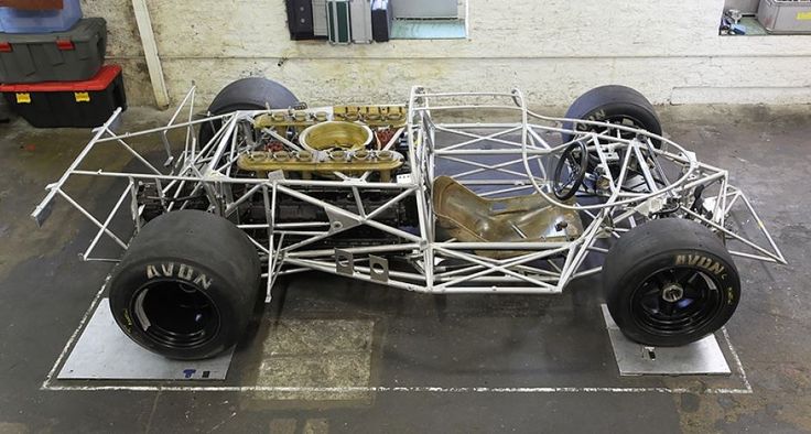

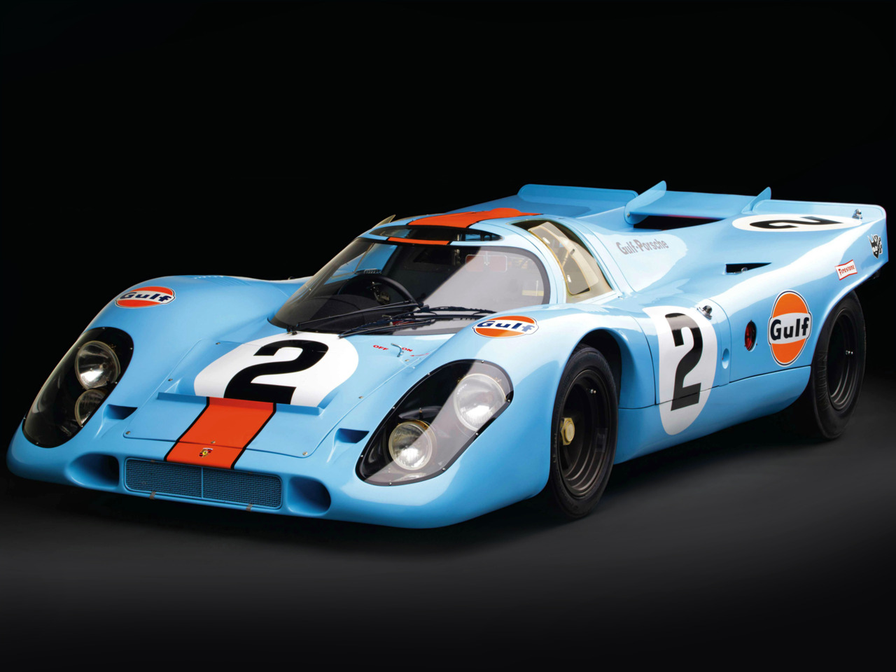

I saw that one . Beautiful car though.... my all time favourite Porsche must be the 917.
But I'd want it with the original flat 12 boxer engine....
As beautiful as the endurance car is, the brutal 917/30 that Mark Donohue drove in the CanAm for Penske is my favorite.
Maybe use some MDF in the mix, much heavier than ply.
I don't particularly like MDF. I know it's heavier, but it's just compressed cardboard to me.
I guess steel adds more weight and might be more stiff while taking up less volume.
Rules had to change on both sides of the ocean because of these monsters .

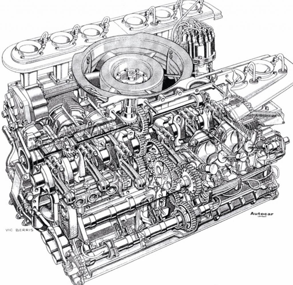

But if the 911 is like a full range driver like it was said a page ago, the 917 would definitely be an array. The CanAm 917 would be a ported array. More output but not without having consequences in timing. I'll take the sealed (naturally aspired) version any day . One could even see my arrays as a souped-up 917 engine with a blower (with all the EQ boost I use). Finicky to get right, but when you do...(just kidding here)

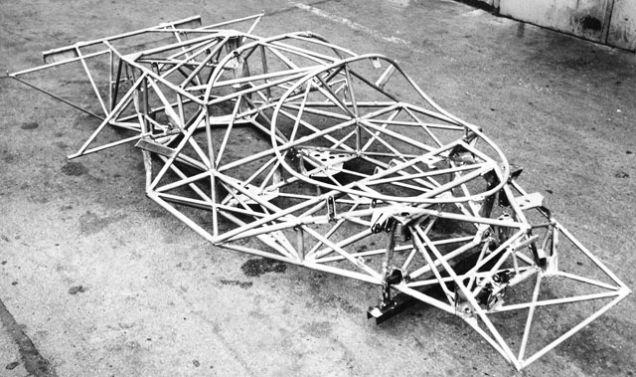

I have a huge admiration for what they did in those years, the drivers all had to have big b###s, euhh... you know what I mean... These cars were monsters and probably were the last of their sort in an all out attempt at greatness in their respective classes. The cars weighed next to nothing. The drivers feet were in front of the front axles. Huge power, this was crazy stuff.
I love the looks though of that endurance racer. And the tubular frame was pretty crazy too!
