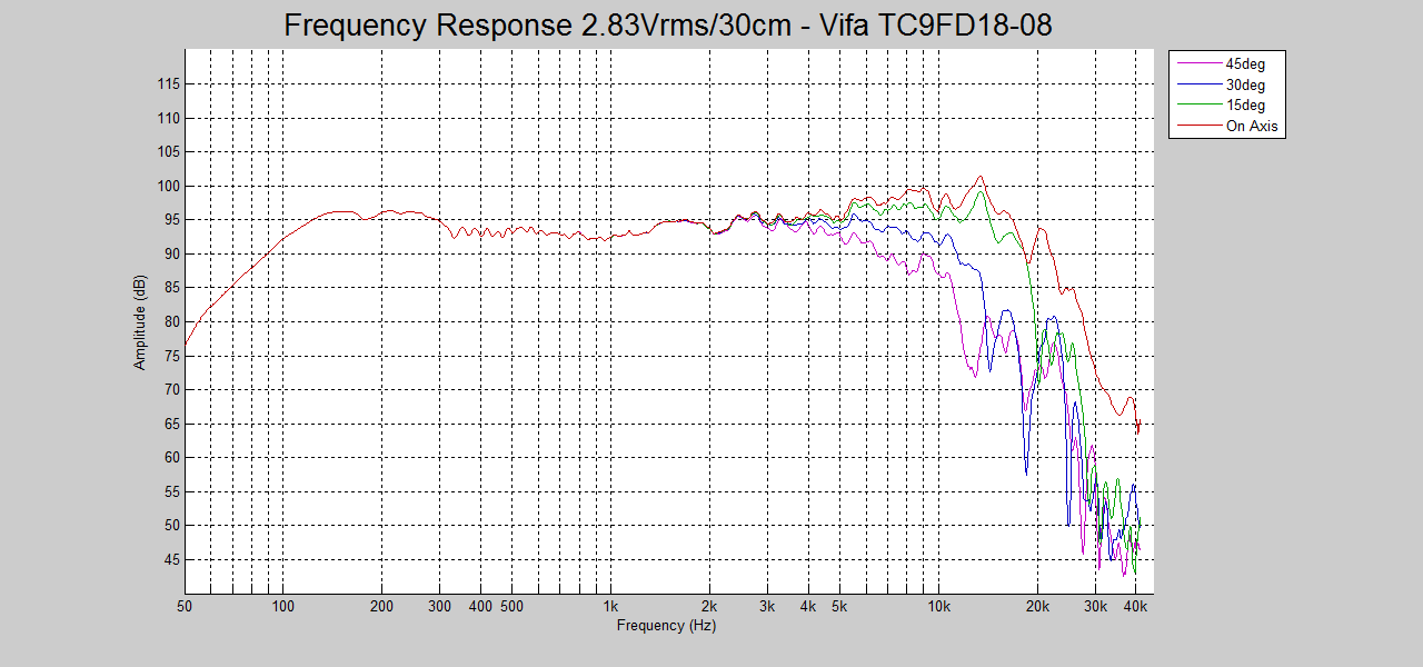

A 3 seat couch has never been a problem in my house. It is why I picked the TC9. Even way off axis the results are better than I could hope for.
I'm hoping the guys who have heard my arrays (a growing number) will chime in too.
At an angle up to 15 degree off axis the output is still very similar to the on axis curve:
(using the round-over outer baffle even helps there with even more bundling in the upper frequencies (around the 5 to 8-9 KHz spot), but I've lost some plots that show that, I can't do them with meaningful results with the arrays).
I use absorption at first reflection points to counter the more irregular room response that might come from the beaming character of a 3.5" driver. However even before placing damping panels I had quite an acceptable result. I just wanted to know how far I could go with this concept. That's an on-going journey as this thread has proven.

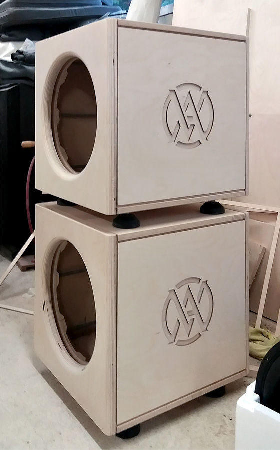

The second enclosure is moving along nicely. This one is a much faster process. I've ordered epoxy and paint to make it match the arrays. I'm a little scared on how to do the area around the logo, as part of the epoxy paint will be applied with a light micro balloon fill to get the same texture as on the arrays.
Not sure yet how to handle it properly, I kept the cut-outs from the laser cuts as I expect they will help out to keep the logo's clean and sharp looking.

Enclosure work is done, on to sanding and epoxy/paint
