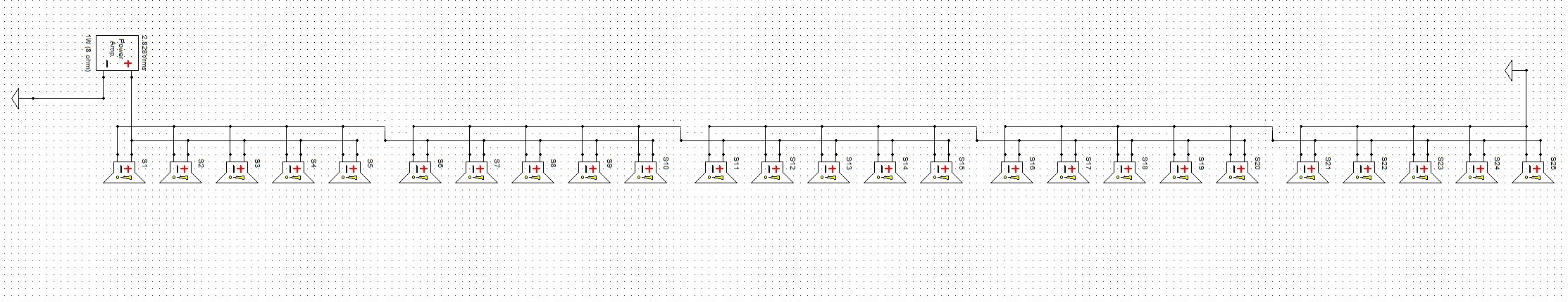

The wiring scheme I have used is series/parallel. The thin wire I bought for that was a highly flexible 1.5 mm2 OFC type wire with PVC coating. Basically specked as a quality speaker wire. It consisted of multiple thin strands of copper that made it flexible.
The longer runs were of the same type, just a bit thicker.
In hindsight I would not use that type of wire again. Nor the connection scheme. Parallel/series wiring has some advantages, mainly around the impedance peak of the drivers. I'd also use wire wit a lesser number of strands, which would make it more stiff, harder to handle, but does have advantages at higher frequencies.
I did some testing that should be documented somewhere in this thread on using long runs of speaker wire. Among those I used solid copper electrical wire as used inside my home for the power outlets and a limited strand count wire of the same (I believe 2.5 mm2) thickness. It showed an improvement at high frequencies compared to the flexible multistrand type wire, even after FIR filters were applied.
The schematic I'd use today is:
The wires I'd use in future projects would be something like ~ 7 strand 1.5 mm2 wire for the shorter runs and 2.5 mm2 for the longer runs with the same type of strands, just more of them.
The only reason not to go for complete solid wire is the hassle with the stiffness, making it hard to run it inside an enclosure and making sure it stays put when closing the array.

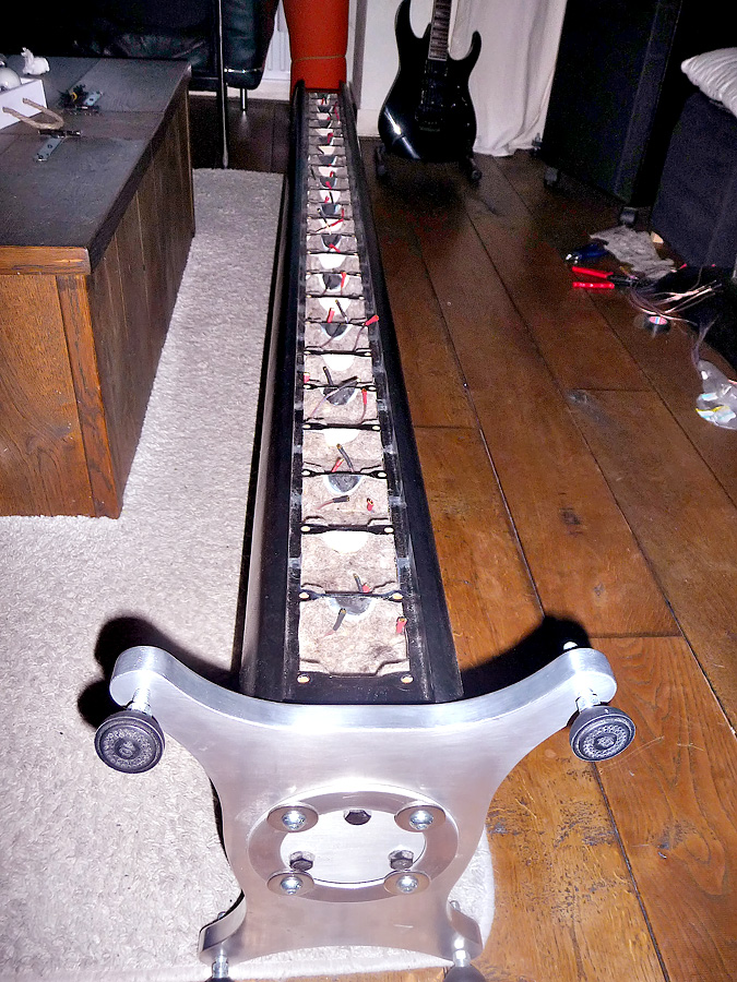

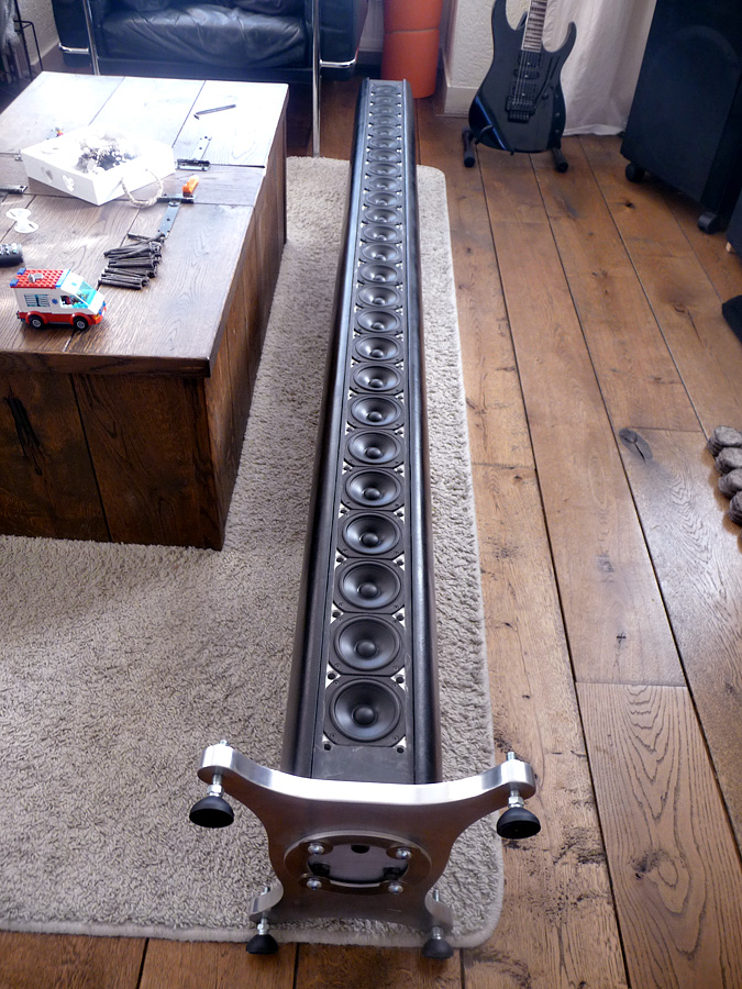

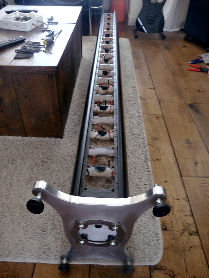

I could not take any pictures during the wire job as the wiring is indeed below the damping material and is being run trough holes in the braces. I put it in there part by part, soldering it as I went along.
I did take pictures, they just did not show anything particularly useful
Here are some I probably did not show before:
Closing up the array:
Here's another I found, showing the pre-cut short wires at the right side of the picture (this must have been the first array being wired up):
Taken at the end of a dark December day of wiring

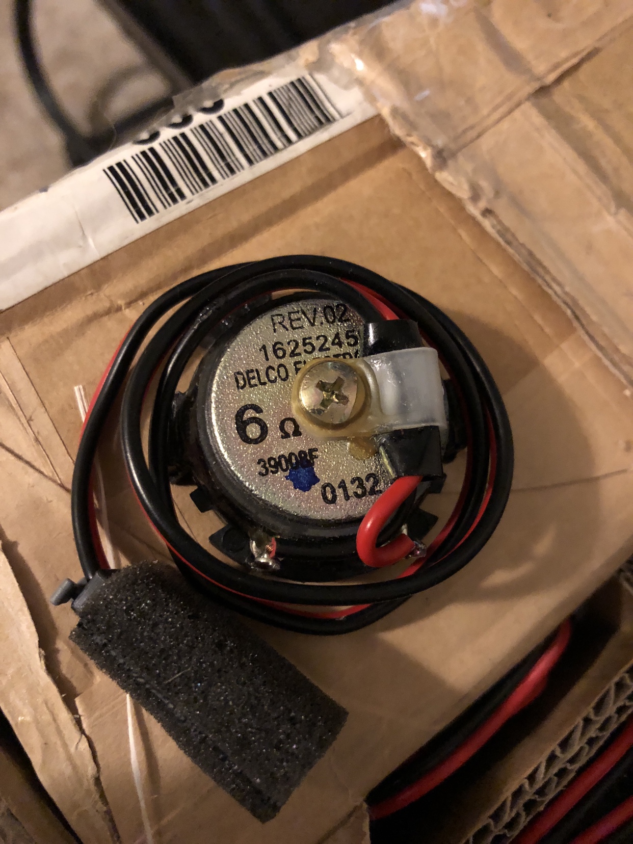

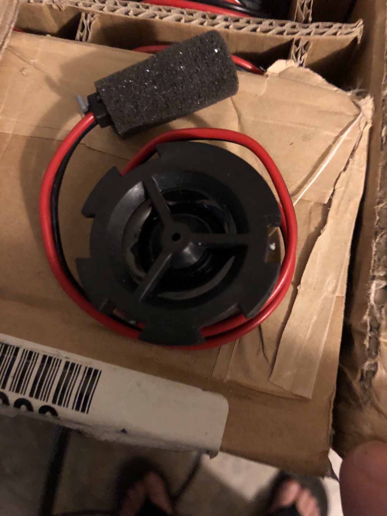

That’s a great build there. Let me know if you want some free tweeters if you need a little in the high end. They are those ones from Part Express when they had that 200 tweeters for a real cheap close out deal
Just pay for the shipping I think maybe 6 or 8 of each side would bring them up above the 4000k to 18,000k. They are yours if you want them
